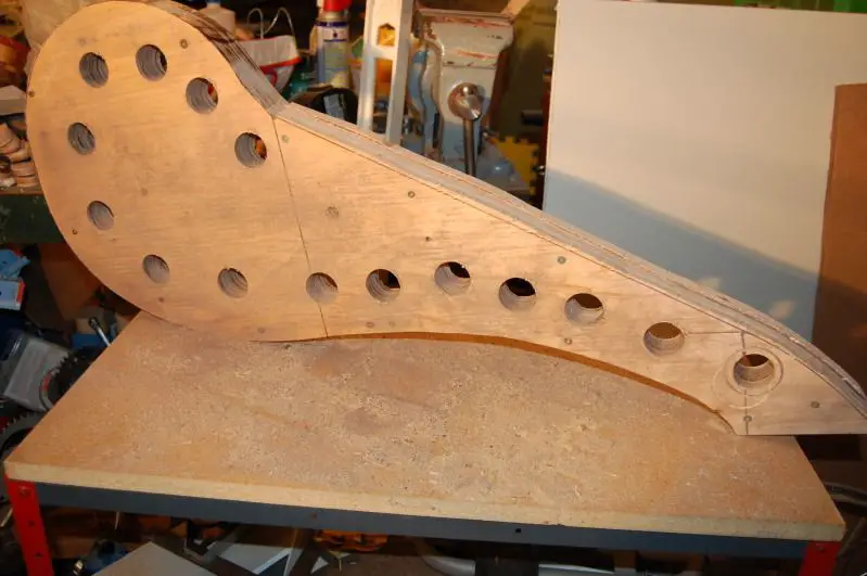

I got moving on the tricar the last few days. It looks as if we are going to have an early spring and the weather was dry and sort of warm for the past two days and the sun even came out so I got at it while it lasted.
I made a form to bend the leaves for the springs. These are more seat holders that look like springs than real springs themselves. The metal is 1-1/2 x 1/8 hot rolled steel. Not ideal but it had to be bent around the form and I am going to layered it in 3 or 4 layers to get the thickness that will work. There was enough steel to do 3 layers to start and I go up later in the week and get more. Another set is needed for Silverbears Hiawatha tricar if this set works.
I used three layers of 5/8 plywood that was left over from a job here at the house to make the form. Inch and a half holes were drilled to make pockets for the clamps to fit into to give them a place to grip while the metal was being force up against the form to shape it. A bunch of 12' sliding bar clamps from Harbour Freight were used to hold the metal in place. They are a great deal at $3.99 each and some of the best I've seen.
I posted some pictures on Photobucket and the link is below. If you look along the pictures past the springs you can see the wheels that are going on the front of the tricar with trike hubs that I got in England.
They were very reasonable in price and I'll post a link to the chap I got them from in the for sale section. Chainmaker put us on to them so I'll add to his thread. They were $50 a pair delivered.
I am going to drill holes in each spring and rosett weld each leaf to the first one. Mr. B suggested this over drilling holes and bolting them together A much better idea.
I'll post a link to photobucket shortly.

Hi Kirk,
Thank you. It was a nice vacation from building it but as you know it is never far from your thoughts so it's nice to put all that thinking into action, at long last. Also nice to have the garage about finished as well. Just the lighting left.
