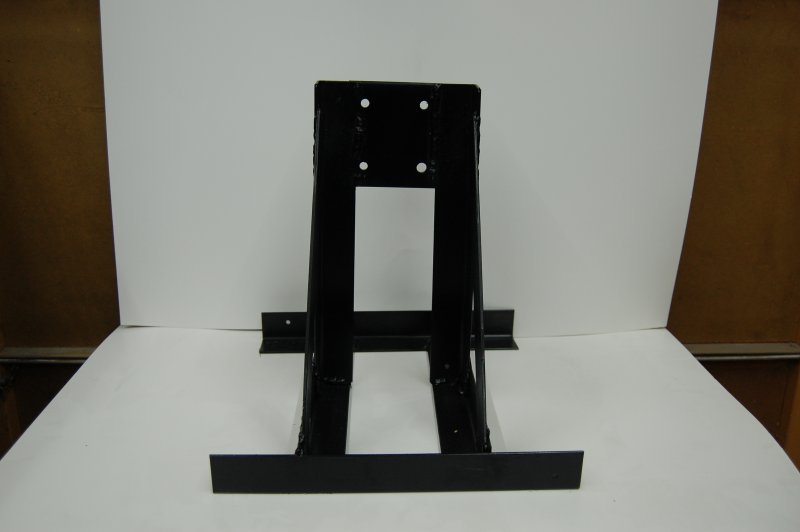

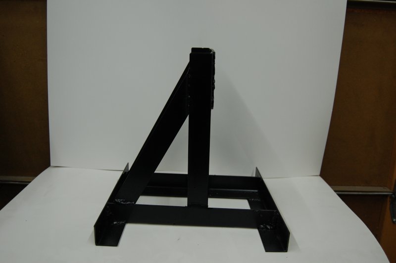

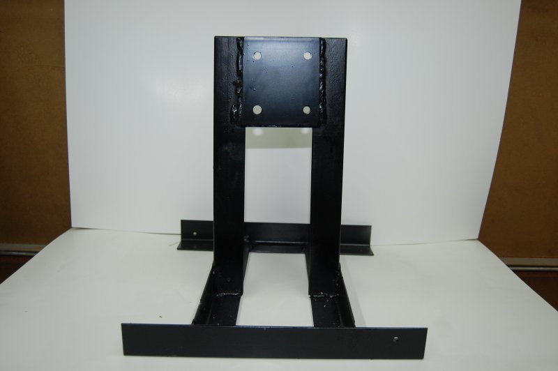

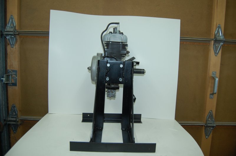

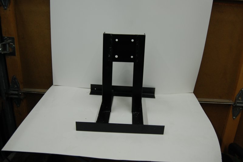

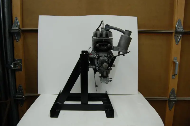

As I said in the Electric Bicycles, Trikes and Recumbent Bicycles section, Old age and arthritis have really taken a toll on this project. Now the hold up is insulating the garage doors and getting rid of the parts I'll never use and the clutter of boxes and bins. Garage has electric heat. There is 6" of insulation in the walls but the doors are not insulated.

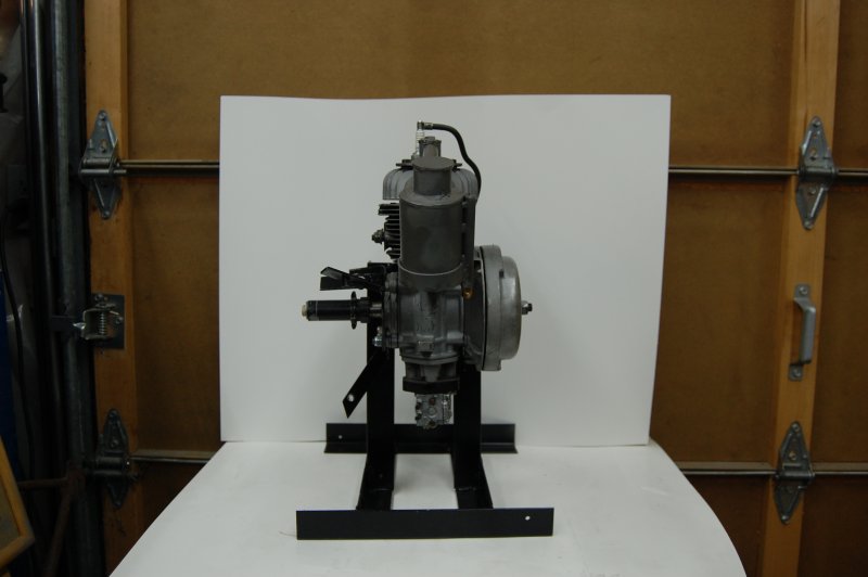

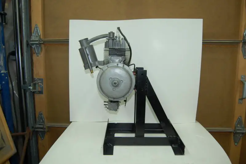

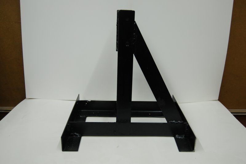

Insulation has been ordered and when it gets here it will be put in place. I have removed the engine from the Indian Tri Car and welded up an engine stand for it. It is to hard to work on in the bike. The carb was dodgy as per the seller so I purchased a rebuild kit and replaced what ever was there. If that doesn't help I'll purchase a new carb. There are a few available on eBay.
I'll post some photos below of the engine stand. Hopefully by Christmas it will be in and running but I'm not going to hold my breath either.
Steve.

Nice engine stand Steve. You insulating the garage door has put that project back up the priority list.
