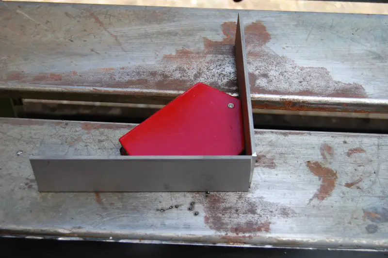

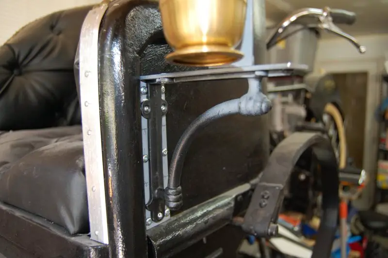

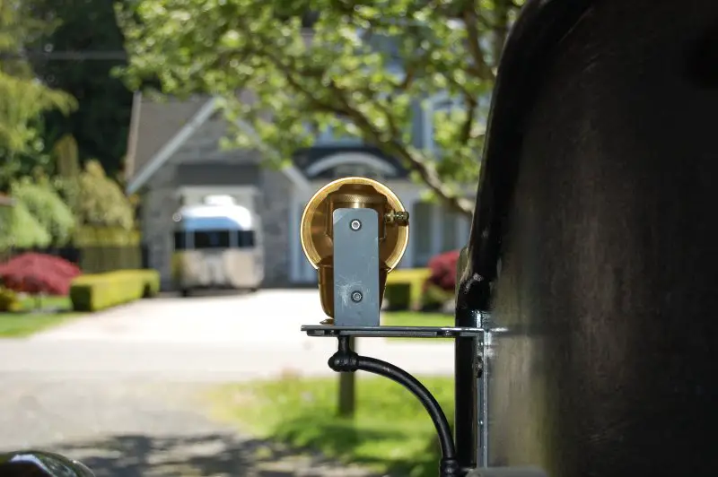

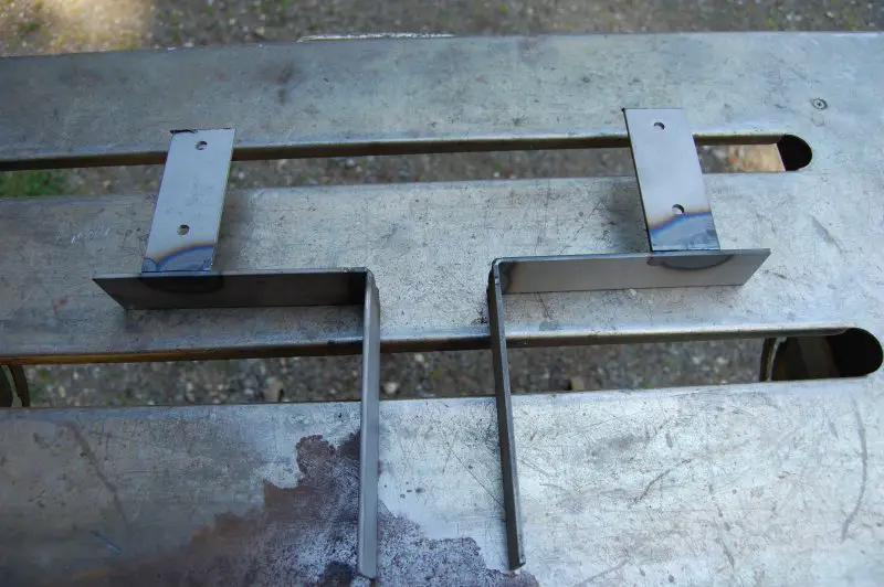

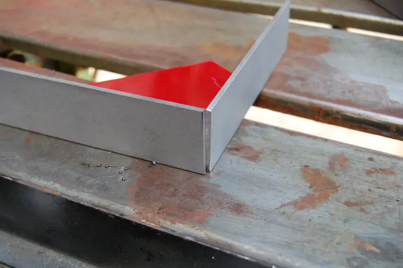

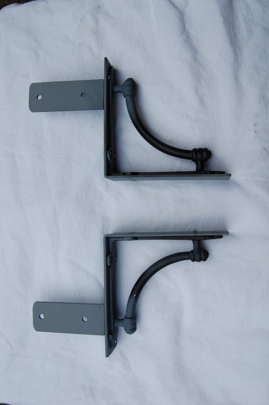

The headlight brackets are finished up. One set for the Epic and one set for the Indian Tri Car. I'll order another set of headlights soon. Working on the best way to attach them to seat of the Indian and the delivery box on the Epic. I think that I'll go with a piece of the 1-1/2" x 1/8" steel I used for the brackets screwed and epoxied to the wood then I can use riv nuts to bolt the brackets on.
I pop riveted the cast iron brackets to the headlight mounts I made using the screw holes in the cast iron brackets which are shelf brackets in another life. The metal sticking up with the two holes in it are where the brass lights will attach. For some reason the photo is sideways.
Steve.

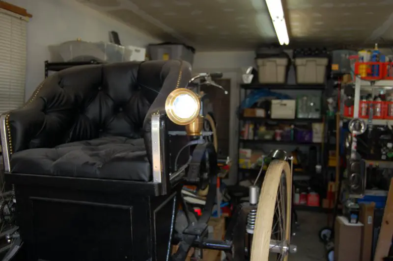

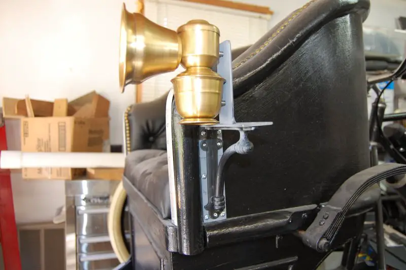

I posted this on the Epic thread and forgot to post it here.

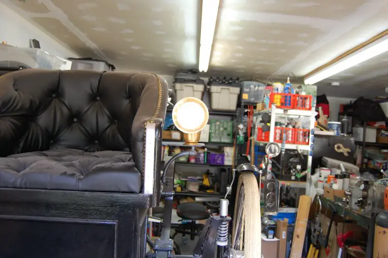

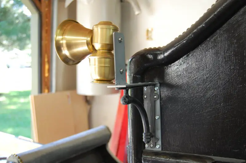

Mounted one of the headlight mounts on the Indian Tri Car and put the brass light on it to an idea how they will look. I have longer bolts for the lights and when the light is mounted permanently the bolts will run through some copper gas line to hold the light even to compensate for the shape of the light body.
I purchased the lights from Cool-one Bike Outdoor Store on Aliexpress. It's listed as Retro Bike Copper Light. They are brass. They have some nice brass tail lights as well. Make sure you are ordering either the head light or the tail light. I ordered what I thought were head lights and received tail light and kept them but had to order the head lights. They charged me for tail lights. They use 18650 cells for power. I purchased an inexpensive batter charger to charge them. Batteries were included.
They have cheap switches to turn them on and off. I bought some brass lamp switches and drilled out the holes. The switches roll on and off.
The brackets are on Amazon. They are cast iron shelf brackets. If you doing this there are a lot of choices of brackets. The legs on the brackets are 5".
