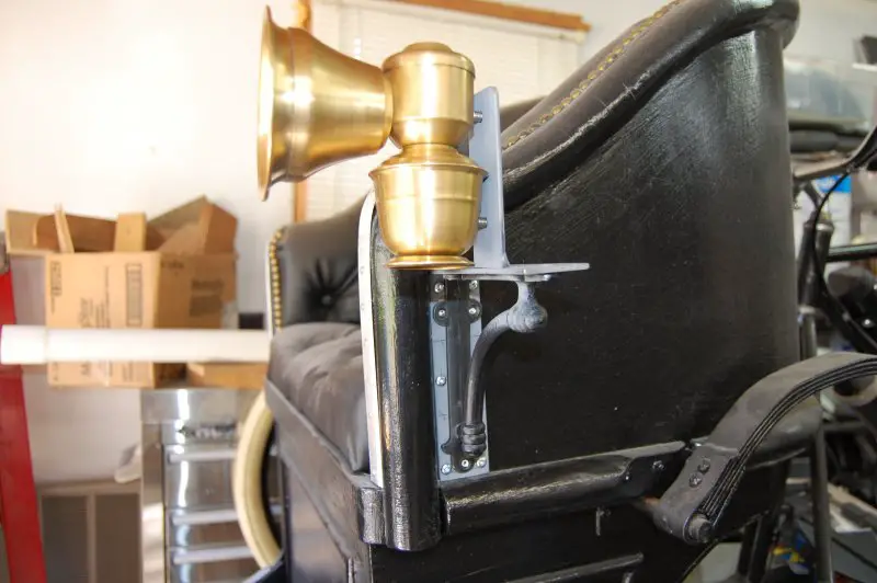

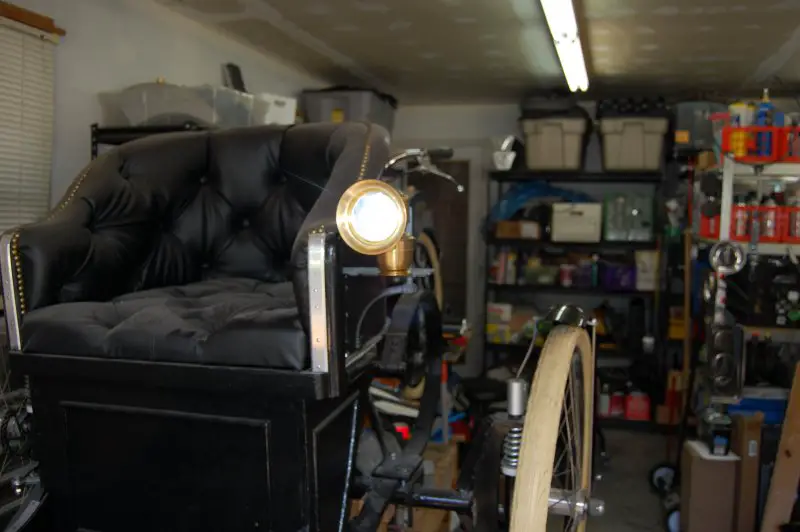

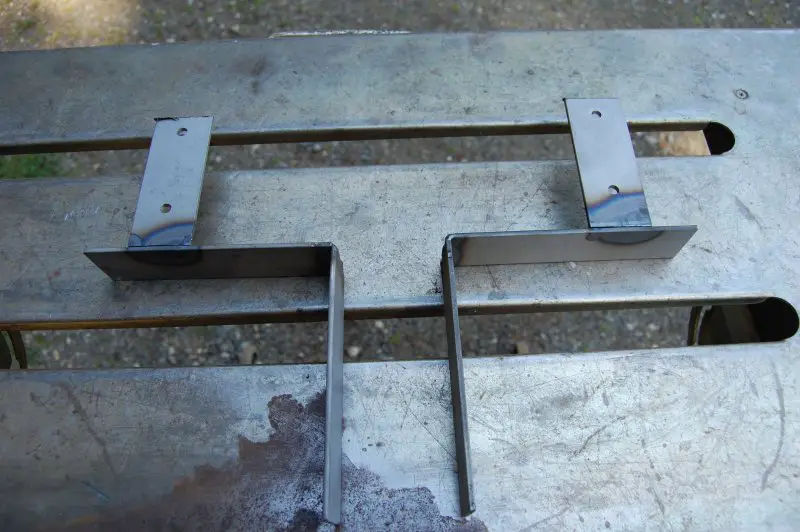

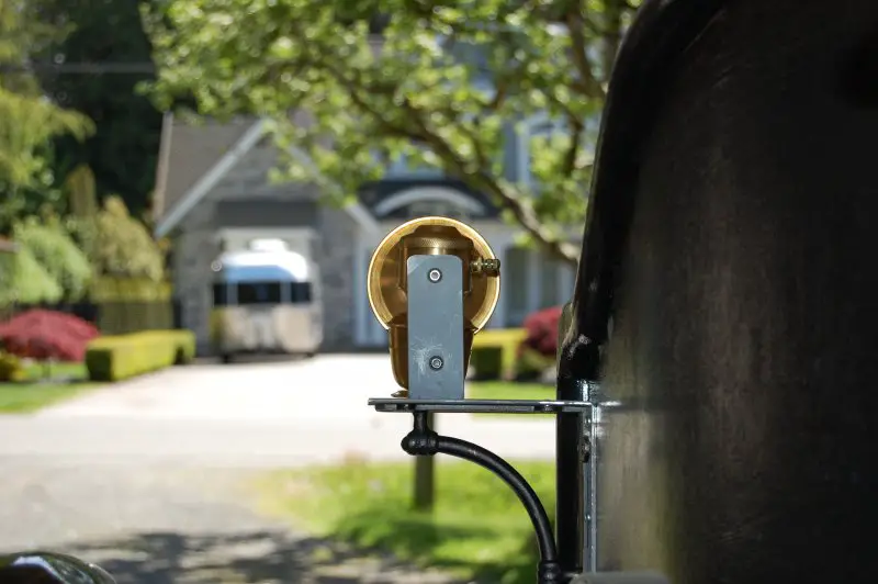

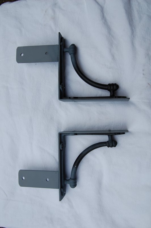

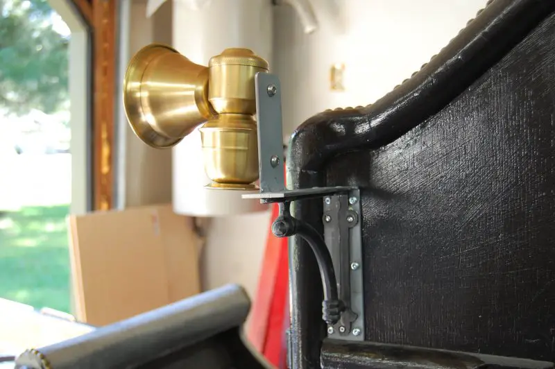

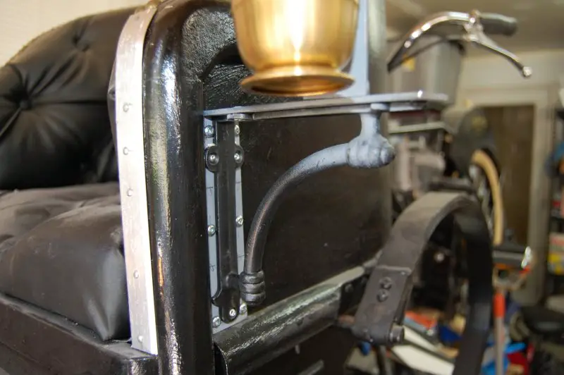

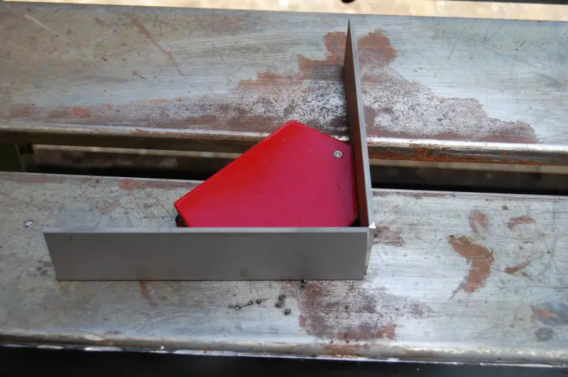

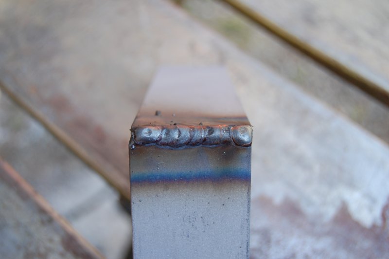

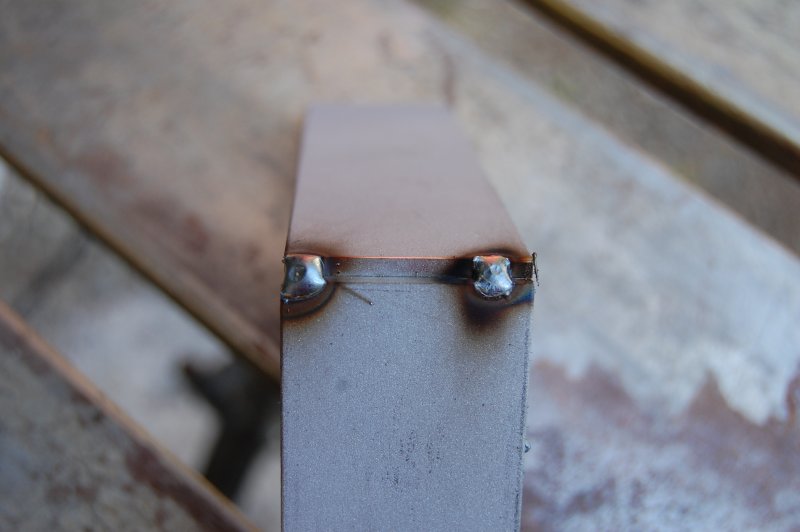

I posted this on the Epic Electric Tri Car thread first. I'm making two sets of these brackets for the headlights. One for the Indian Tri Car and another set for the Epic. Here are the photos of the brackets being built. The black part of the bracket is one of four shelf brackets I purchased from a seller on Amazon.
I added 1-1/2"x1/8" strap steel to the top and side to give a better mounting area. Riveted the steel to the shelf bracket through the holes to mount the shelf bracket to the wall.

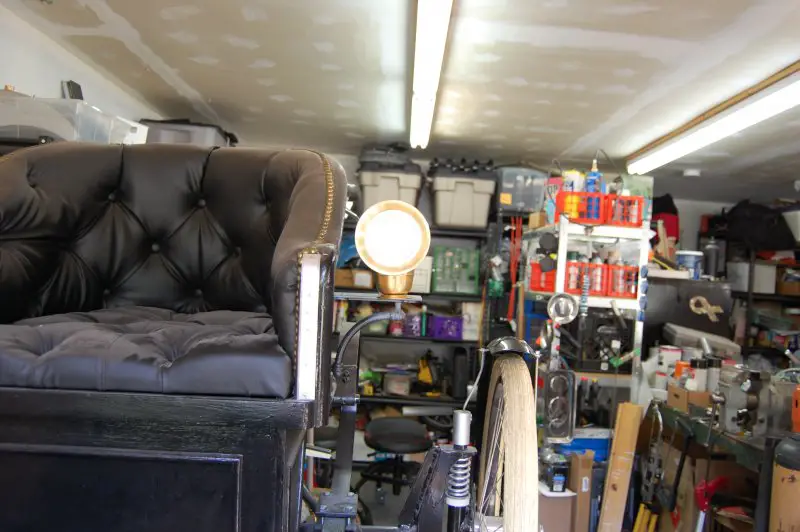

Thank you. The lights look good on the tri car. Once again, Thank you, Pete for the tip on where to get them. Just fill in work until we get a break in the weather and I can get into more work on the Epic. Hope to get out to the paint supply, metal supply and the plywood supply, Wednesday.
Paint and body supply is about a 1/4 mile from the metal warehouse and then it's a stop in for the plywood for the Epic's delivery box on the way home.
