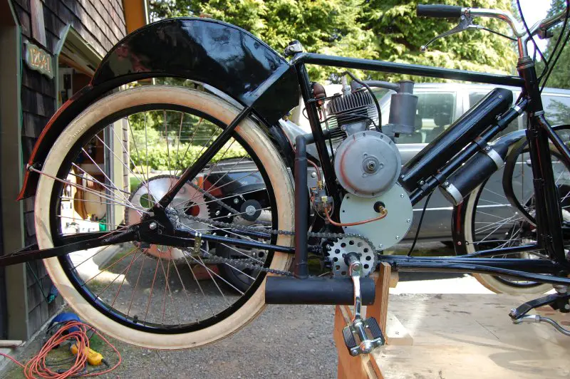

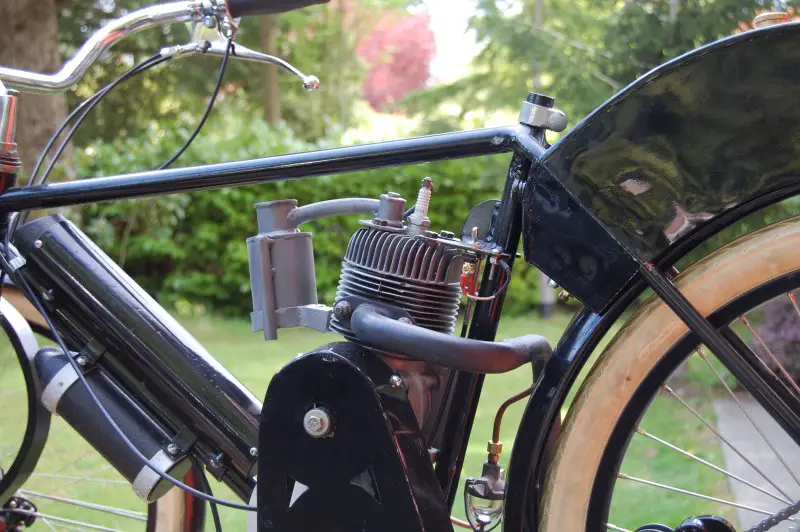

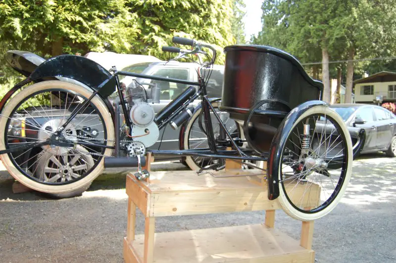

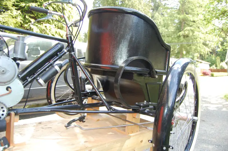

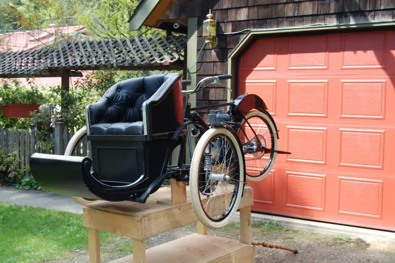

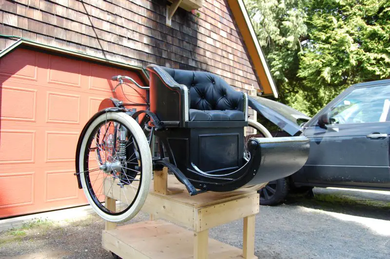

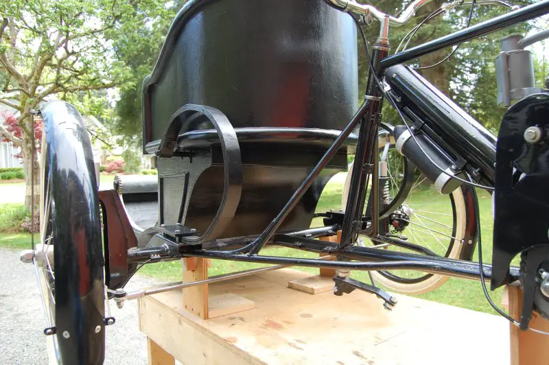

Neither the Tri Car nor I are dead. Usual weather and health problems. Too cold to work outside where where most of the prep work needs to be done before I bring it inside to finish it. If you have been stopping by to see if there is anything new, Thank you. I'll post some photos since any that were up have long been left behind. The engine is now out of the bike with carb problems and I have rebuilt the carb but it will have to wait until the weather warms up to try starting it.

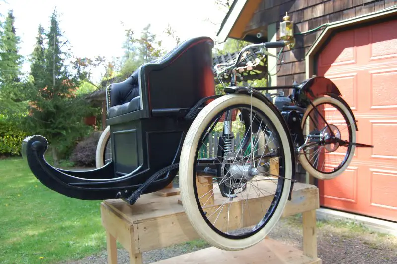

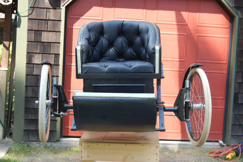

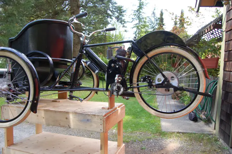

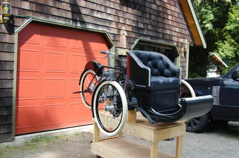

I built everything but the bike frame and the engine, The engine is from a Jacobsen Sno-burst/John Deere 320 snow thrower. Ninety eight cc's. Wheels an spokes are Workman Cycles with the front hubs custom made by a company now out of business. Fenders are generic beach cruiser. If you have any questions please send me a PM which is the envelope at the top of the page next to my name.
