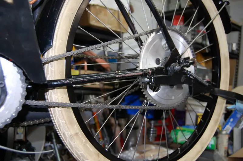

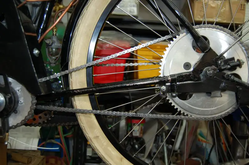

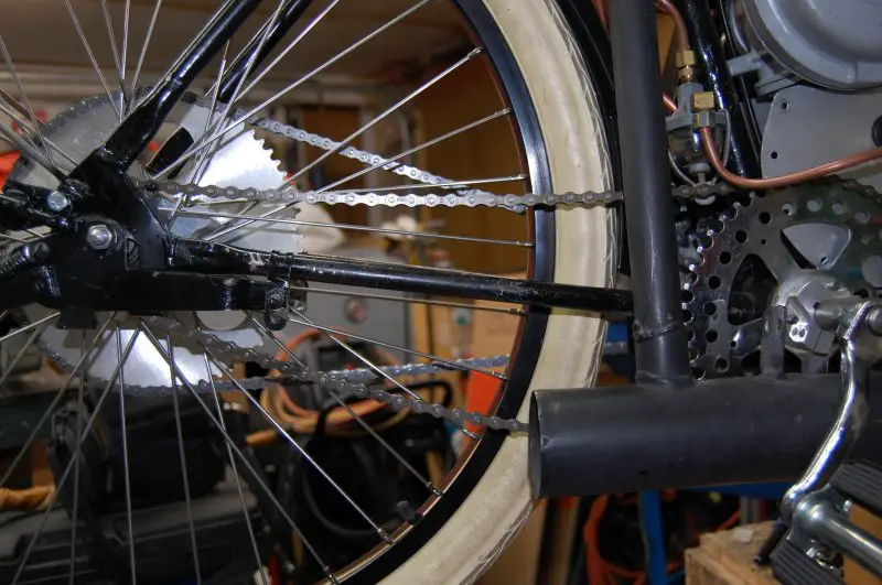

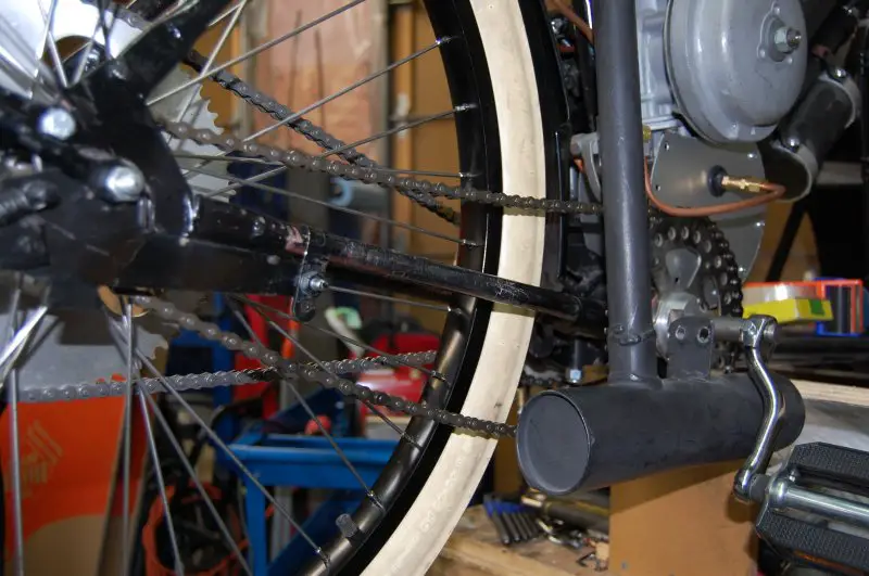

Spent a few hours over the past couple of days working some more on the bike. Managed to get rid of both the chain tensioners. Took two links out of the drive chain and one out of the pedal chain which left the axle right at the beginning of the opening for the axle. Just far enough in to be safe with the rear wheel adjusters so it won't pull forward for any reason.
Drive chain is just the right tension and the pedal chain is slack but all it needs to do is operate the rear brake and keep the tri car legal. The old fella doesn't pedal anywhere for any reason anymore.
Removed the exhaust brace when I put a larger sprocket on for the pedal chain. Looked at it today and I'll have to come up with something else tomorrow. Being a really high revving two stroke motor it should have something to brace the muffler against the vibration.
Still trying to work out a way to get a clutch lever lock on it. The lever doesn't lend it's self to an easy install. Another brain drain for tomorrow as well.
