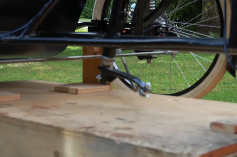

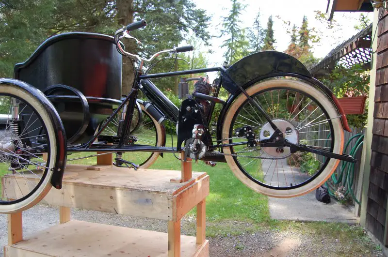

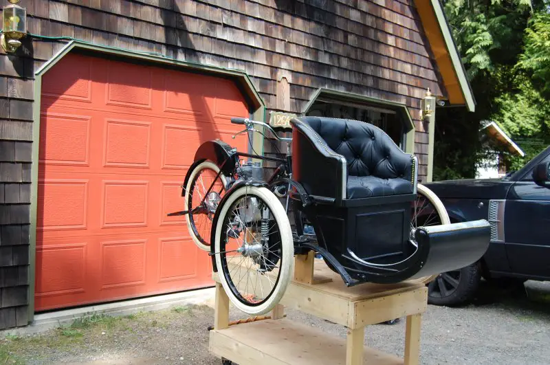

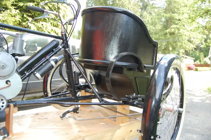

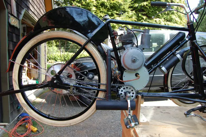

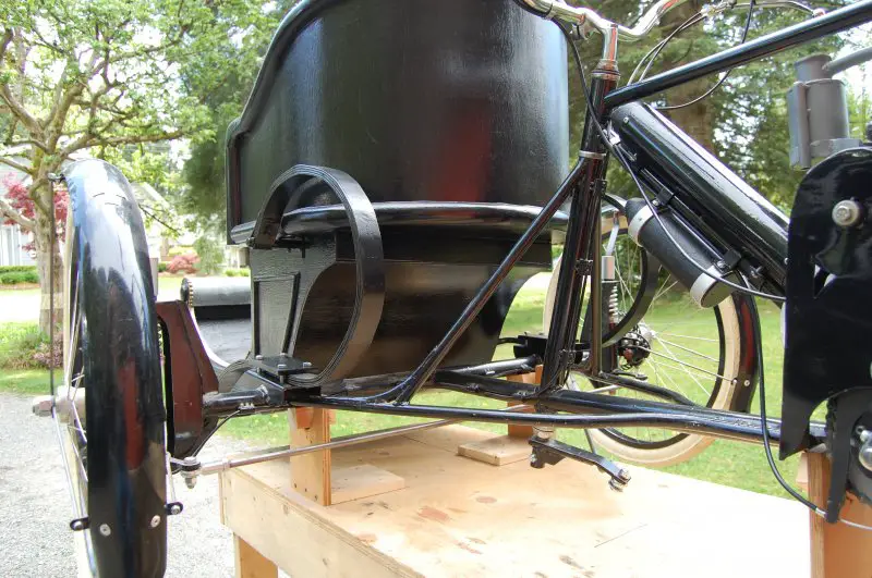

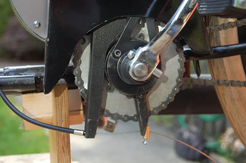

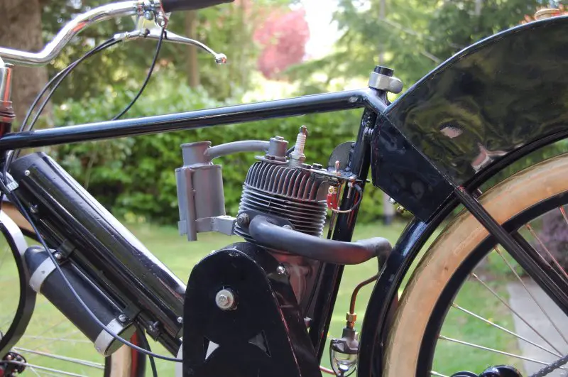

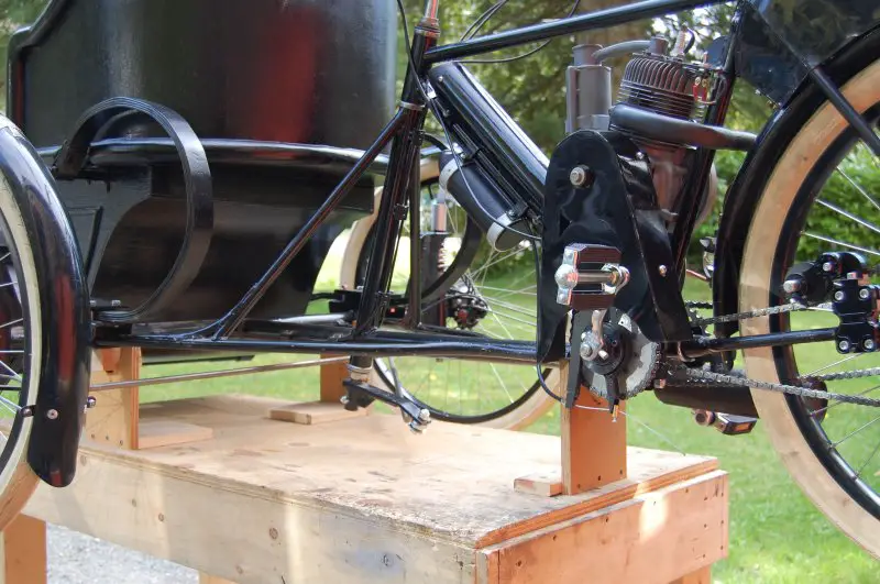

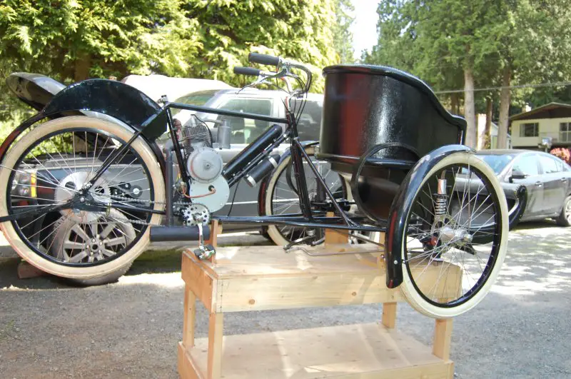

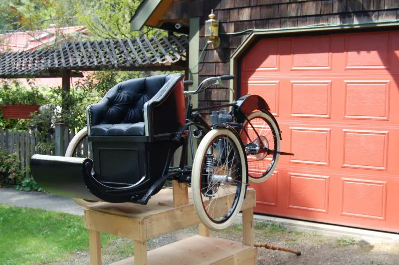

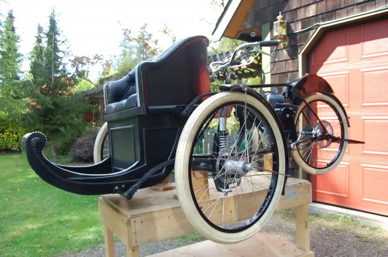

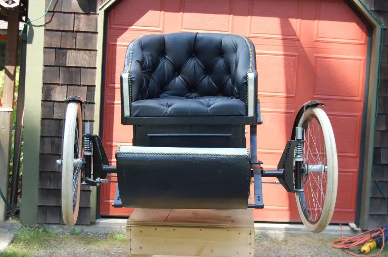

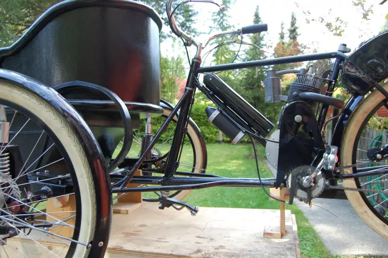

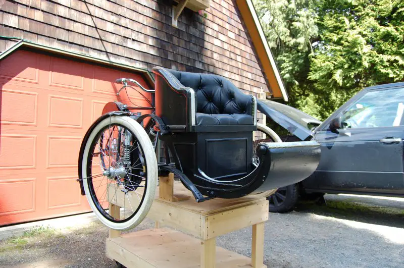

Here is the Tri Car as it sits. I'm wondering how it would look with the auxiliary seat added on the back.
Steve

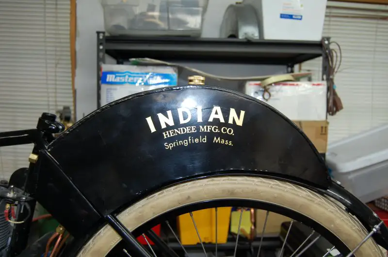

Always one more photo than allowed. These photos were taken last summer so the gas tank has been changed for the new one and the lettering is on it. I'll get some photos of the new tank with the lettering and compare this tank to the new one.
Small difference but noticeable when they are together.
Steve.

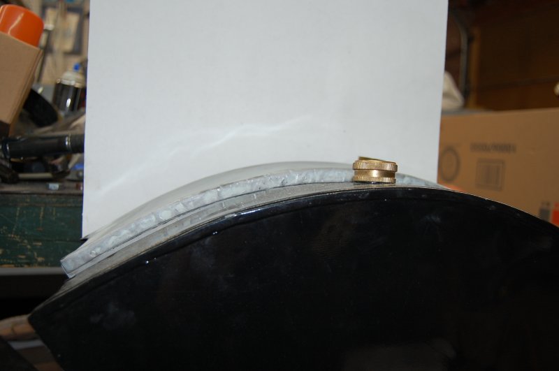

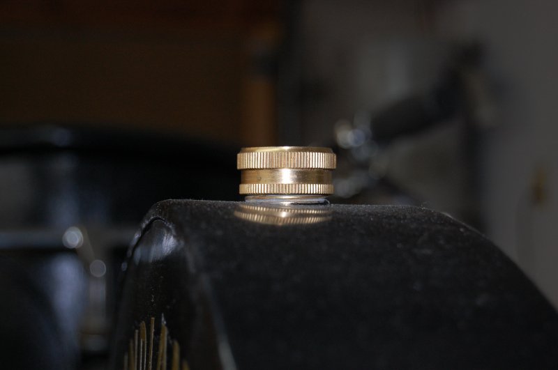

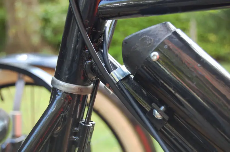

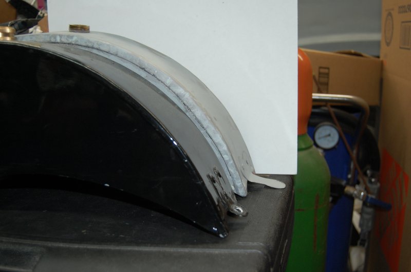

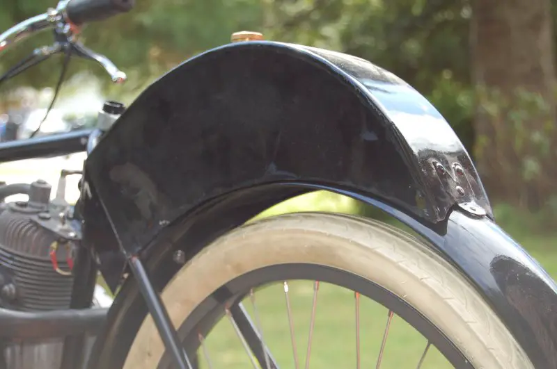

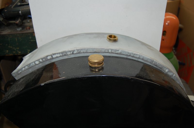

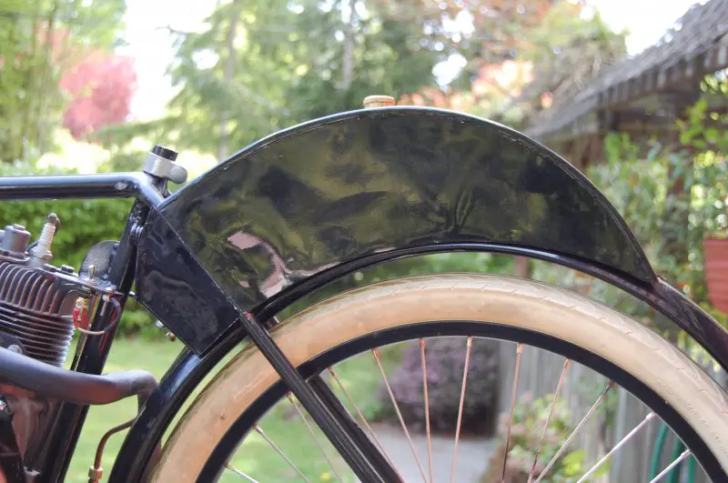

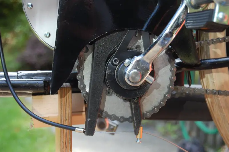

I did get a few photos of the changes in the gas tank. I make three at a time just to use up the tank liner. Made them slightly taller on the sides where it meets the bike frame and lowered the bottom of the tank 5/8" to improve the lines where the tank meets the fender. Lowered the fender 3/4" to make the fender to tire gap closer.
I mover the filler cap further back in the new tanks and added a longer mounting tad where the back of the tank meets the fender.
The tank cap and the gas filler neck are Home Depot items found in the plumbing section. The filler neck is a pipe reducer bushing. I smoothed the inside threads off. The cap is a cap used to close off garden hoses when they are not in use so nothing can get inside them.
That's part of why the build has taken so long. I can't leave well enough alone. It's done and if it does warm up I cut some metal to make the lever to hold the clutch lever open and it just a wait until we get a decent sunny day to get it outside to run it.
Steve.
