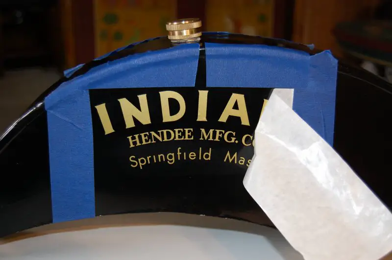

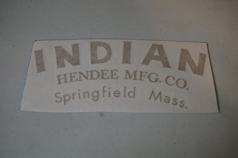

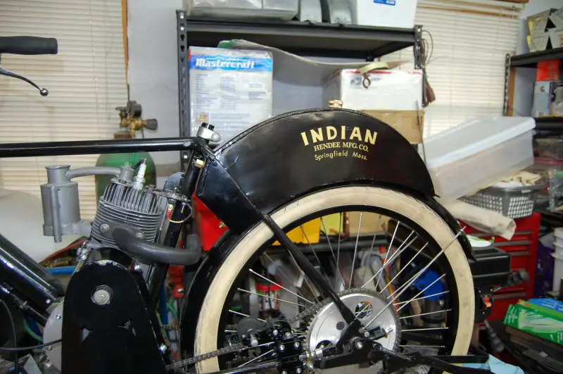

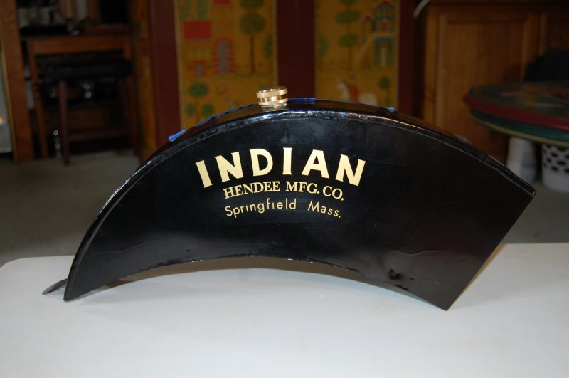

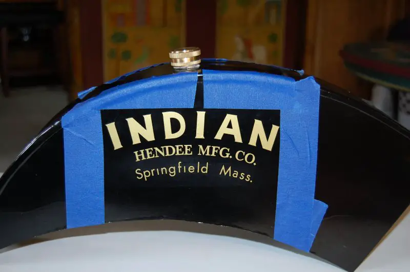

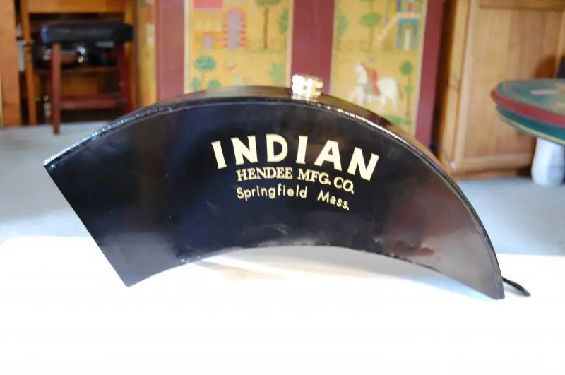

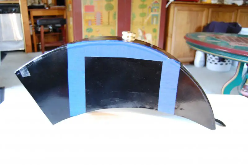

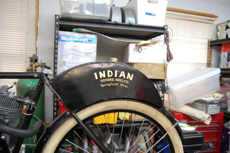

Last of the "Big" to do's has be done. Lettering is on the gas tank. These are vinyl lettering, not water transfers.
I purchased them from Classic Transfers in the U.K. They have an extensive collection of motorcycle logos from around the world. The cost is 5.75 Pounds-$7.40 U.S.- $9.69 Canadian each + shipping. Lots of Indian logos.

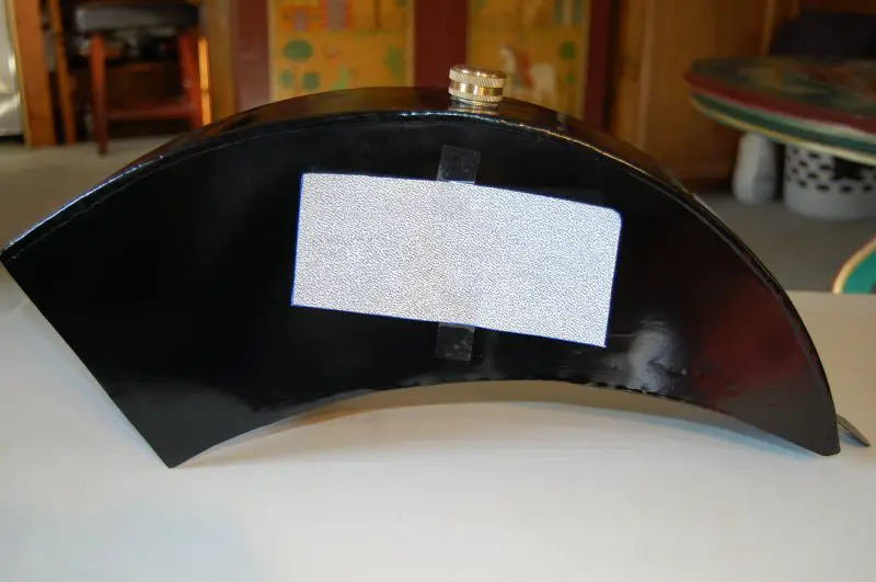

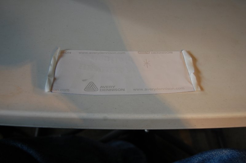

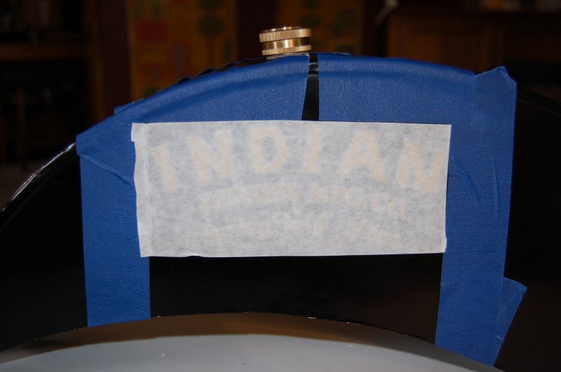

I taped a piece of paper the same size as the cardboard with the letters to the side of the tank to make sure it was level and centred compared to the original bikes. Then I used masking tape to mark the area to show the boundary's. There are a tab of the paper with the letters on it wrapped around the back of the backing cardboard on either side. I freed these up and started peeling the decal off the backing cardboard. I found starting in one corner and peeling the lettering up slowly worked, checking to make sure the letters weren't being left behind.
Then I lined them up to the masking tape and started at one end rubbed then onto the tank while holding up one side so the letters didn't make contact with the tank all at once. Peel the paper off and the job is done.
Steve.

Success. Now down to the garage to see how it looks. Lots of paint touch up needed. The chain hasn't shown up yet. One of the reasons I rarely use eBay any more. They sent a link so I could follow the package that doesn't work as usual.

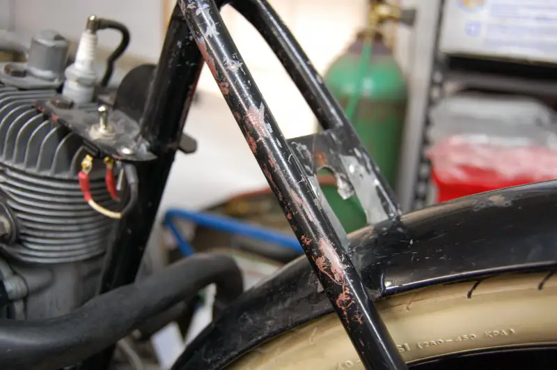

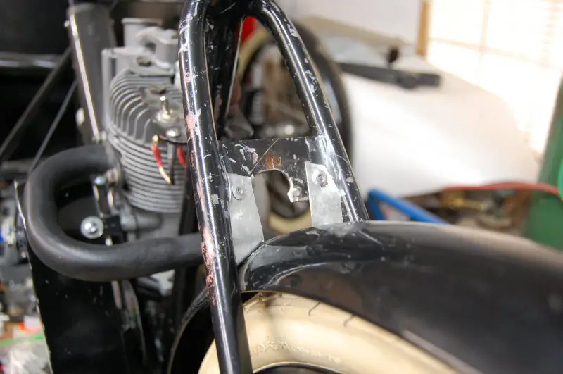

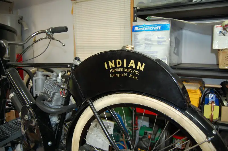

Put the tank on the bike to get some photos and then removed it so the scratched paint on the frame could be repainted. If I had a dollar for every time the different gas tanks I built were removed and replaced I'd be in a lot more solid financial shape.
The frame is now scuffed and taped off where it was scratched and tomorrow I'll paint it so that when the chain gets here I can give it a try.
