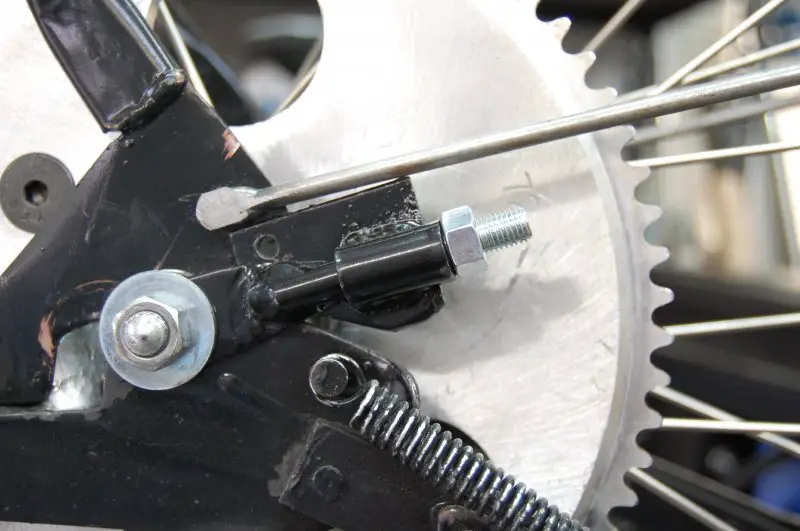

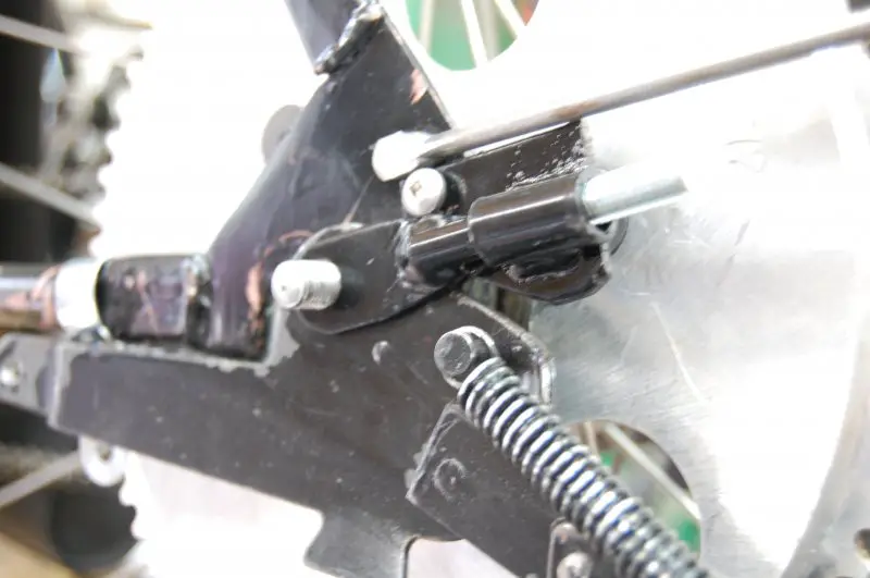

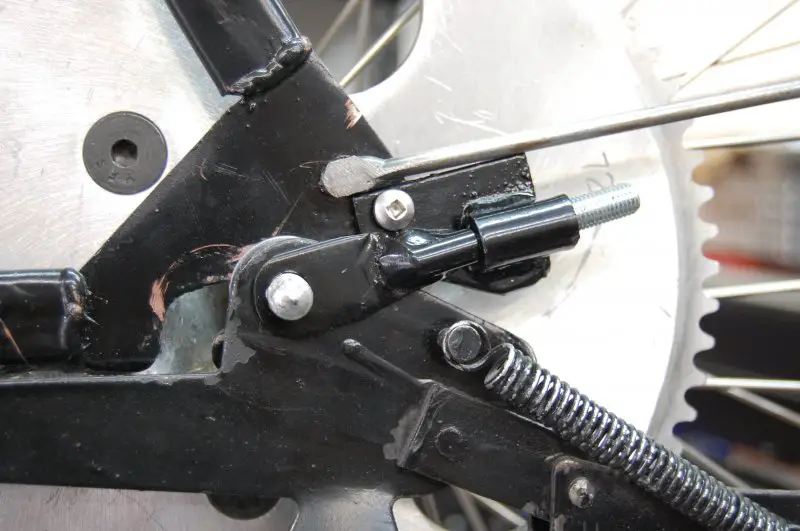

Thank you. Didn't get them installed today. The paint was still soft so I'll get them on the bike tomorrow and shorten up the chains some more. I thought I had it aced but evidently not.

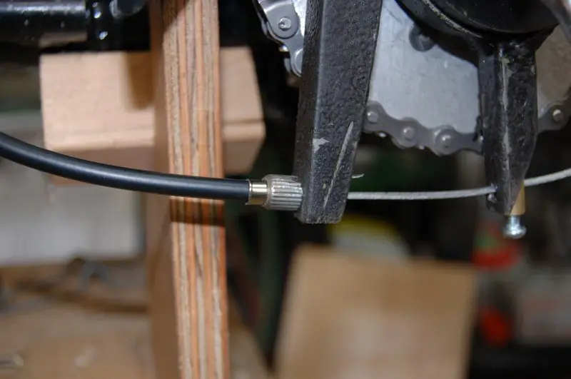

Have one side done. Spent time trying to see if I could make the clutch cable better but just spent a lot of time and received nothing for it. I did get a cable adjuster installed so the clutch cable had a place to end up. It was just floating around on the cable stop and didn't look finished.
I'll get the other adjuster on tomorrow and then get the tensioner back on the drive chain. I may need to get one for the pedal chain as well. As Rick said no half links so if I can't get the slack out of the chain I'll get a second tensioner.

This build has been in a state of constant evolution since I started building it and now it's time for the pay up for not staying with the original plan. Also evident things become even more evident as I go along.

I'll paint them up and install them tomorrow and once I have the chains set up properly that should be it.

I like the adjusters & how you designed around the drop plate issue. Rear stands are tried and true, but I've avoided their use to this point in an attempt to keep the axle plates free of extras, but the well designed stands are absolutely wonderful especially for roadside wheel removal both front and rear. Stationary startups as you are well aware of are another reason for the rear stand and they are after all vintage!

Thank you. I was pleased with the adjusters too. The rear stand is just for the starting ability. With the three wheels the stand isn't necessary other than for that. I'll be using a drill to start it since my pedaling days have long gone by.
