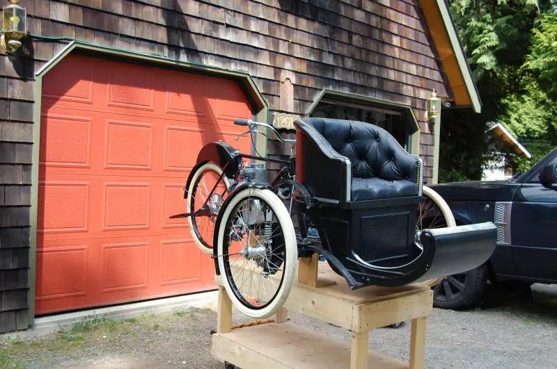

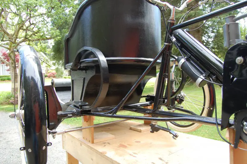

Thank you Rick. I tried to stay as close to the original as possible. When they published the photos for the Meacum Auction I finally was able to get a close up of just what a real one looked like.
Every other photo I had seen was either from the side or taken twenty feet away so many of the fine details were mostly guess work on my part. When I did get a close up of a real one I was pleasantly surprised how close I was and I made adjustments or rebuilt what wasn't right like the gas tank.
Back at it tomorrow to finish some things that aren't right and add some others. I really want to see what it looks like on the ground.

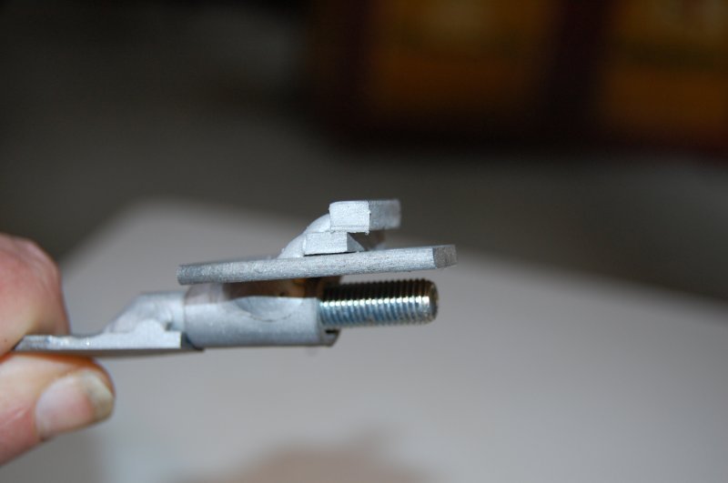

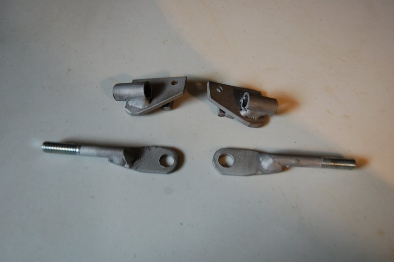

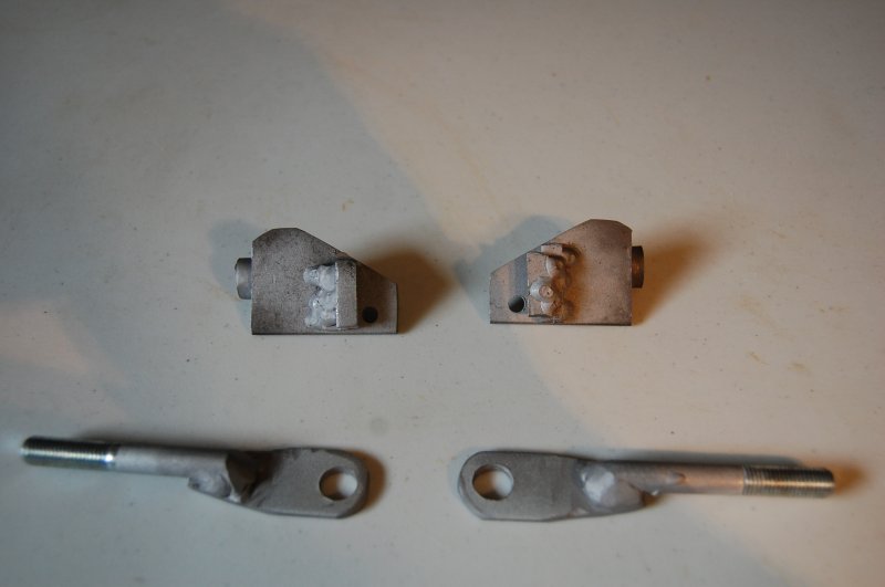

Spent the afternoon trying to figure out something cunning to work as chain adjusters. Keep wondering why they cut the axle slots from the front to the back on an angle instead of flat and cut in from the back. There are lots of adjusters for that style.
Steve.
Steve these types of drops were designed as a safety feature to prevent the loss of the rear wheel if the axle nuts loosened. It also is intended to simplify adjustment for the rear wheel, all the way seated is adjusted and true, much the same concept as the forks drops function, firmly seated is true and no adjustment is necessary in a well machined fork or frame drops. The design was intended for and is still used in multispeed bikes where a wide range of chain length is necessary for multiple size cog function. The problem with this style of drop is when manufacturers used the same frame drop design (safety feature) for single speed (fixie or coaster) style bikes where no allowance is made for chain adjustment with wheel movement and therefore your problem. Half links I hate, so I now always use a tensioner. In the past I've also welded a small section of tube to the drop plates and used a washer & threaded rod to adjust the axle on both sides. Most drop plates aren't large enough to allow this without welding an extension to the plate to allow the adjustors to work. So I built larger plates to allow adjustment.
I personally allow this style drop to function as designed as a one position axle locator and run an idler, spring loaded is my favored option. Some really dislike the look of tensioners or fear them, but built right and properly installed they work great and have been used with both belt and chain for much longer than motors have even existed.
Of course a new pair of drop plates can be cut in the horizontal style and traditional adjusters employed.
Rick C.
Thanks Rick. Makes perfect sense having spit a few wheels out the back of the old CCM's when I was a kid. I have an idler on the bike and wouldn't be without one now they have them available.
I would have made new drop plates if I'd been a more savvy bike builder but now it's go back and try and get out of the jamb as best as I can. just about have the problem solved but have to work around the rear jack stand.

Took a while to come up with something I was happy with. Forgot the camera so I'll take some photos tomorrow but nothing out of the ordinary happened. Scrap bucket is a little richer for the effort and some of the neighbours didn't want to share the frustration so their closed their windows.
Hope this is the last " Have to go back and straighten it out."
Steve.

I'll paint them up and install them tomorrow and once I have the chains set up properly that should be it.
Steve.

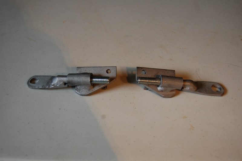

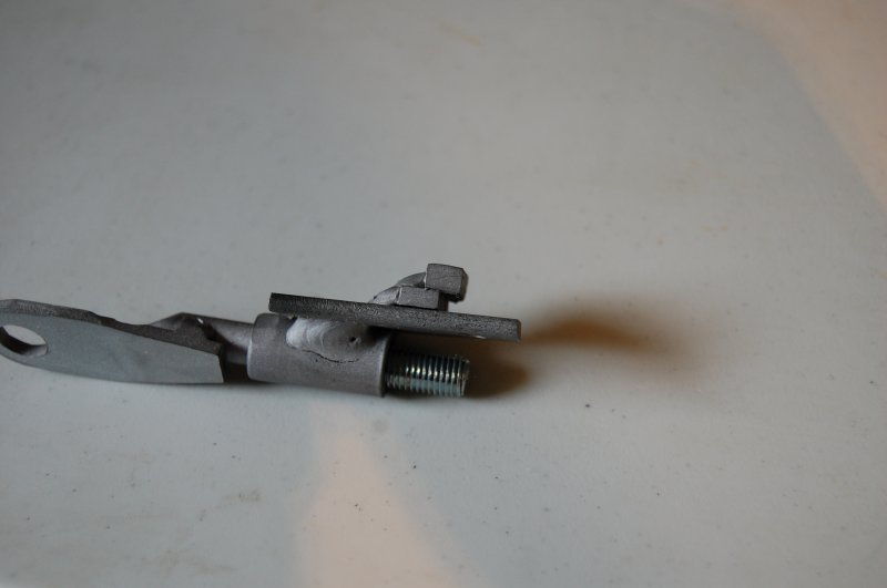

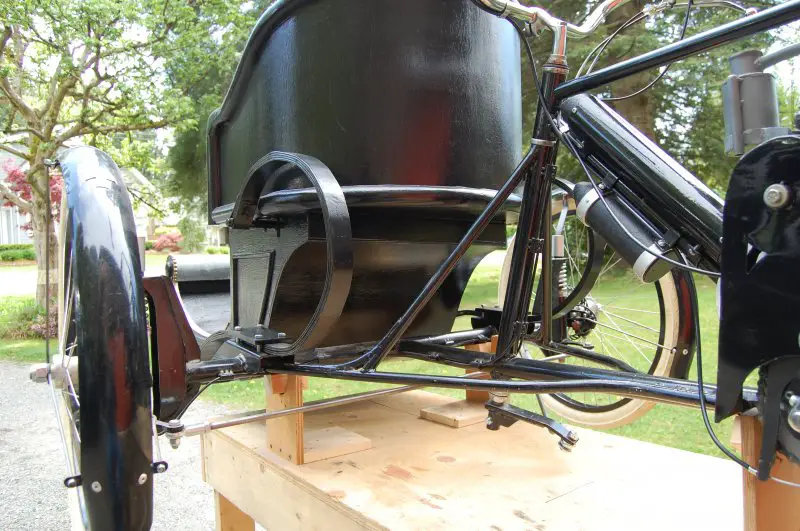

I made a pair of chain adjusters for the rear wheel. The small hole will accommodate a bolt that will hold it to the drop plate. The tabs on the back will prevent it from moving or slipping off the drop plate as it's tightened. Once they are on the bike I'll take some photo's of them and that should be the final part of the puzzle.
Due to having the rear jack stand on the bike I made the adjusters to fit on the outside of everything since the jack stand anchor points were in the way.
