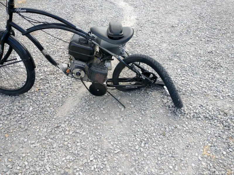

This is what I'm working with, space wise I won't be able to mount it "the right way" without chopping the frame and bracing the engine from the gas tank mount.

You can try a search, someone around here made a reverse jackshaft, not sure who it was though.

Just mount the engine with the cylinder vertical. I have around 500hrs on my bottom end like this no problems. Run 19oz oil.
