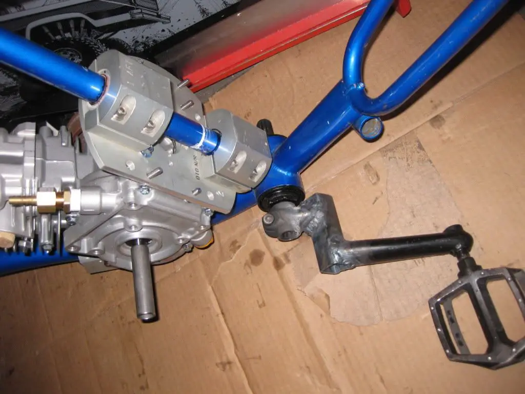

Thinking real hard about mounting my 79cc Greyhound engine vertically. Have the mounts, fabbed up a plywood plate, etc. But I am stuck on drilling and tapping the second oil filler hole. I have seen others use what appears to be a brass hose barb looking thing- are those 3/4" MHT threads?
Since I'm not a thread guru, I could use some direction on what fitting(s) to get and what type tap to get.

This is what I used hope this helps you out. The brass fittings should be in the garden section.

Thanks for your parts info. So based on the tap shown, your threads are 1/2". On my engine, that recess in the molded boss appears to be more like 3/4" inside diameter. Did you only tap the bottom of the recess, or the side walls?

It's 1/2" pipe thread, use fittings that accommodate.
I use mine for a crank case breather and the oil filler as well. It works very well and is simple to use.
OK, so at Home Depot I found two garden hose adapters in the plumbing dept. Both are listed as "3/4" MHT (male hose thread) on one end. But on the other end, one is "1/2 NPT" and one is "3/4 in MIP- tapped 1/2 in FIP". I bought both (sorry for the crappy pic of the one). Also bought a cap.
I'm assuming FIP means female threads...so probably going to take that one back.
alright, I think I am in business! Thanks guys for the assistance. Of course I still need to do the work, but at least I have the parts.
