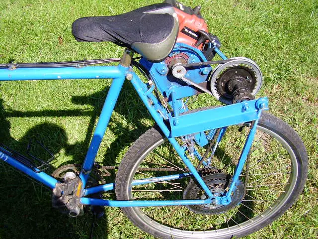

Looks like your Chernobyl bike just needs a tensioner. I had the same problem with my set up at first. I found a couple teeth just a tad bent and the chain had a couple stiff links. Once that was fixed, I eliminated the tensioner altogether and used turnbuckles to keep the chain tight. But the tensioner was nice because there was less friction, I may go back to it. Check out the pic....

I like your set up....the engine is centered and you used the drive chain instead of the belt. (my set up is direct to the drive shaft so the belt is also the clutch) Is that hub used as a freewheel hub or just a paired gear set? Can your set up freewheel?

Hi Ron,
Thank you for your interest in my bike.
Yes, the gear on the rear wheel is turning the gear on the jack shaft/hub all the time. Engine on or off. So there is some drag but not a lot. Just as easy to pedal as it was before adding the set up to the bike. But since the bicycle hub doubles as a jack shaft and as a freewheel gear, the pulley welded to the spoke end doesn't turn unless the engine is turning it.
I have a pull rope to start it from the saddle. No way to pop start it like it is currently set up. Luckily it starts first pull almost every time. I just have to start it up and hold the clutch until I'm going about 8-10 mph then let the clutch out. Or start it while moving from the saddle.
I may switch to centrifugal clutch and use a chain to drive the 3 speed hub I'm putting in place of this one. (If I ever find one) With a little larger gear to replace the pulley on the spoke side of the hub, I will get a nice mix of gears.
Also I'm considering welding the aforementioned gear closer to the gear driving the rear wheel, instead of on the other side of the hub allowing me to move the engine closer to the center line of the bike, an Idea I got from Revelstone, another member of this forum.
This will be the 4th reincarnation but constantly improving the end result so far. It runs great but I have been worrying about the tension on the crankshaft from the belt drive so this is a needed upgrade.
Hope this answers your questions. Scott

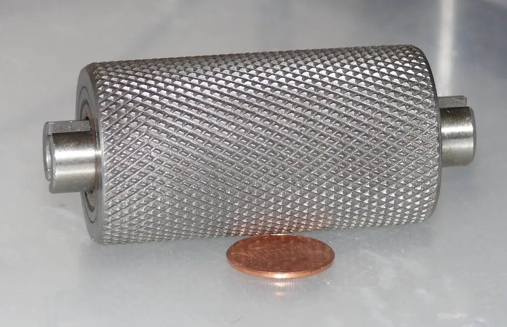

(p)Hello all! This is my first posting but I've been following the thread for a few weeks. I've just built my first bike (friction) and I'm addicted. I've got 2 bikes waiting for the conversion when I can find engines. My hobby has been metal working for a number of years. I've got 2 small lathes, a mill, drill press, and a lot of other tools that fit this new hobby perfect.
My reason for posting... I've noticed past discussion about "rollers", some of the ideas were GREAT!!! I did come upon a source for new rollers with a built in clutch that seem a perfect fit. I bought one and am going to try it on my next bike. The rollers were in a surplus sales store in San Diego for about $6 dollars. I am NOT connected to this store in any way only trying to pay back some of what I've learned here.
Web site: evwarrior
Hope that this helps someone?
Regards,
Al

I think I bought one of these on ebay. I had it welded to the sprocket on an electric motor. It worked very well so does the textured peg of a bmx bike if you can make fit. I am using one of those now on my 25cc engine on a bike.
