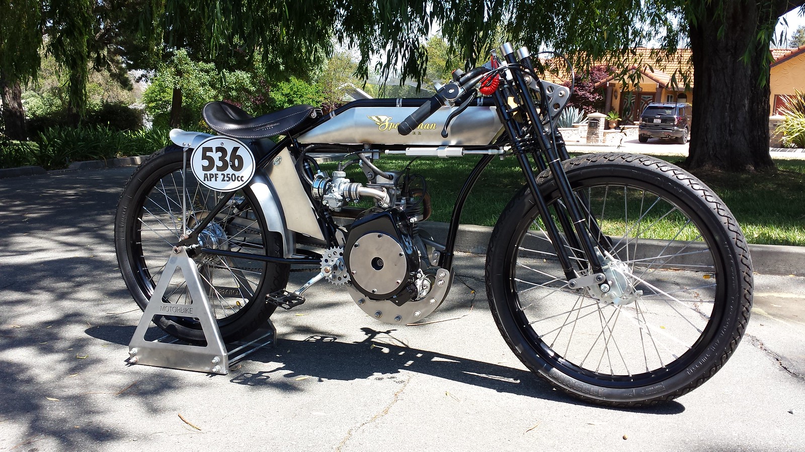

I have thought about doing a Peashooter type build and probably will eventually. For now testing will have to take place on my Keystone Flyer. Yeah, I know, an Indian tank and Harley forks. What was I thinking? These forks are taller, raising the front end to add 1 1/2 degrees more steering rake, and the swingarms are 3/4" longer to lengthen wheelbase. This was planned as the 250cc engine could reach mid to high 80 mph range! Now the fun begins. I have to tune the crazy things...........
Keystone Flyer by Sportsman Flyer, on Flickr
Everyone asks what the left side lever is for. That's an SCTA required remote fuel shut off to run the fuel class. The cable needs a very shallow bend to operate the fuel petcock correctly.

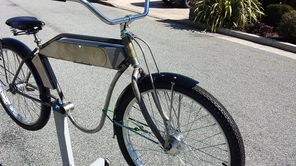

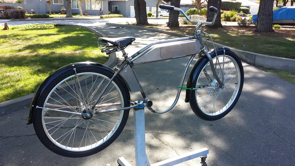

Here is something else I have been messing with. Just a simple bicycle. Flyer frame, my new truss rods added to Worksman INB forks for a vintage look, fenders, a side panel door tank, and tool box. Been calling it the "super tanker". Even has a two speed kick back Strumy Archer coaster brake. For now it's just a bicycle, but I may stuff an industrial electric motor into the loop with reduction drive pedal crank driving a sprocket adapter. Batteries in the panel tank and speed controller in the tool box.
Sportsman Tanker by Sportsman Flyer, on Flickr

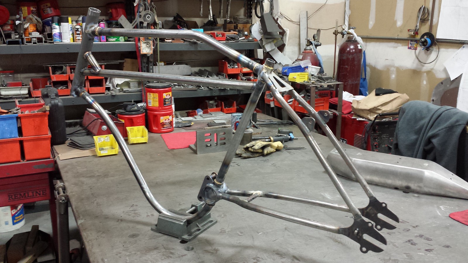

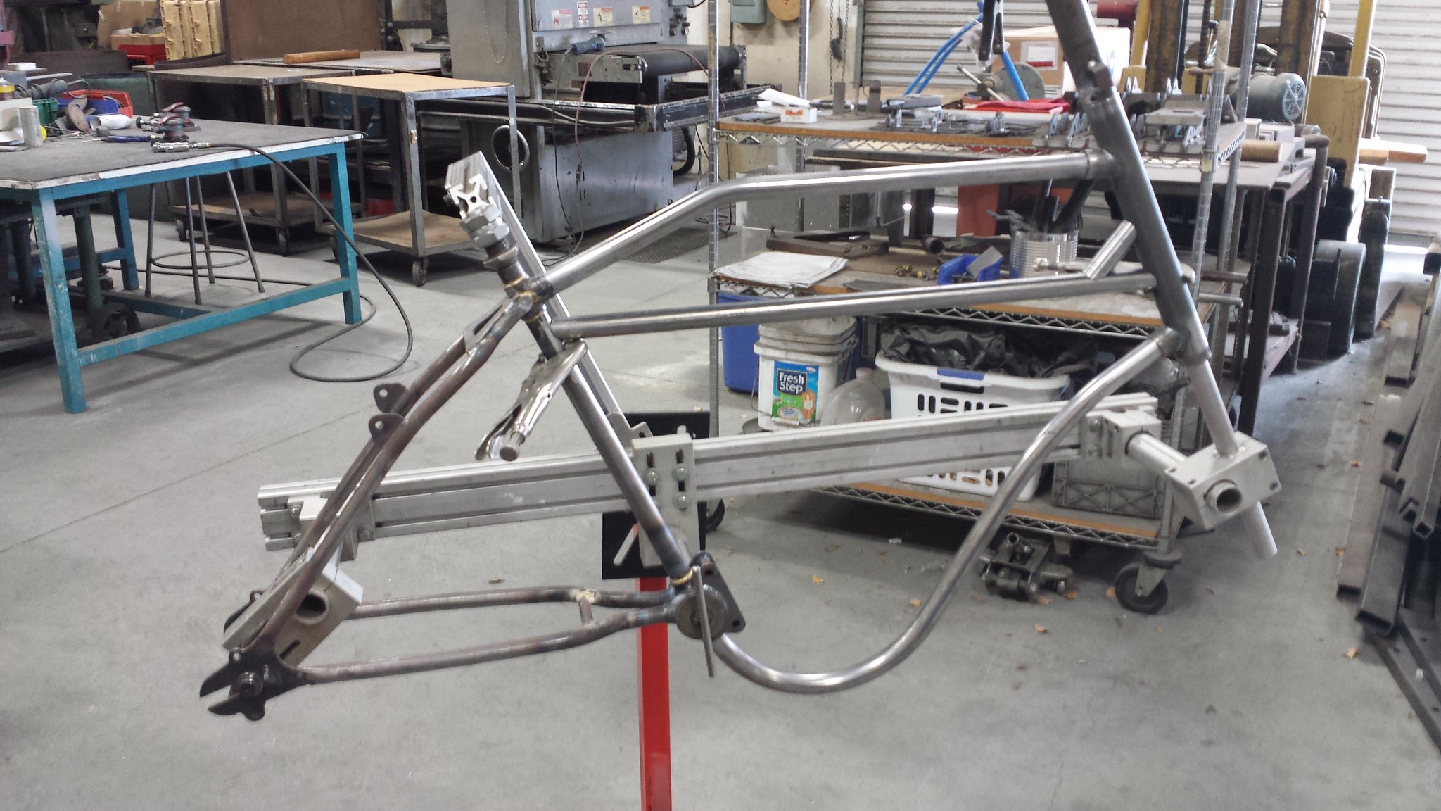

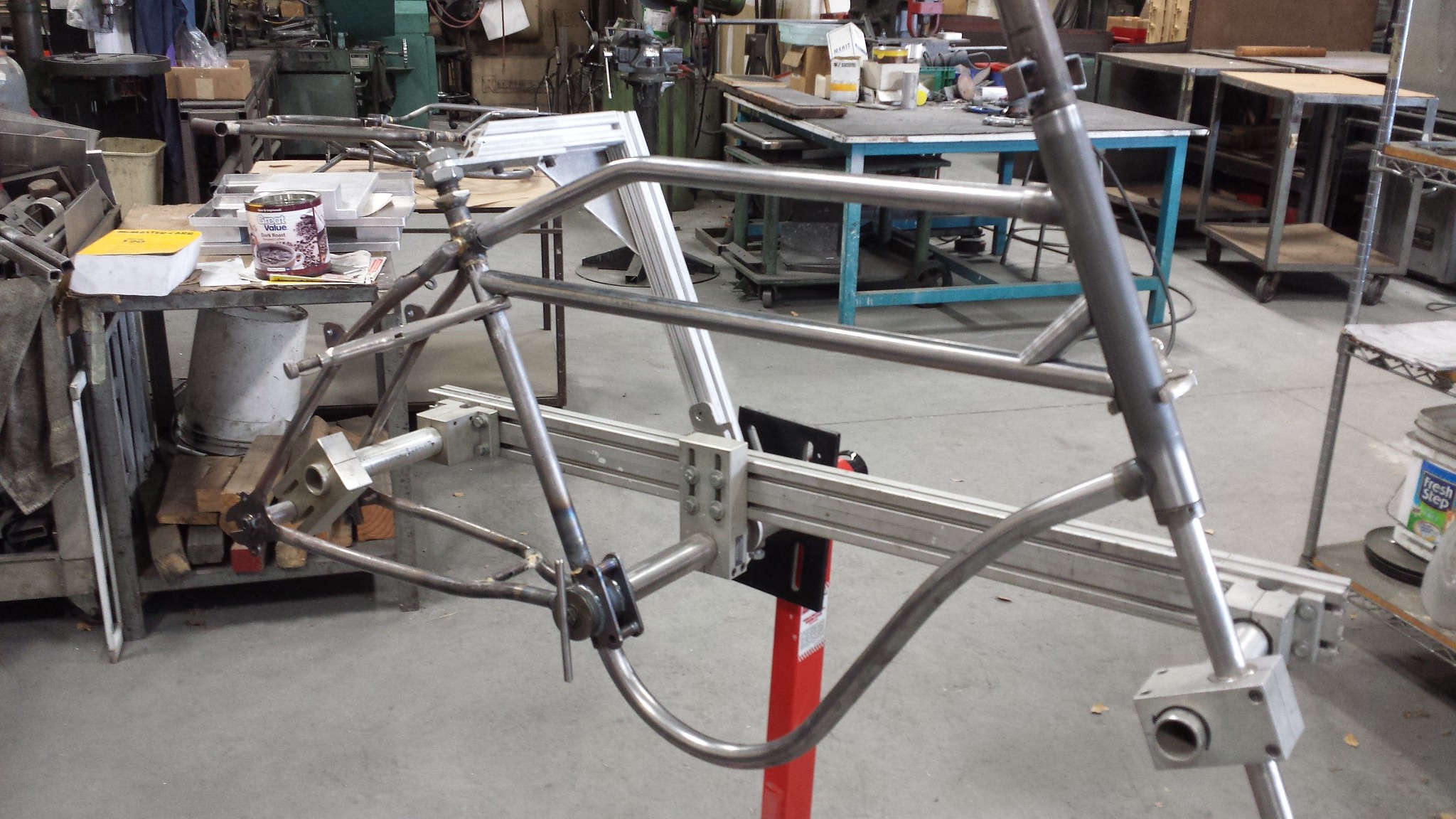

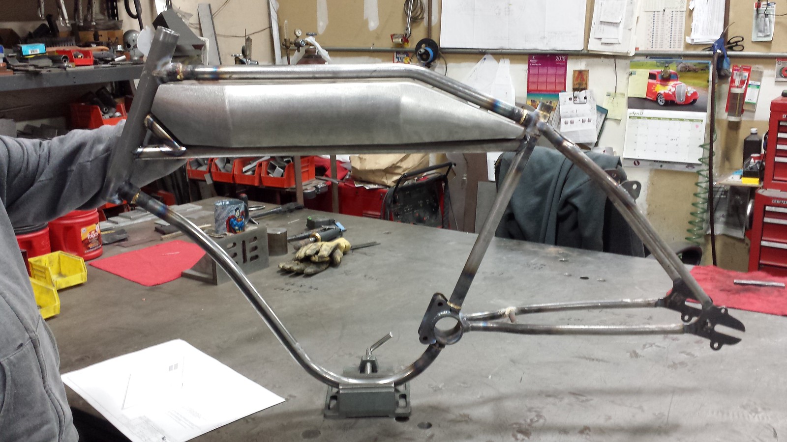

So my brother Rich has been wanting to build one based on a Sportsman 200. Here is where this project is at this point. Hard to tell in the frame jig but you can definitely see the Flyer lines in the frame. We were able to modify the down tube by just rotationg forward and making it shorter. Steer tube is custom length and lugged. Standard gas tank will fit. Engine will be an electric start GX200. Instead of groceries ours will be a pit bike to carry around tools, spare parts or maybe a vintage ice chest at the Bonneville Salt Flats.
Sportsman "'Flyer Delivery" by Sportsman Flyer, on Flickr

Rich gets all the credit for this idea. He was always the Cycle Truck fan. For me, well, I am starting to get it. I like messing around and my brother always gets me to step outside my comfort zone with (almost always) good ideas. Here it is fresh out of the frame jig and dummied up with a gas tank. Now I get it!
Sportsman Cycle Truck by Sportsman Flyer, on Flickr

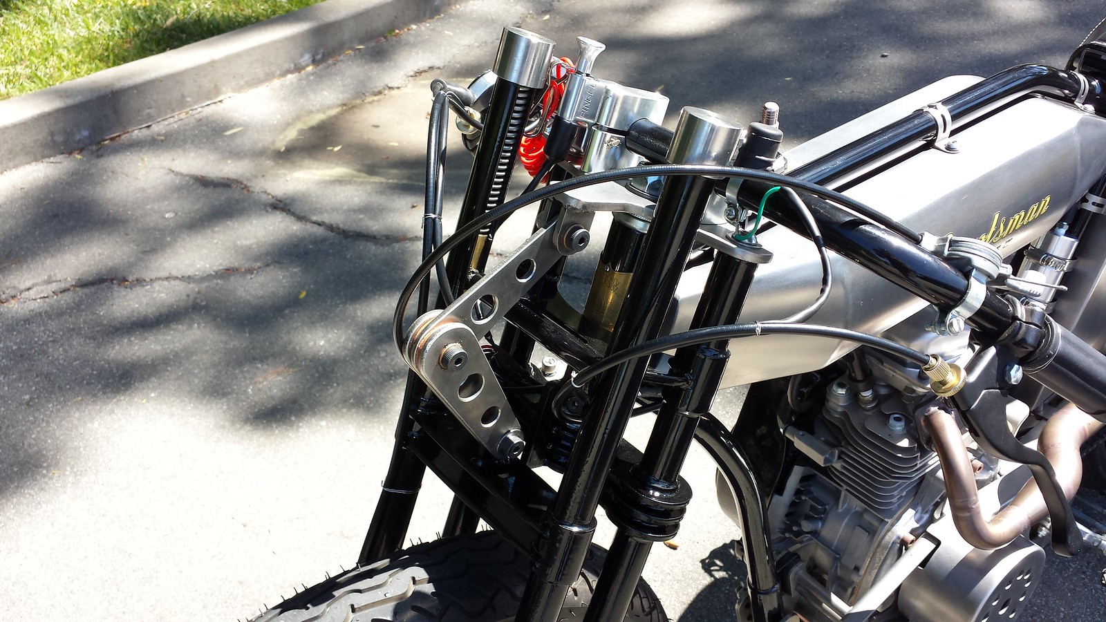

Well, I finally tested out my new fork design today! Worked great. Really solid feel with good spring rate. Overall the function and feel is excellent. My Keystone Flyer is geared at like 7.5:1 so clutch lock happens at 38 mph. Once off clutch I cruised it around at 50-55 mph giving it a good shake down. Windy roads. Running it throught the mid range rpm band. Couldn't have been more satisfied. Even the new handlebar designed worked out. Nice narrow width, single piece bar design and they clamp directly to the fork blades.
Super Duty Forks by Sportsman Flyer, on Flickr
