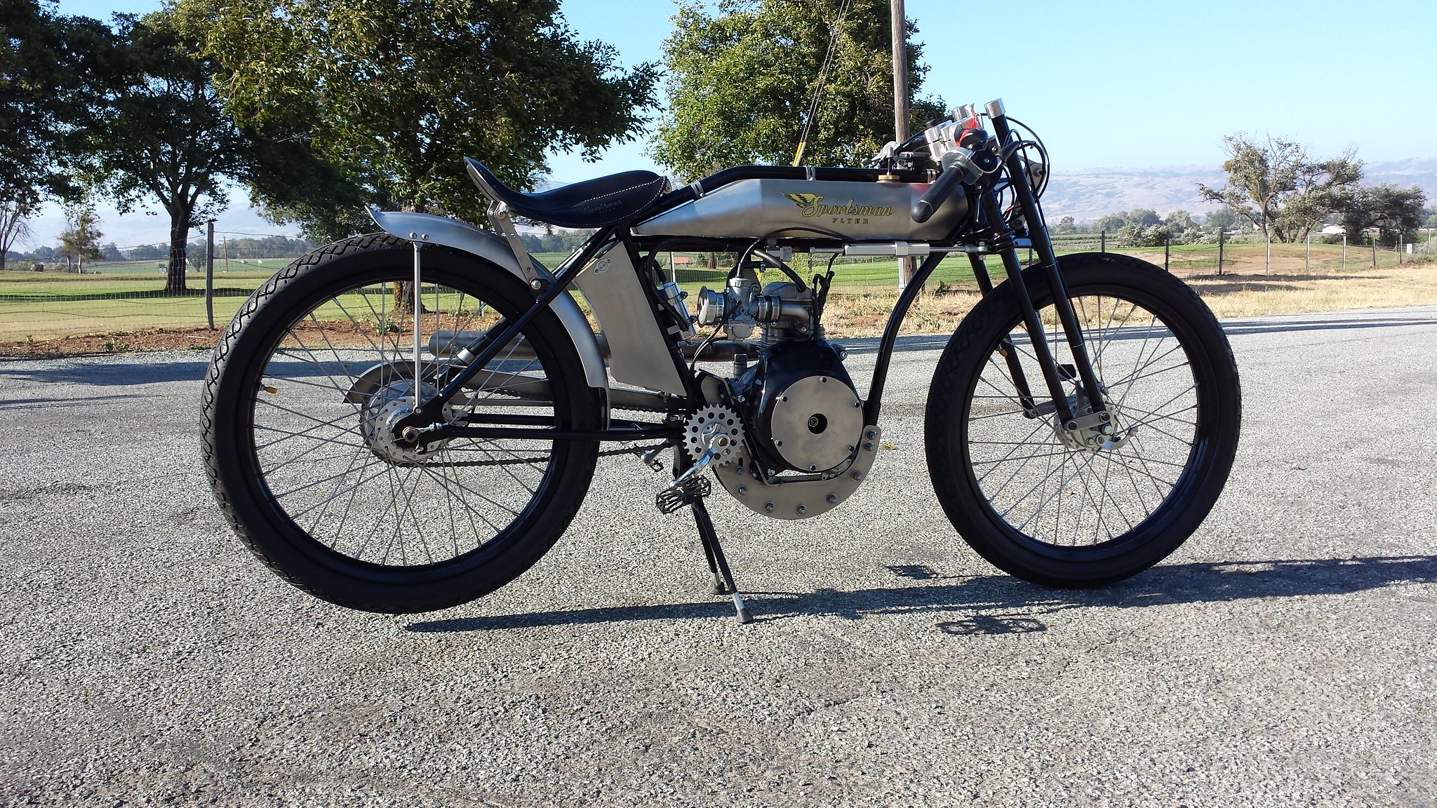

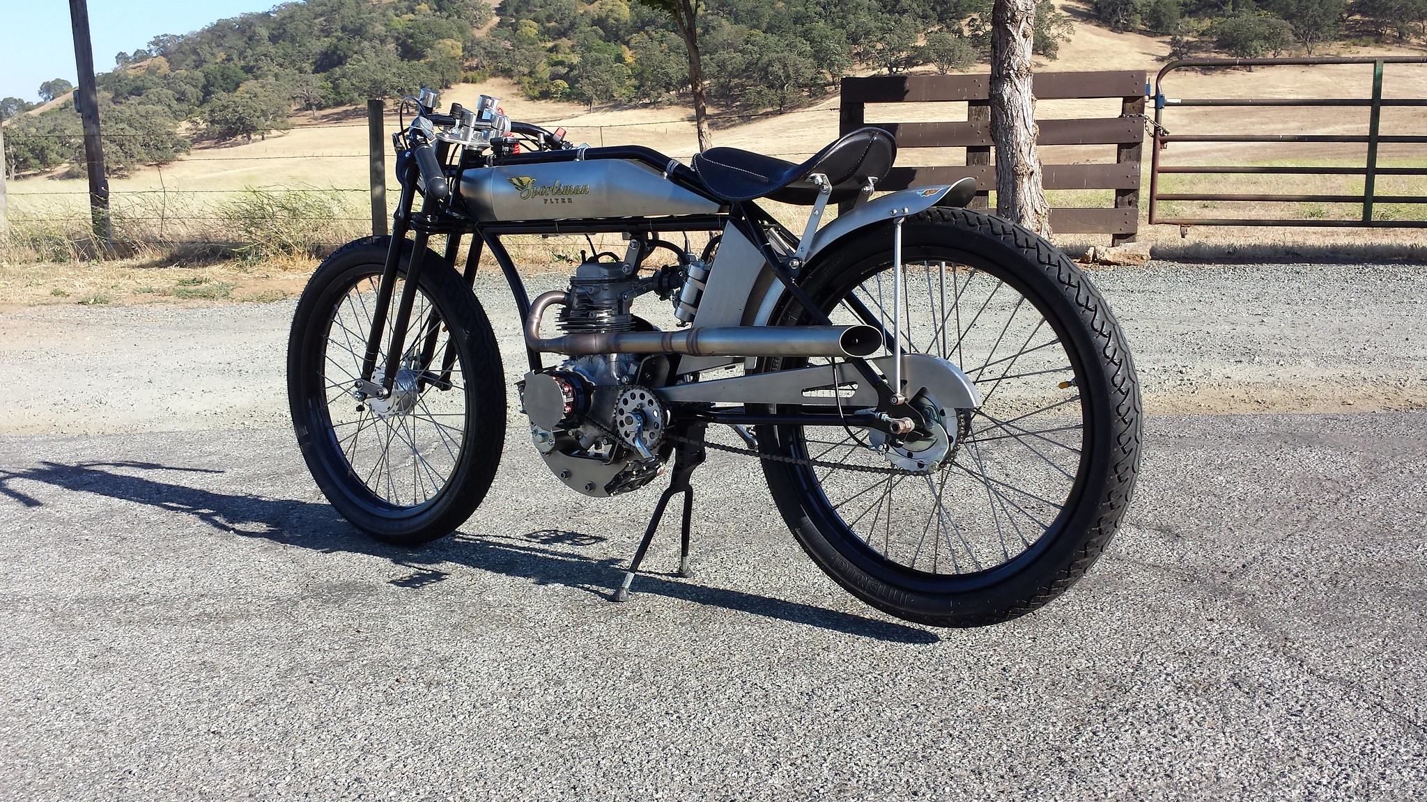

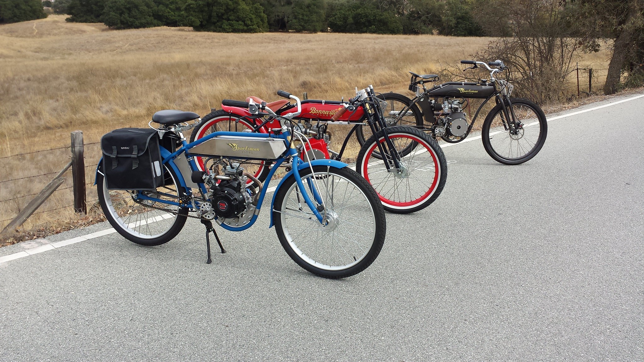

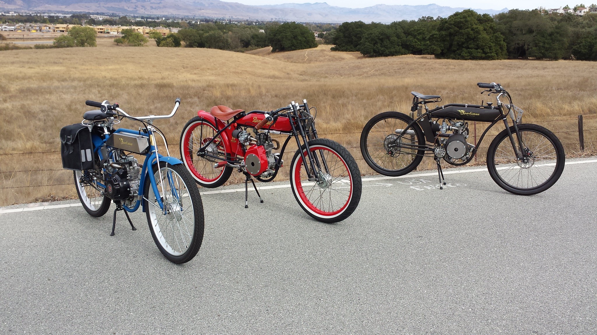

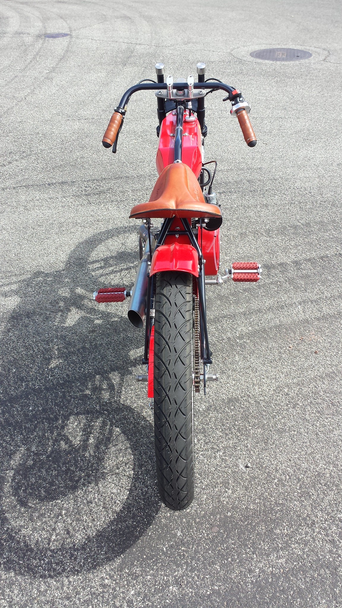

Been putting more miles on the Keystone to get comfortable with the changes. I pulled the race engine and number plates so I can hopefully cruise under the radar. At this stage it's important to put the chassis changes through it's paces. Even minor changes affect the whole chassis. I have added a couple inches to the wheelbase, and by raising the front end have relaxed the steering angle for better high speed stability.
Keystone Flyer by Pat Dolan, on Flickr
Current engine is actually my brothers so I have to be careful. If I damage it I own it. It's a Honda case GX200 with Harbor Freight Hemi head with estart and charging system. I have more scheduled testing next week on a test track. We'll see how that goes but at this point I feel pretty good.

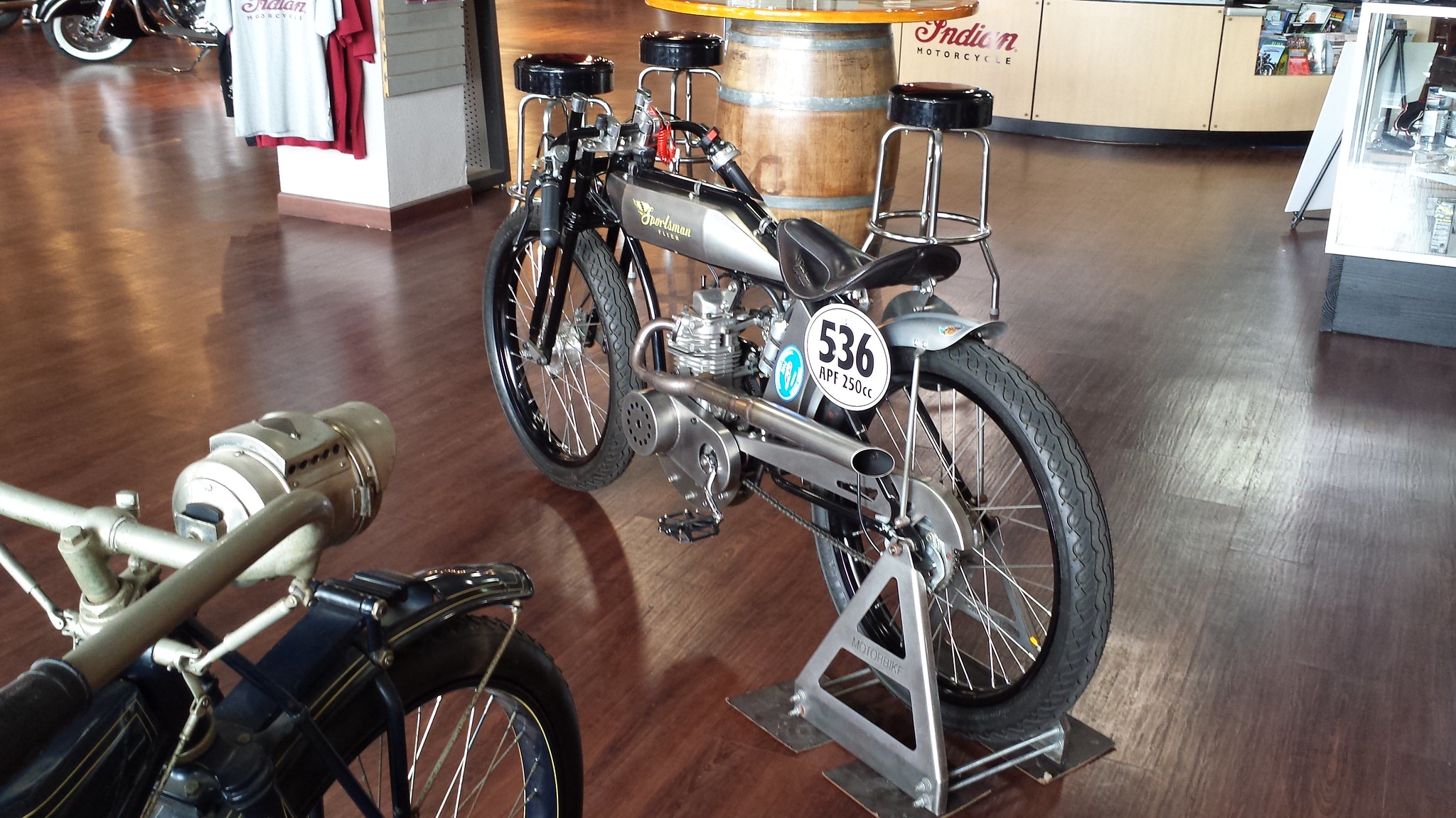

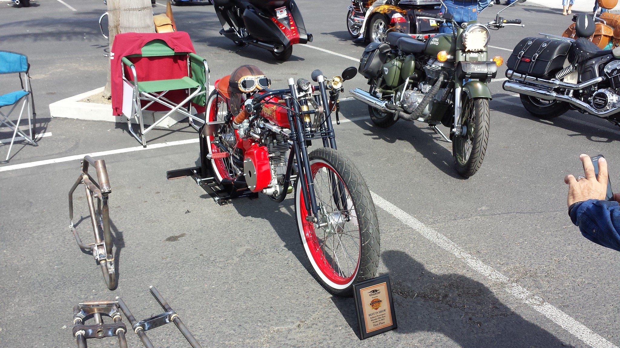

Went to a local motorcycle show at the Indian motorcycle dealer in Hollister California. One of our bikes took best in show and won $500! The event was a charity fund raiser for Wounded Warriors. After the show I was asked if I would be interested in leaving one of the bikes in their showroom to put on display. I happily agreed. So, if you guys are anywhere near Hollister drop on by. You can't miss my bike, it's parked right next to an original paint 1913 Harley.
Hollister Indian Dealer by Pat Dolan, on Flickr
Local Show by Pat Dolan, on Flickr
