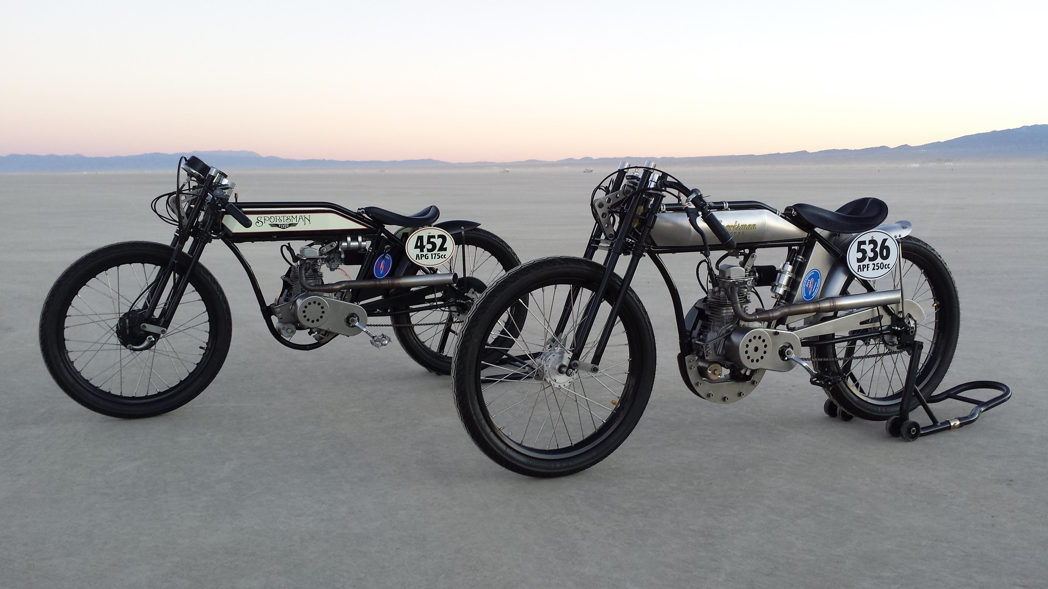

Picture from El Mirage dry lake bed last weekend. My brother and I ran APG175cc and APF250cc. I ran 82.568 mph on the 250. The lake bed was as smooth as a pool table!
El Mirage 2015 by Pat Dolan, on Flickr

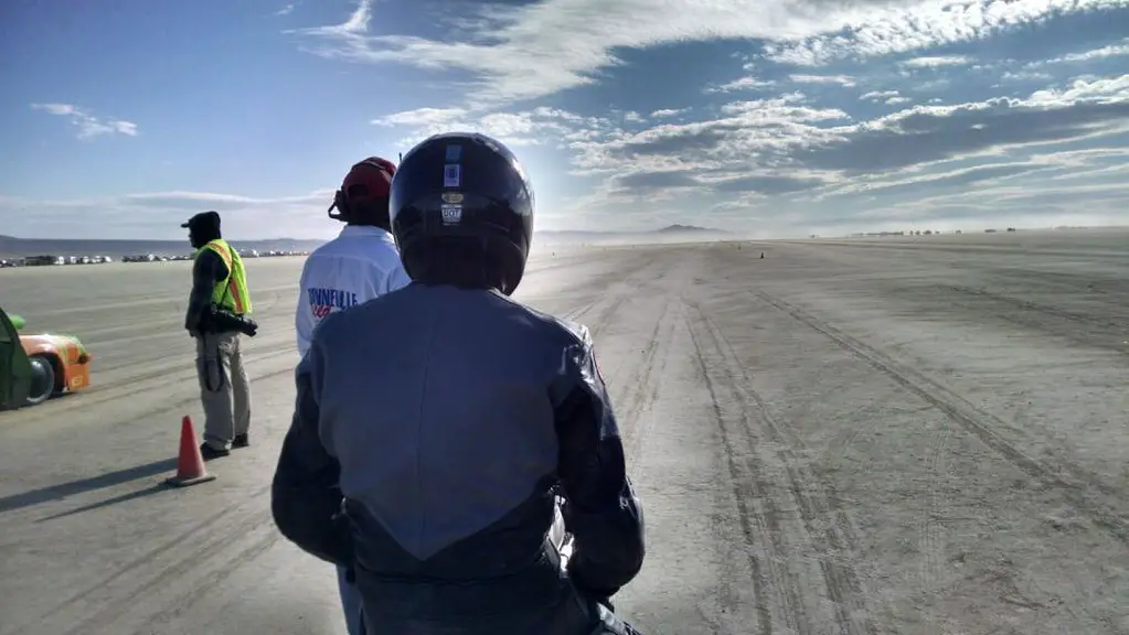

When it comes to racing, does it get any better than this? Cold clear morning and the track is all mine!
Morning Run by Pat Dolan, on Flickr

It's a pleasure sharing with you guys. I was sitting there ready for my morning run and the guy in front of me scattered his engine so they had to walk the track before I could run. The dust cleared and I could see conditions were perfect, just perfect. Glad I thought to have my chase driver stand behind me to take that picture. So smooth my suspension hardly even got a workout. Anyway, our bikes are legal to race and we are into the 80's pretty solid and consistantly.

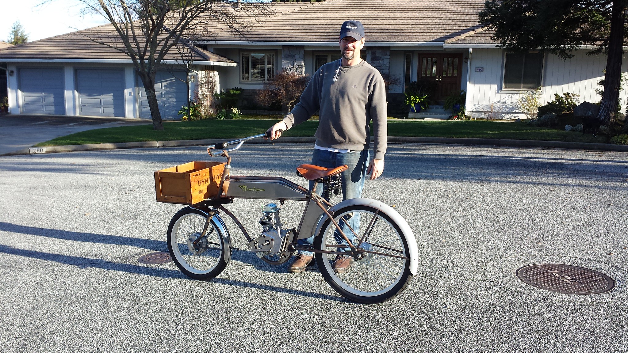

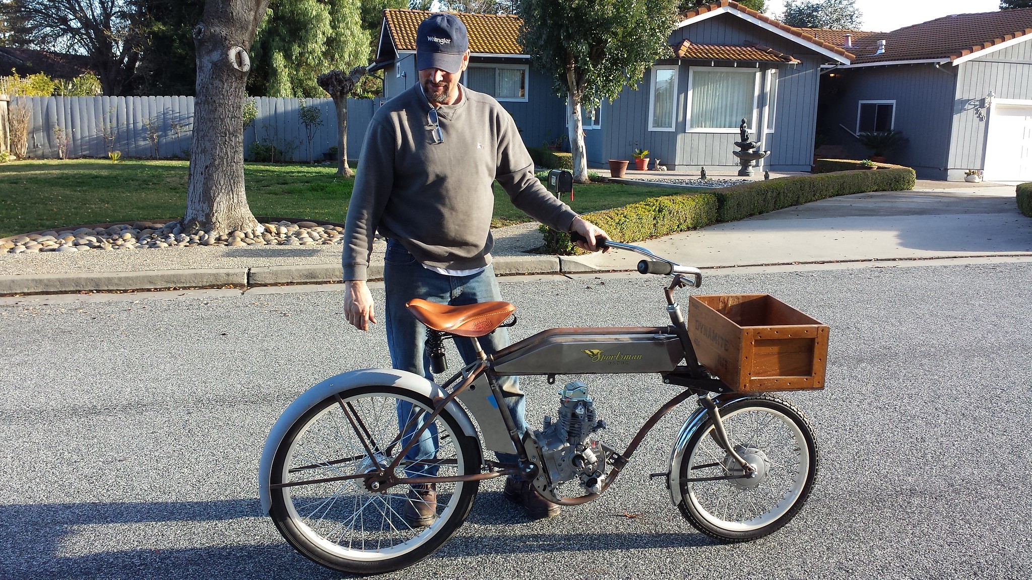

Alright guys, I have said this before but my brother Rich is always trying something new. Usually it's a direction I wouldn't normally go, but once he does it I finally understand. This is a good example, a motorized cycle truck. This build used a spare early Sportsman 200 rear triangle, a standard loop down tube rolled forward, a flat side Flyer tank and a custom manufactured head tube. The forks are early Worksman brazed cycle truck forks. The front Wood box, from what I understand, came from an abandoned mine.
Sportsman Flyer Cycle Truck by Pat Dolan, on Flickr
It's a real mix of parts. The saddle uses a 1930's wire type springer frame with a Sportsman saddle grafted on. Engine mounts are modified Sportsman 200 and the bike, I mean "truck", uses an electric starter. Not shown is the front wheel kickstand. Bike is designed to 150 pounds of parts, groceries, beer, whatever. Cool build Rich, now lets get it fired up!

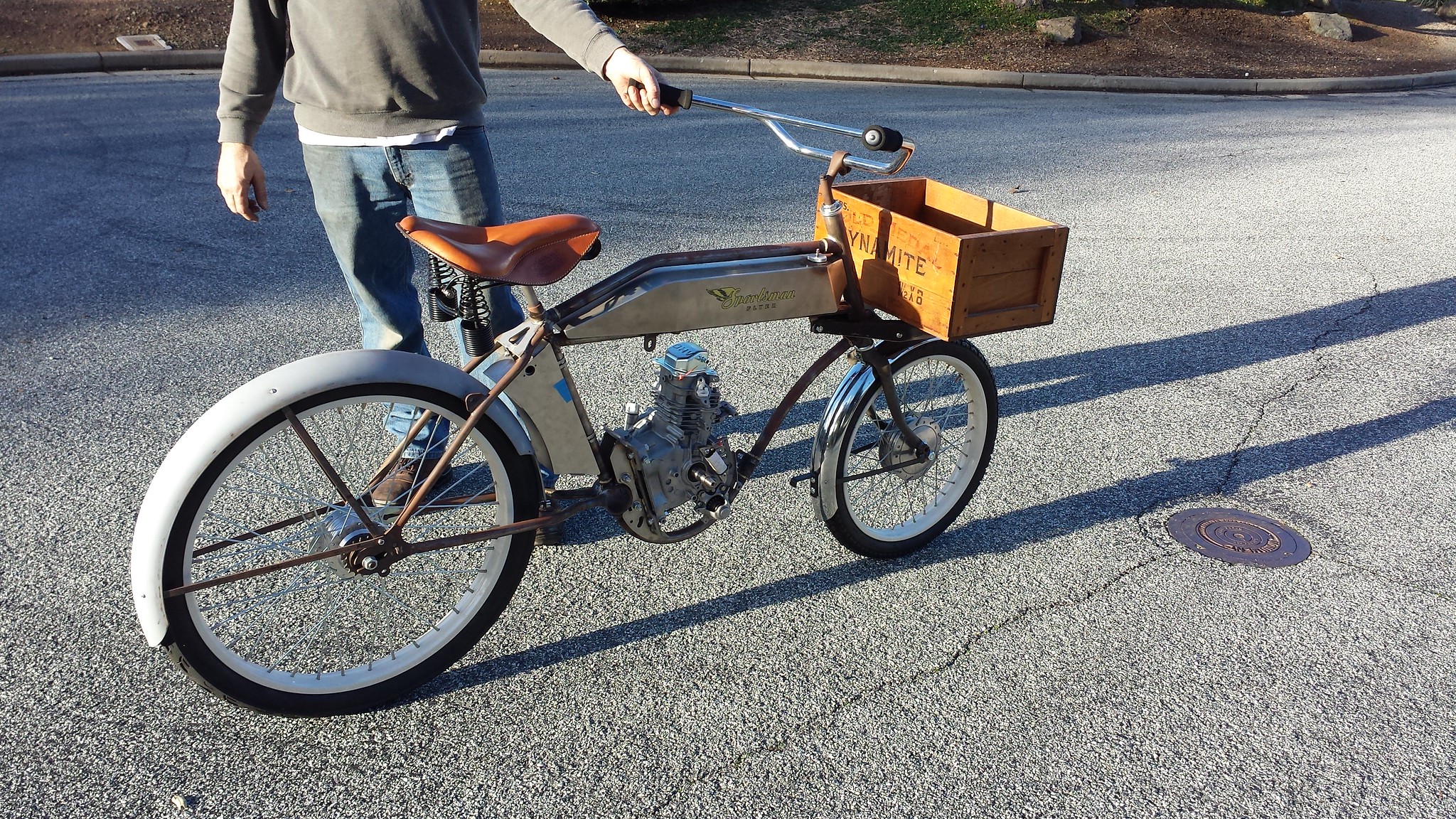

I like you brothers choice in boxes! I too did a cycletruck a few years ago and used 2 old dynamite boxes for the front!
Hey Dan, cool dynamite boxes and that's a nice Cycle truck. Looks like a Worksman.
As far as doing more of the Flyer cycle trucks, I made another set of frame pieces at the same time as we did Rich's frame. Figured I would do another for myself but base it on my pedal bike frames instead of the Sportsman 200. Then I would use a clamp in mount for the HF79cc or GC160. Right now the extra parts are collecting dust.

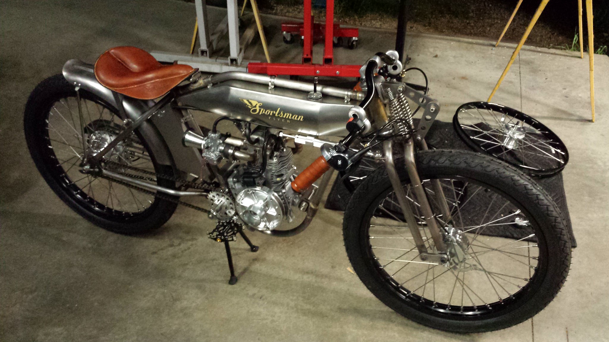

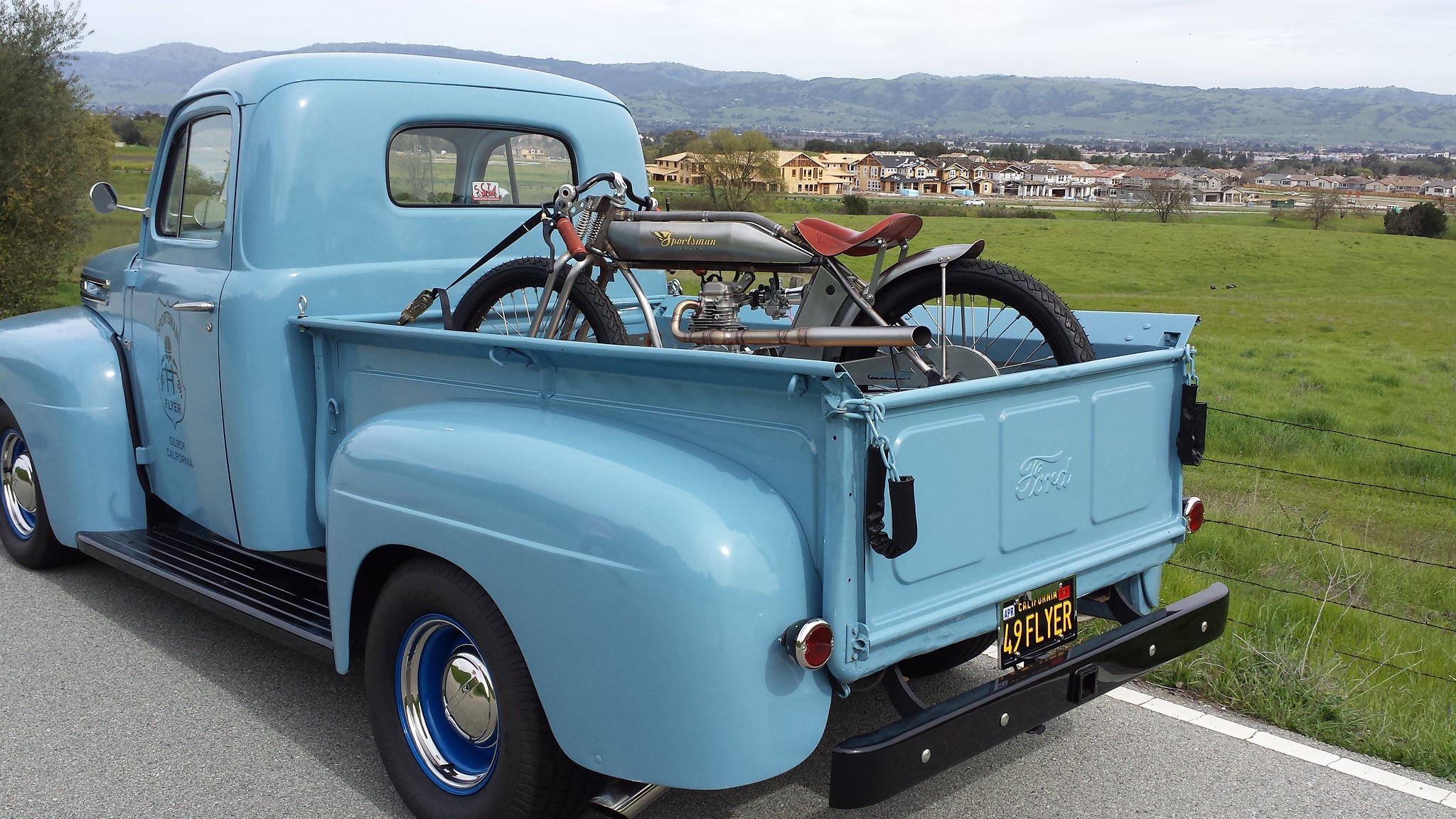

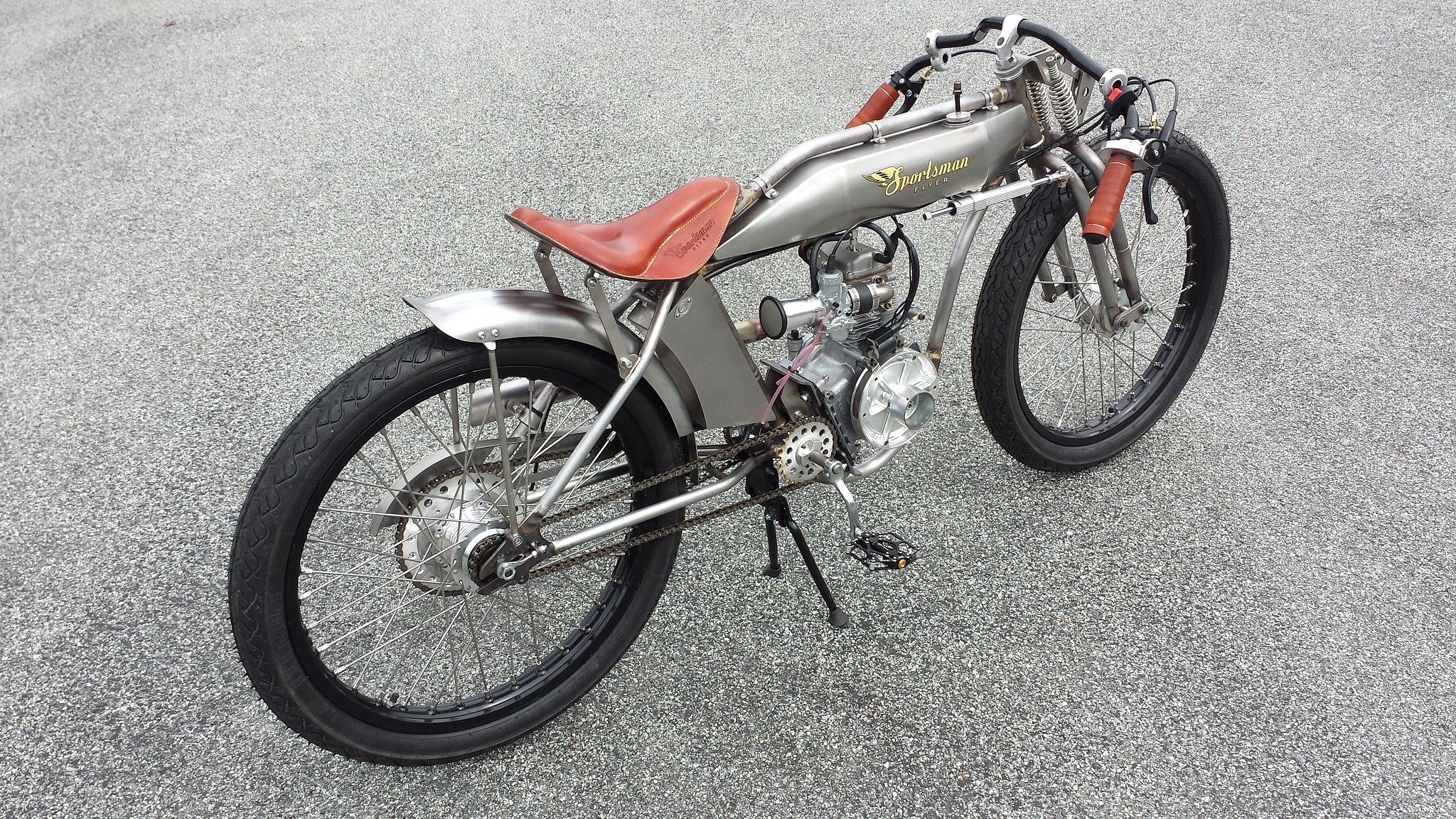

Another Bonneville Flyer build. This one has a 212cc Hemi head Predator. Raw finish, early style Sportsman Wide Glide forks with friction shock. Rope start and simple all the way. Indian style tank and bars. Beautiful honey color leather seat and matching grips.
Bonneville Flyer #12 by Pat Dolan, on Flickr
Vintage Hauler by Pat Dolan, on Flickr
This build has excellent road manners. Easy to start and very powerful. Handles nice and tight. I find it revs just so smooth and because of the high compression when I snap the throttle close it has excellent compression braking. Spent about an hour putting it through it paces and when I rolled back in to the shop and shut it down I could tell we both got a good workout! Yep, that was fun.....
