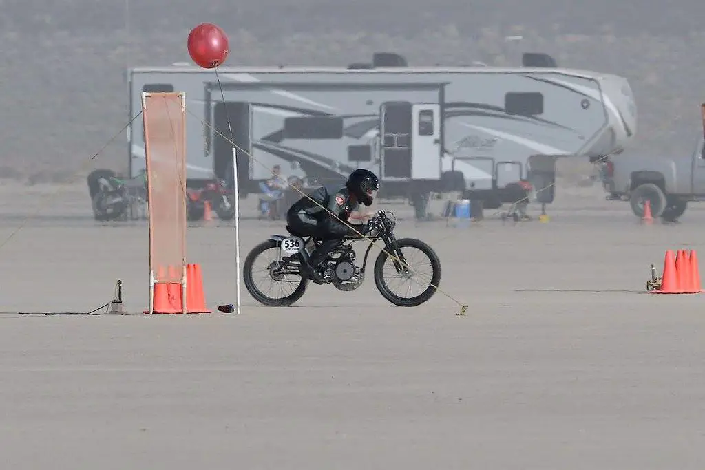

Thanks Steve. We just ran two bikes over the weekend at El Mirage. We now run both the salt flats and dirt dry lakes. Both bikes were up 3-4 mph only to slow down right before the timed area. Either ignition or carb. Most likely carbs. Anyway, bikes felt very stable and powerful.
Here is Rich at 80.747 mph on his 175cc bike.
El Mirage May 2016 by Pat Dolan, on Flickr
Me at 82.074 mph. This is right at the line where speed is measured. Man, I learned a lot looking at this photo. I would tuck lower but need to see where I'm going!

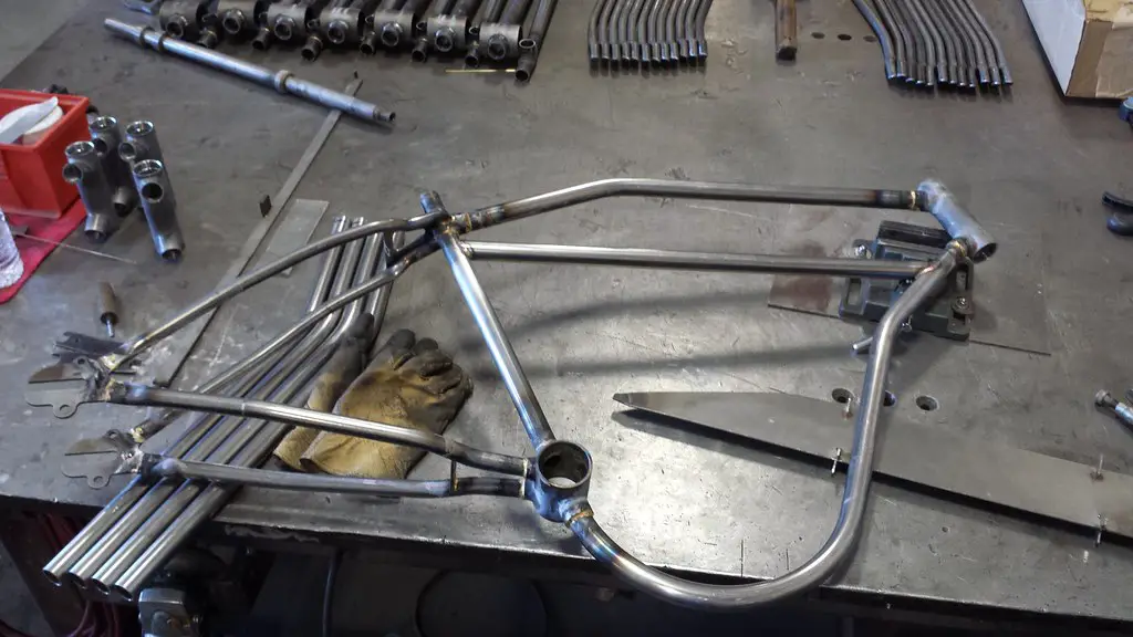

Thought I would share a quick update on what I call my "pedal bike" Flyer frame. This frame has been a joint effort with myself and Worksman where they supply the Worksman INB rear triangle and I build forward into the Flyer frame with a drop loop for added engine space. These frames have 110mm hub spacing for the Shimano coaster brake and other 110mm spaced rear hubs. This hub has been fine for smaller engine builds but bigger engines require bigger hubs and these are all 130mm or 135mm standard. The electric bike guys also need this wider spacing. Bigger engine builds also need larger 1/2" dropout slots. I took a few of the INB frame stay and chain stay tubes, added an additional bend to take them from 110mm to 135mm and then laser cut beefier dropouts to finalize the 110mm to 135mm conversion, then brazed them up.
Standard INB bottom bracket, seat post and 110mm chain stay tubes. Notice how straight the tubes are after the initial bends at the bottom bracket. You can also see the nice forming for the dropout to slip into where it then gets that good old school brazing.
135mm Flyer Pedal Bike by Pat Dolan, on Flickr

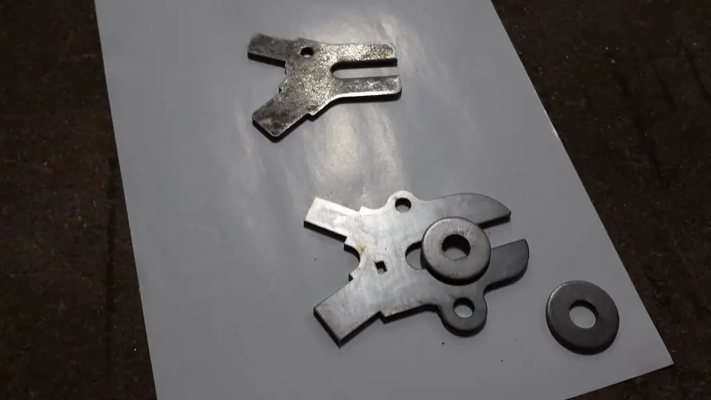

The upper dropout in this picture is the standard Industrial News Boy dropout and below it is the 135mm version. The small square hole in front of the slot will get a small tab for proper chain tensioners. Nice extra thick stamped washer completes the dropout package and helps spread the load of the larger axle nut.
135mm Pedal Bike by Pat Dolan, on Flickr

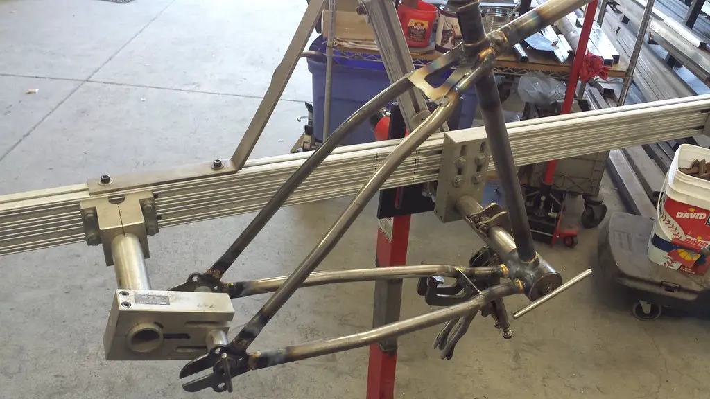

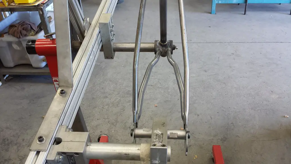

This is a picture of a test fit of the 135mm spaced components. You can see the added bends in the tubes. This is before the frame spreaders are added in.
135mm Flyer by Pat Dolan, on Flickr
Spreaders added in and everything brazed or tig welded. The upper frame stay tubes have an added gusset plate to hold it all together. Drops now have axle adjuster tabs installed.
And here it is, the first 135mm pedal bike frame!

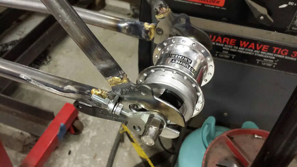

Here's a cool hub. This is the new 125mm spaced Sturmey Archer S1C, which is a heavy duty single speed coaster brake, mounted into my new frame. I have yet to try this hub out. It will need some development work as my current sprocket adapter main body isn't large enough to adapt to this diameter. Once figured out, though, I think this could become a real coaster brake with enough strength to handle high hp builds. Time will tell. One thing for sure is it's heavy! To me that's a good sign.
Excuse me sportscarpat. Will the 135mm or the 125mm hub spacing on your pedal cruiser still have the as perfect as possible chain alignment as you have with your clutch, reduction hub and rear sprocket on your sportsman 200 or the pedal cruiser with the 110mm hub spacing? Thank you sportscarpat for your discipline in figuring out all the details to make a good looking excellent performing motorized bicycle.
I have the various offsets worked out for proper chain alignment except for the 125mm coaster brake. With this new coaster brake it's more about mounting a motor side sprocket to it than getting the offset correct. It will require an application specific sprocket adapter.

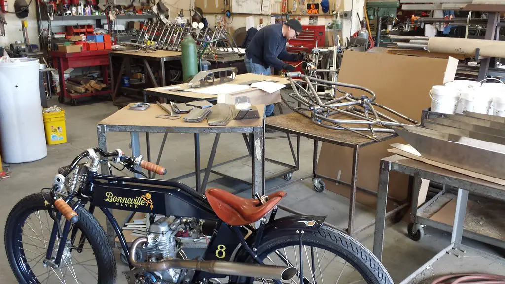

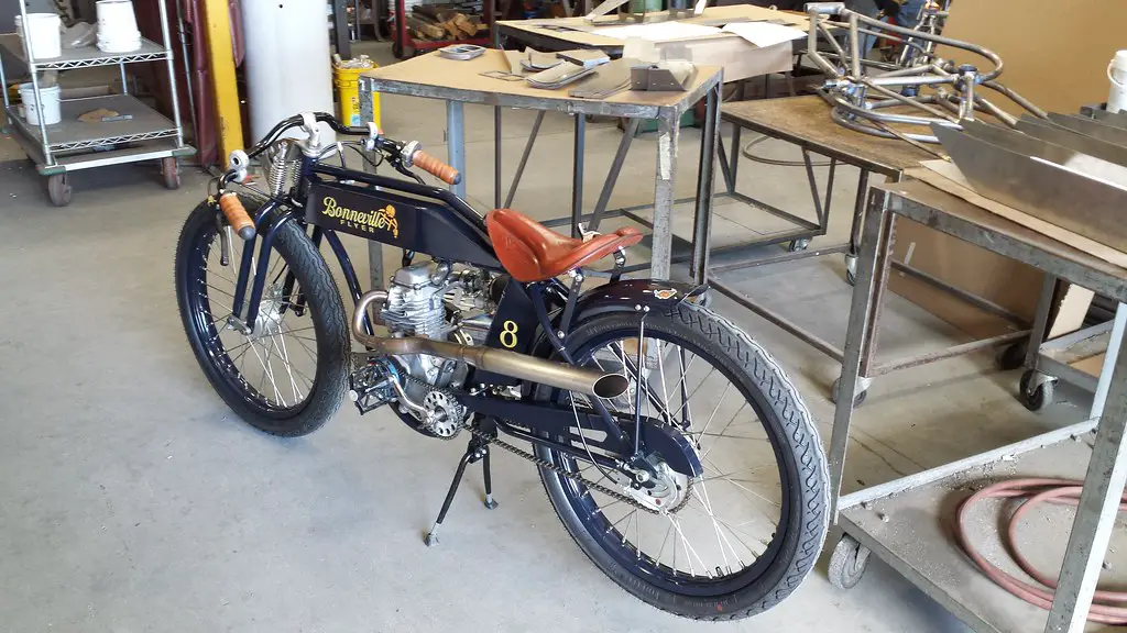

Here's what I rode to the shop today. Bonneville Flyer chassis #8. We may stop production of this design at 15 as we have an updated version in the works that will capture what we have learned running the salt flats.
Flyer Factory by Sportsman Flyer, on Flickr

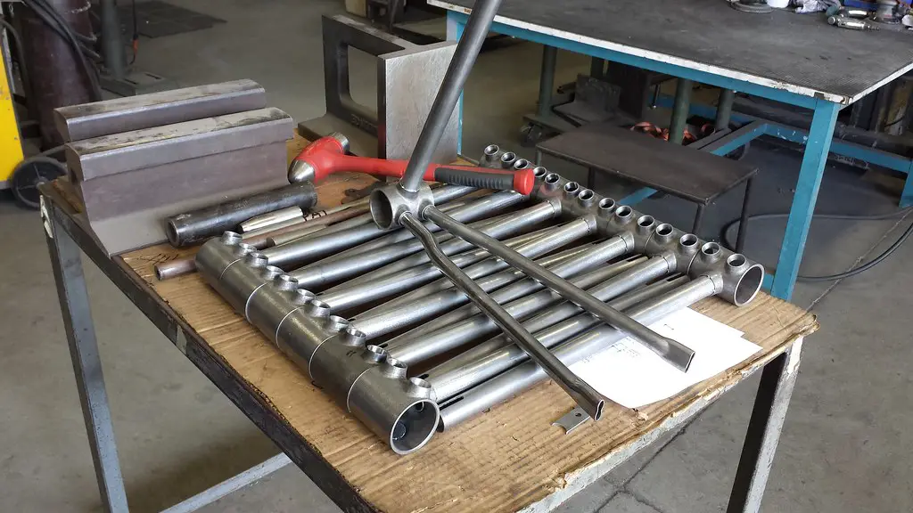

More frames in production in the backround. Looks like the loop down tube is being brazed to the bottom bracket lug.

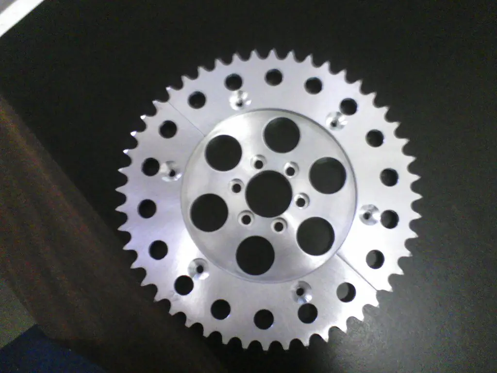

Here is an adapter plate and sprocket that is going on a rear disc brake hub.
Adapter and Split Sprocket by Sportsman Flyer, on Flickr

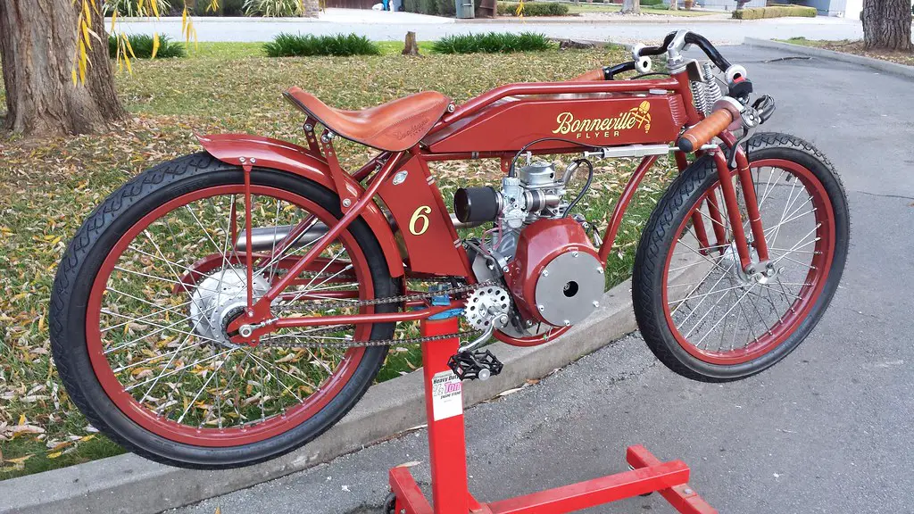

Final pick of a Boneville spec chassis that is running a full charging system, battery, and electric starter.
Bonneville #6 by Sportsman Flyer, on Flickr

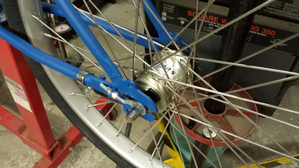

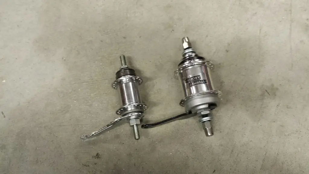

Shimano 110 vrs. the Sturmey S1C. There is a big difference between a 110mm and 125mm hub. Bigger bearings and with the added width I don't think coaster brake arm clearance will be a problem.
Coaster Brakes by Pat Dolan, on Flickr
This is the S2C, which is a two speed kick back coaster brake. I see potential with these hubs but need to test them out under engine power first. Of course it means a new design sprocket adapter as the hub (as I recall) is 2 1/4" diameter verses the Shimano 1 1/2".
I can see how that would be better for wider frames.
Are you going to make a hub adapter for it?
Keep us posted. (^)
Thinking about it. The hub shell is tapered with a center flat area wide enough to clamp to, but that wouldn't allow side to side adjustment of the adapter body.
