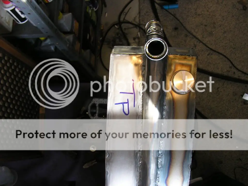

I think im going to try to plug both ends of the extra large top tube of my micargi puma with 3m metal bonding adhesive. tap it for a filler and petcock. anyone tried this sort of thing yet? sucess? disaster?
both ends on the poma top tube have drain holes you would have to cut it completely off and plug and reweld i chose this route with my puma this is only one side the other will match
http://i755.photobucket.com/albums/xx197/tacoshell3/P1012034.jpg
Very nice work. Those welds look great. Thanks for the info. When finished are you going to be using both sides for fuel? Im still thinking cutting off the top tube off and rewelding it up, might still be an option for a super clean look. Not sure how much fuel I can hold that way? I guess the question is the juice worth the squeeze? lol
