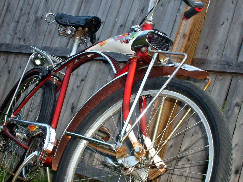

These tanks are awesome! Really feeling the Sachs one!!! I'm new to this so ideally how would you go about mounting this to a beach cruiser?
Slayerkills,
You can mount them a number of ways. The sachs has mounting holes on the tank to utilize. You would just need to fabricate two small brackets that you bolt to (or source them from a hardware store). Then bolt that bracket to your frame. You could get away with no welding but you'll most likely have to drill a hole in your frame for a through bolt. If you look around you may even find something that doesn't require you to drill. If you need help figuring it out you could always PM me and I'll do what I can.
