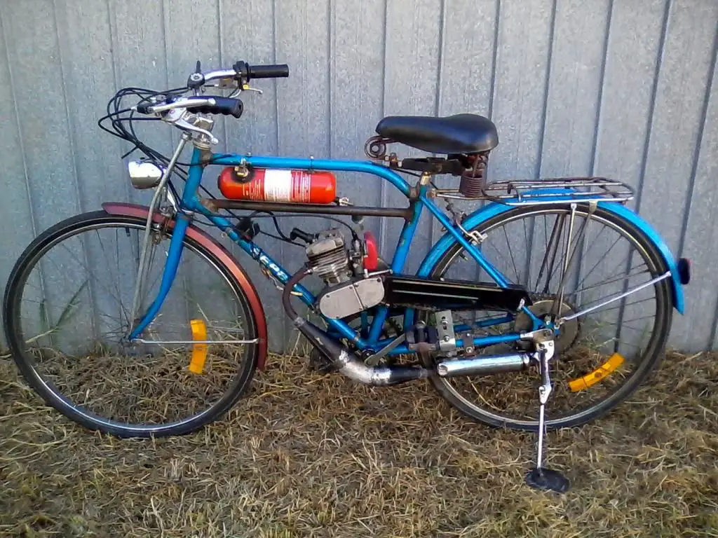

i have made tanks from fire extinguishers and im making a west coast chopper tank fit in the frame of my cruiser,i dont have a mig welder so im stuck ising the arc and still manage to get them sealed it just takes alot of patience

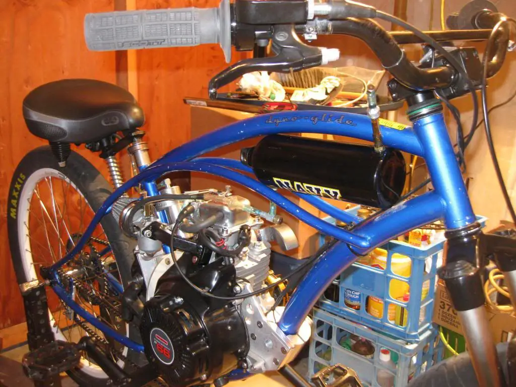

I used an old car drive shaft, cut to length. The front yoke is a heavy cast piece that looks cool when ground down. Sealed the back with a piece of plate steel welded on. Held just under a gallon, and quite heavy duty.

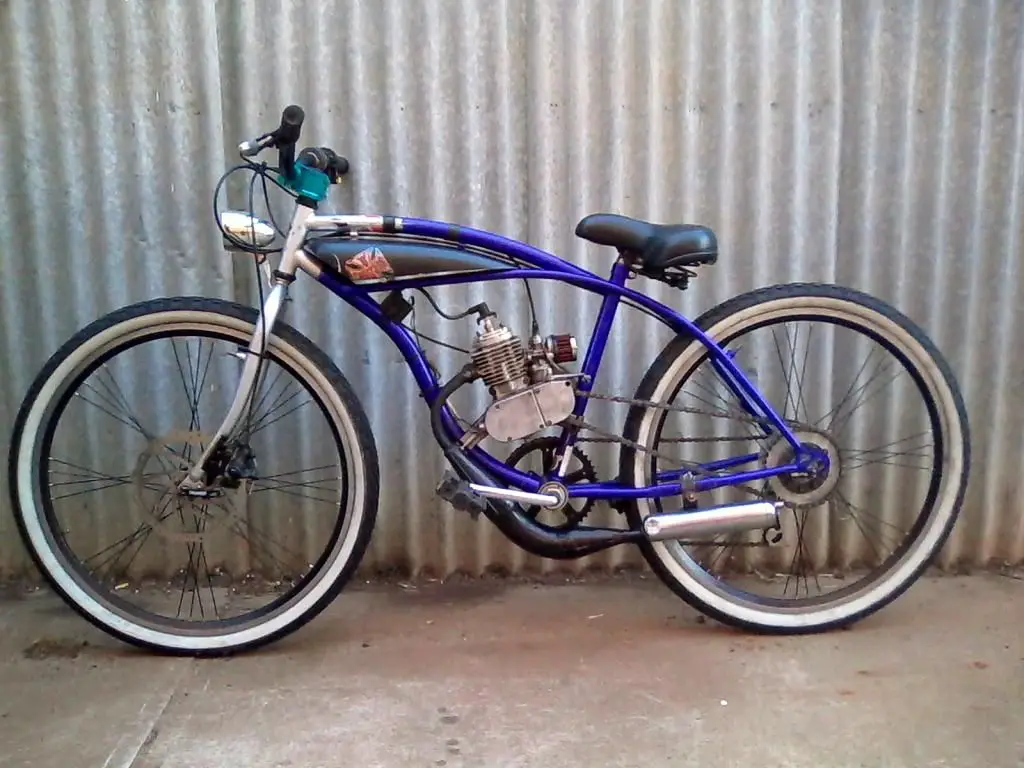

I hope this works. I located my old green 3 hp Clinton/Rollfast Hopalong Cassady in "my photos" and sourced it by a file number . This is the one with top mounted shutoffs and PS reservoir caps. Made from exhaust tubing. It shows a settling bowl and another shutoff underneath.

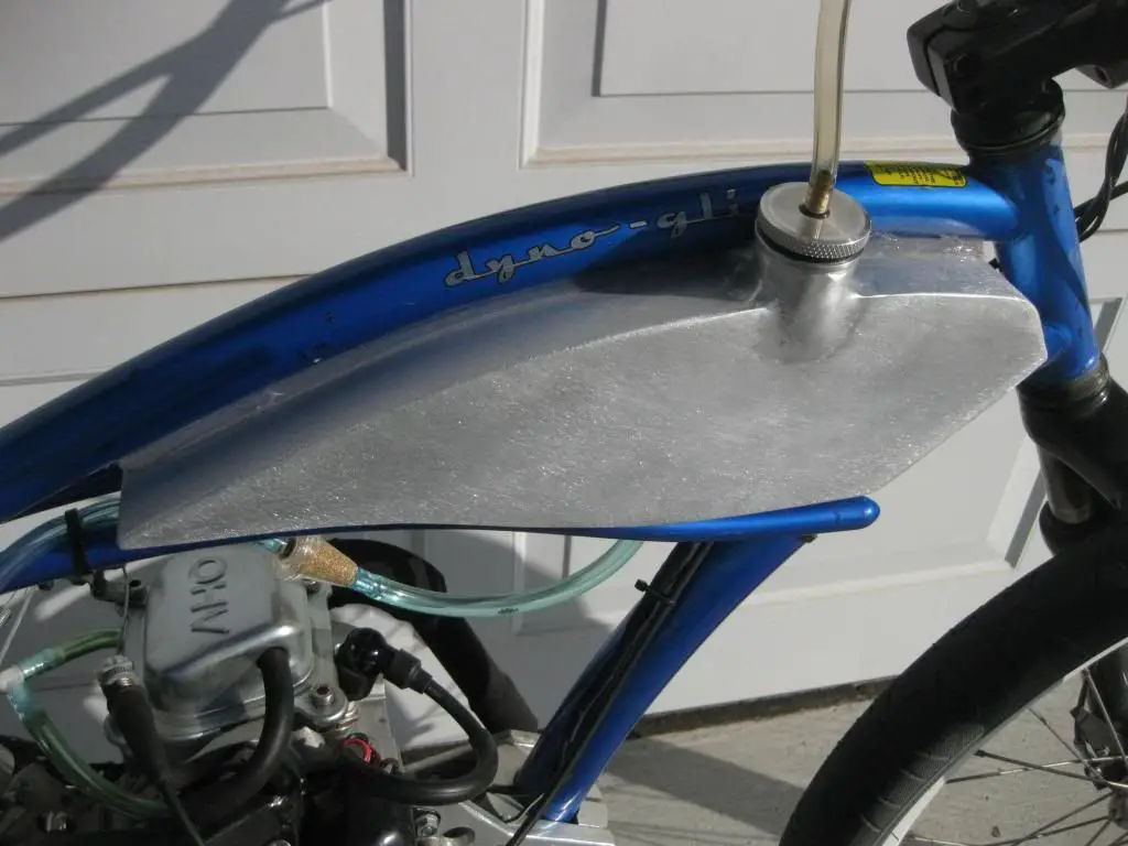

Here's a couple for ya......the temp tank
......and the finished tank
Sometimes ya gotta do whatcha gotta do ;)
.shft.Trying again re-sized By golly it worked this time after re-sizing. Thank you Photofiltre. This is the Rollfast with 3 hp Clinton With homegrown fuel tanks. The design is typical of what we rode late 4's early 50's The handlebars for foot-box support /crash-bars is very strong and almost all motorbikes back then in Bartlesville OK One exception was an old fart that rode to work every day with a 2 cylinder Maytag 2-stroke on the rear rack. This was during WW2 gas rationing.cvlt1
