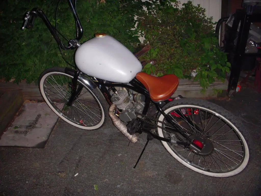

It turns out that the fiberglass resin that I always use for other projects is not compatible with gasoline, and I don't want to pay for some that is. So I started on a steel tank for my next build. The image below shows what I have so far. I'm waiting until I find a springer fork that will fit my frame before I weld sides onto it. I need to make sure that any fork that I put on this bike will not hit the tank during normal riding.

Coastal, I use epoxy resin from US Composites. I've made fenders for my bike and a few non bike related things with it so it's what I'm used to. Just to make sure, I asked the manufacturer if it was compatible with gas and they said no. There are many different types of epoxy and some will work with gasoline and some will not. I had planned to seal the tank with some type of tank sealer either way, but I'm just a little paranoid that the gas will some how get around it, maybe through a fitting or something. So I decided to go the steel route instead.

slump, that is really a head turner the white tires really set it off. You must get a lot of compliments with that bike. Nice work, beautifully done, you are a perfectionist.
