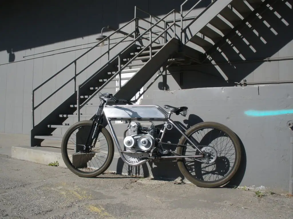

A little update: I rode the bike all weekend...to the beach to beverly hills and all over my home town area, no issues at all...even rode with my kid and we had a blast racing each other...this bike is fun to ride and gets a lot of looks. The stretched frame is ideal.
I started a battery box, added a cable holder for the brake and made another exhaust that has a removable silencer so my neighbors don't Hate me...thank god I have cool people in my area.
I am trying to make a logo for the side of the tank...really not sure what I like

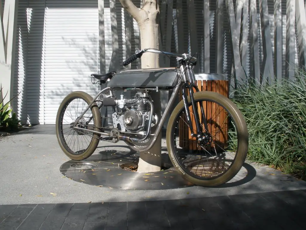

Update: I had a few things I need to take care of to be happy with the bike. I re-did the exhaust one more time trying to keep the db down, It's solved now.
I made a support bracket for the carb and also found that the intake gasket was leaking, replaced the gasket. It now runs real good. I changed the main jet, what a difference in the way it pulls.
New front motor mount....it' A Must
I think I may be done now...well maybe

I dig the crazy crank and new brackets. Those muffs add a nice low tone, it's perfect for the mid-size engines. Looks great as usual Jeff!
dnut
AWESOME! AWESOME!

beauts! She looks better without the flywheel fins, for sure.
Yes CCC, that flywheel looks a lot better without the fins. How did you do that? Is that a different flywheel, or did you modify the original? I am running a Briggs engine right now, but I have considered using the GC160 for the ease of finding parts.
Also, your whole bike looks awesome.
Gilbert
That part is plastic and removes very easy, take the nut off that holds the flywheel and remove the plastic fan, put the nut back and torque it down. I did change the starter hub to a smaller one.
Get that 160 and I will help you install it if needed.
