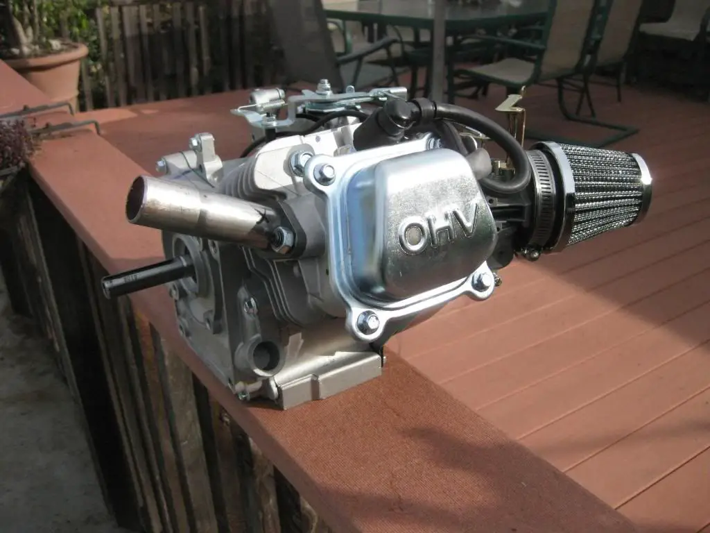

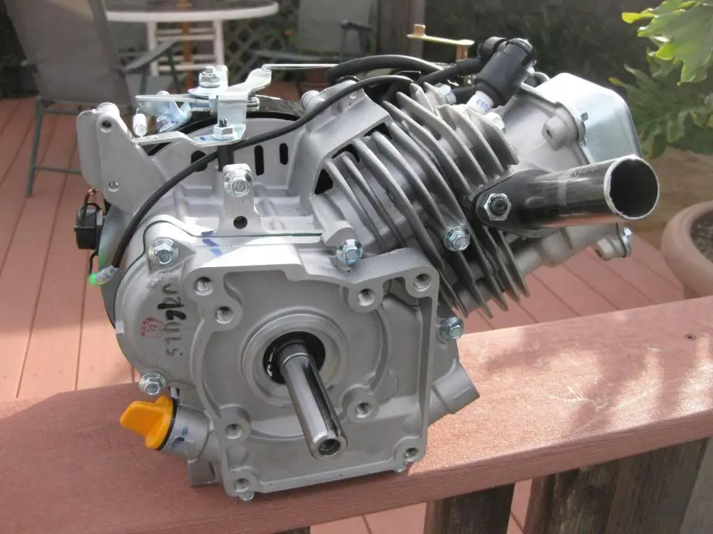

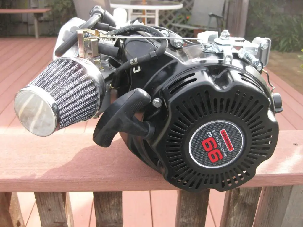

Nice Hefe! I started my 99cc today for the first time to see if and how it runs before tearing down and cleaning it out. Ran it for 5mins. and it runs like a champ. Let the build begin! Some pics from today......
I'll be starting a thread on the build soon enuf.......can't wait!
EDIT: dmb Dennis, this engine is going on the "not to be blue much longer" Dyno that you gave me, thank you very much bro, yer gonna like it!
hey bro! looks like you stole a zommie off a sbc. dont start a fire! dennis
I call it the "flame thrower"! It's just a flange w/1" stuck in it.....it will grow from there and will hopefully be kinda quiet for street use. That's the plan anyway.
Now back to Jeff's work of art and craftsmanship......
