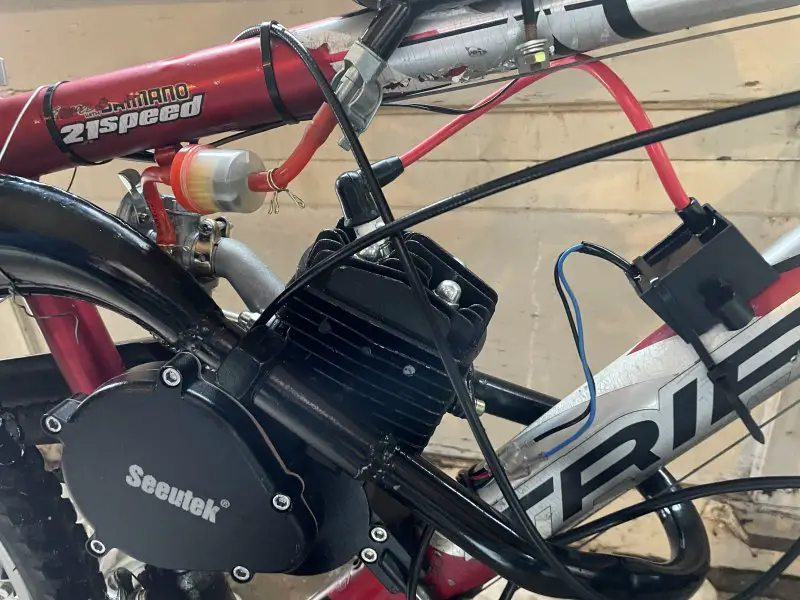

Ok, fuel is now at 32:1. We have good fuel flow, fuel bowl fills. Still no ignition. Let’s assume we have an airflow problem here. A photo is attached showing the whole bikes setup. If there is an airflow problem preventing fuel and air from getting to the spark plug, what can be done to address that beyond what has already been done? I have cranked the engine cold and then checked the plug, there is an odor of fuel, but the plug is not wet with gas moisture. Any suggestions here?

I'm looking at the picture... Put that choke lever DOWN or the bike will never start!!!
