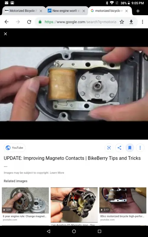

Thanks for the suggestions! I don’t think gas is getting to the cylinder. Spark plug and piston are always dry it seems whenever we have opened it up. Not sure why. My suspicion is gas is not getting there for some reason. Have also put some gas in the cylinder directly under the spark plug, for a time this started it but it would not stay running. Now it doesn’t start at all even with that. I will also mention that I believe there were gaskets under the intake manifold and the muffler connections, but those have deteriorated and are gone. Could this be a source of air leaks even if the connections are tight? Magnet has never been removed or adjusted.

While you’re working on it remove both side covers, there’s a seal on each end of the crankshaft, look for fuel, especially the left side behind with the magneto. That seal is thinner than the one on the right, I’ve had problems with that seal on one of mine. If you don’t find fuel it would be hard to see if those seals were leaking.
