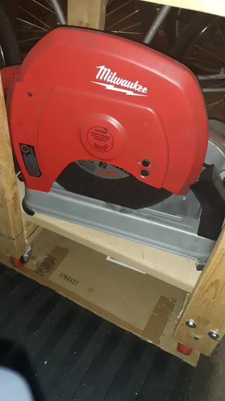

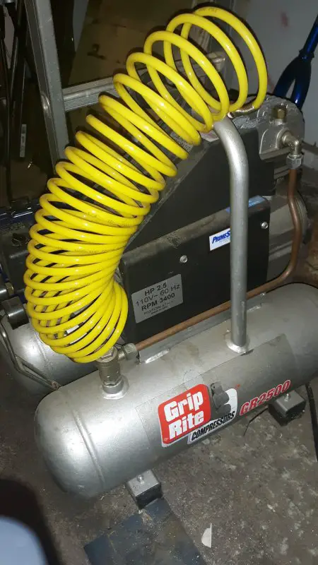

A couple of tools which I find very useful, are a Milwaukee chop saw and an air compressor. The saw I don't use often, but the compressor I use continually to keep swarf cleared from my machining activites, especially drillpress, lathe and mill. I have a really high quality nail gun compressor, but for the activity described it's total overkill. An inexpensive vibrator type from Harbour freight would be perfect, if this is the only task you need it for. Mine is also used todrive a Chinese inverter type 80 amp plasma cutter which is an air hog, but they work well with each other.
Safety glassez are a must all the time but blowing swarf is really an eye danger. I turn the pressure reall low, 20 lbs or so on a 160 lbs compressor and the small hot dog tanks supply enough air at that reduced pressure to not require much compressor activity.
Small machines become way more useful when operated with basic big machine aids, including air and apprropriate cutting fluids for the material and tool being used.

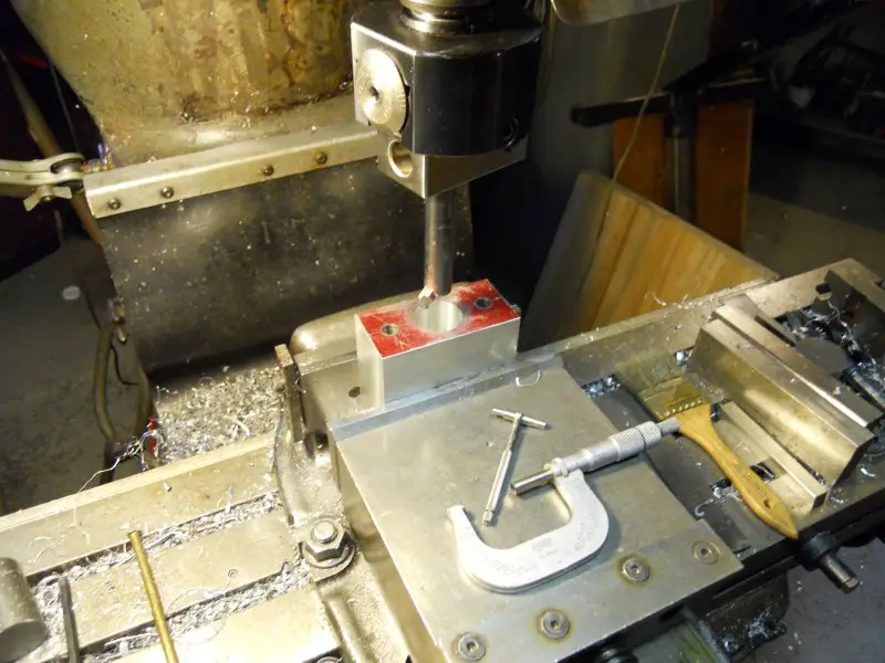

Been machining aluminum engine mounting blocks to clamp a 79cc predator to the seat down tube of my Huffy Davidson repower and upgrade project. (1) Huffy Davidson | Motorized Bicycle Engine Kit Forum (motorbicycling.com)
The 1.156" dia. seat down tube bore was finish sized with my genuine Bridgeport boring head pictured. Just ignore the two other .377" dia. holes. Drilled them in the wrong damm axis. I've heard it said it could happen to a good man too. Wink. I am so used to just doing things in my head, which rarely fails me. Wink again.
I really should load an old version of student Surf CAM. For the record. Solid Works has a inventor suite for only $100 a year. Tempting.
The block I bored will be slit sawed in two equal parts which when split will be split in half again make two complete mounting block sets.
