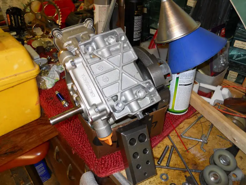

Cleaned up the 8X1mm mounting threads in the base of the 79cc Predator engine, Lot of residual loctite.
I think I have about come up with a firm plan for the primary seat tube mounting clamps. Instead of screws driven into the engine base I will grade 8 threaded studs into the engine block with which fastening nuts can draw the mounting clamps to the seat post. A full 20mm of stud thread in the engine block base with only straight line drawing force exerted by the clamp fasteners.

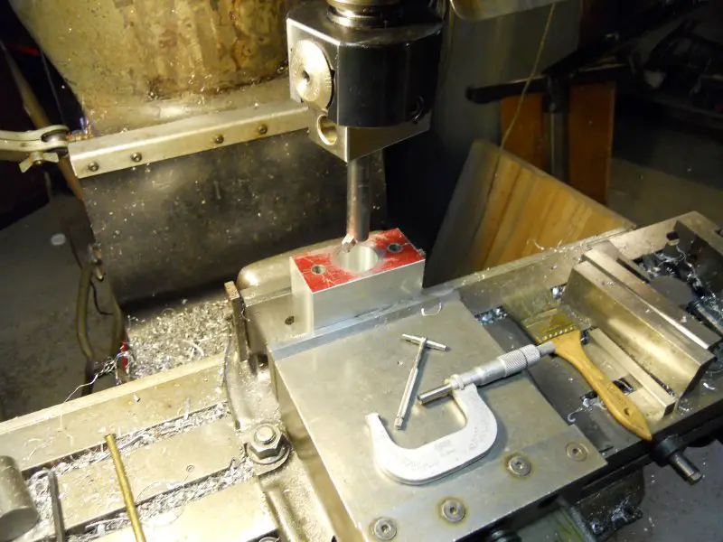

In the shop today to rethread the engine mounting bosses. 79cc Predi engine mounting boss is threaded 8X1mm.
Threaded grd.8, grd5 rod is pretty much unobtainium in that diameter and pitch. My plan is to install threaded studs in the engine block instead of bolts drawing into the cast aluminum block.
Looking at thread charts 8mm =.3145” is just two thou bigger than tap drill size for a 3/8-16 tapped internal thread. There is all sorts of 3/8-16 threaded barstock. Next trick was to enlarge the mounting bosses to 5/16” dia. Keeping the bores straight and square to the engine base by hand. Good luck on that one right? Enter a hand tap guide block. I am dating my self, but before pantograph air driven tapping machines or even older hand crank tapping guides. Hand tapping of any degree of squareness to a given bore was performed with a tapping guide block. The guide block served twice in my application. First to truly guide a 5/16 reamer to resize the boss mounting holes and then to truly guide the 3/8th tap to cut new threads.
3/8-16 being a common thread size should make it easy to find hi tensile studs.
Below the engine is the reamer/tap guide.

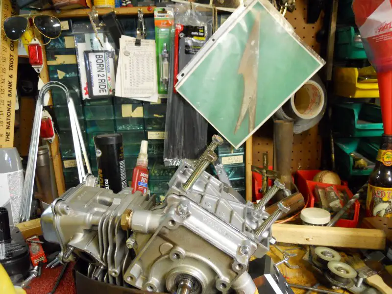

Went to Hong Kong Hahn, my sarcastic name of the local Ace Hardware store. they have a full complement of full threaded Grade 8 bolts. The four I purchased are just exactly 1/2" short. Remember I have to cut off the heads to make them studs. Back to Hong Kong Hahn tomorrow..
