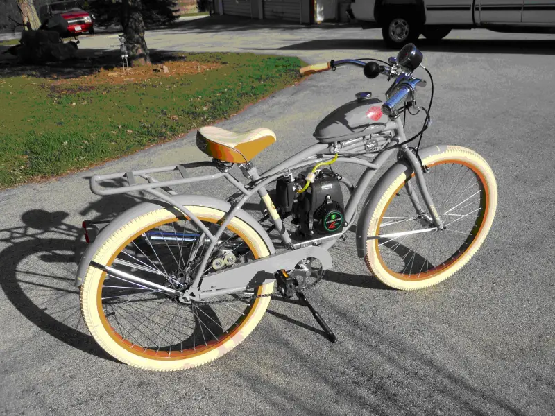

The bike first I built, a 2016 Huffy Classic. It worked until July of that year when all things Bike Berry took a chit. between rag joints and engine mounts.
It worked.
Sort of. Chain line from transfer case to wheel sprocket, was never right.
Two things cause that. Rag joints are fixed, and engine mounts were engineered for late 19th century Safety bicycles.
The off shore manufactures just kept selling engine mounts for that style frame, disregarding the Huffy Beach Cruiser frame dimensions.
Imported 415 chain stretch, Junk and the junk Huasheng stock carb. No Bueno.
I have a NT carb and manifold,
This is a work in progress. A proper engine mount of a 49cc Huasheng engine, will be task #1.

All stock but the gas tank. I emailed Huffy and got a paint number which I cannot find at present.
Gas tank was done with Krylon Classic Grey/gloss. Somewhere I got the Huffy number.

The Huffy is currently powered with a 49cc HuaSheng engine and BBR reduction transmission which works just fine.

The Husky front wheel is fitted with a Sturmy Archer drum hub brake and comes complete with all fork fittings for proper brake function.
So there comes the plan. A stock Huffy Beach Cruiser is a tolerable ride. Powered to 35mph ? Suffer.
1. I don't intend to keep the machine, so the Law of Diminishing Returns is a factor in sale or gifting.
2. I have a 2016 Monark II NIB that was intended for my Flyer build which would improve riding comfort. But on close examination the fork has no provisions for attaching a fender at all or hub brakes! The stock photos of all Monark builds are fender less.
3. I think regrettably the stock rigid fork will stay and so keeping the stock fender.
4. Rag Joint mounted 31T drive sprocket on the Huffy rear wheel, has been powered by a BBR 49cc HuaSheng engine which has had enough steam to make 35mph in a head wind.
5. Removed the engine for now. Universal BBR engine mount is getting binned in favor of a custom engine mount designed expressly to mount to Cranbrook frame tubes and a perfect chain line from the transfer case to the drive sprocket.
