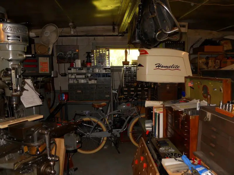

Tom you've got a good looking Bridgeport. Did you have to rebuild it?

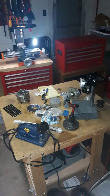

Lights have really made a difference in the shop. 8" round led's for camera use put out a nice adjustible light source with no flicker and are dirt cheap. The sewing machine led light on a magnetic base, with goose neck is a really useful light source which can be placed wherever needed quickly.
"I can see clearly now" ...
It is amazing what a well lighted working area does for pleasure of work.

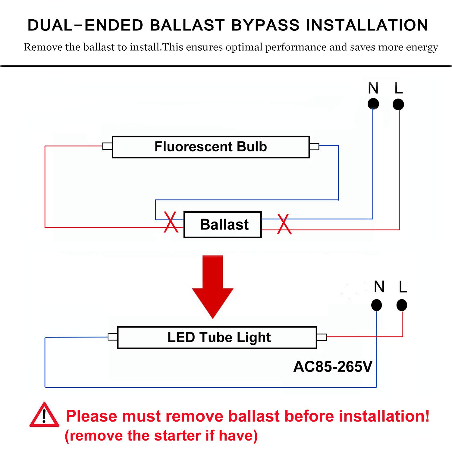

Get Leds instead Rick much better light and instant on, 2 tube 4' are cheep now. Everybody around here is changing to them because of the no waite in the cold weather, and the light is just brighter..........Curt
Yeah, the only problem is all the florescent fixtures aren't compatible with LED's. But my dad (who is an electrician) showed me a way to bypass the ballast of florescent fixtures to make them work with LED's, so not entirely impossible. Here is a diagram found:
See the source image
