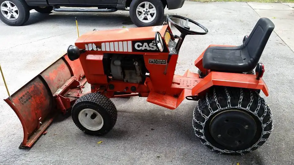

All powder coated and waiting on tubes. Have a nice Case 224, with no motor for the project.
So how is Mona doing? ...........Curt
LOL ! got the tires for $10 each at swap meet, been planing this for a long time. Case 224 garden tractor, going to turn it around so the drivers are up front for traction. Easy to do because its a hydraulic drive, goes the same speed either way, already have a 48" 2 stage blower from a Bolens, twin Onan motor, just got to do it..........Curt
Not this one but one like it

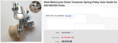

Ordered one of these chain-tensioners just to try out and it looks promising. A fella couldn't buy the parts and fabricate this
for the price! The picture shows it in use tightening the slack in a chain from the bottom, I went ahead and reversed it so
it was tensioning was on the top chain. Usually, the chain tensioners are taking slack out from the bottom of the chain.
Any input on this from you guys? I am sending a link and price on this thing on Ebay.

From my experience it’s not for the top chain run as you said, it is to reduce the slack created by engine torque tightening the top run of chain. It will take a strong piece to withstand the pressure.
I don't know, I've seen several builds with it on top and I am curious about the configuration. Here is a fella that has a build
that is interesting and his frame is a SOLID ONE! ;) YouTube Video

Yes Greg I've mounted both ways, and the bottom (return side) is far superior. Top mount puts extreme pressure on both the chain & tensioner. The tensioner that bolts on the chain stay (as many do) can twist under pressure into the spokes. OOwch! So why did I mount mine on the power side (top) rather than the return side? Just an attempt to keep the chain from rubbing/slapping the tire with power off...power on it just cleared, power off it rubbed. I eventually went to narrower tire and put the tensioner where it works best,,,but I've also seen nice bikes with the tensioner up top...hope they didn't later regret it or blame chain breaks on poor chain quality.

Nice tensioner Dennis, and you are right about price.
My vote is to mount on supply side.

That has suspension on the rear, can't be solid. When you put torque to it the top chain gets like a bow string, really tight. Would almost think it would bend or brake, otherwise......Curt
I mounted it once like that and I think you guys are right since the chain will tighten more so against the spring and idler.
Then, looking at it if mounting it like it should might take some fabrication on it to get it right.
Dennis

Yes, Rick I checked the chain tension and it takes more spring tension but then when power is taken off the engine
the bottom of the chain will want to flop around, bad for wear on it and the sprockets plus on alignment of the chain.
