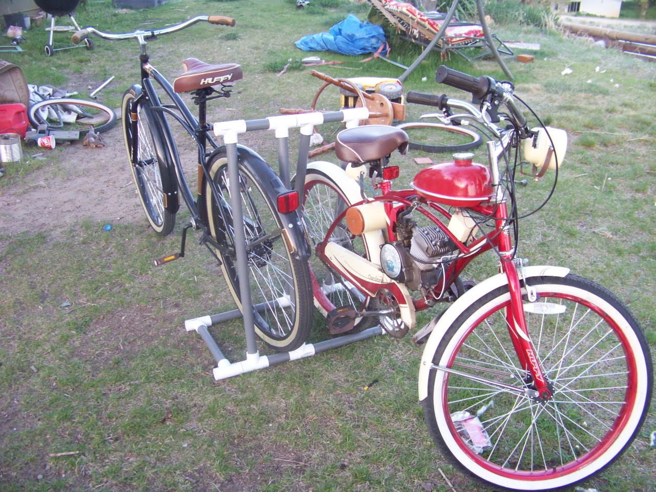

    Here we are- it turns out I miscalculated by two lengths of pipe, but here you see the pattern. Easy to figure out- the uprights are 30", the spreaders are 12" and the rest is cut to fit. Figure 10 "T" joints and one 20' pipe per bike, minimum of two. This took me about a half hour to do and was no challenge whatsoever

    Looks good sarge, you could even put some of the foam pipe insulation on those upright support pipes and then the bikes finish would be protected if you wanted, good job and another good use for pvc pipe.

    Been using this built from scrap lumber glued, screwed then varnished for a full 3 years now in the shop.
    [​IMG]
    It will hold any bike from the lightest 24" to biggest 29" with big gas motor without failure even while working and beating on the bike in it.
    PVC even indoors like this would have bent and broke by now considering how many bikes have been and out of it every day, day after day for years, outdoors in the sun PVC turns to brittle garbage at least here in the desert Southwest.
    Yours turned out nice but when it crumble consider wood.
