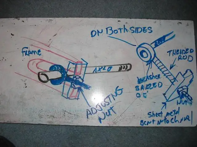

    your going to have to make a axle holding device like is on a motorcycle sound like your yanking the chain and it in turn pulls the axle loose maybe I can draw you what it looks like on a motorcycle and you will have to modify it to fit your needs picture coming I got to get the etch a skech. this down and dirty

  5. deacon
    deacon minor bike philosopher
    Joined:
    Jan 15, 2008
    Messages:
    8,119
    Likes Received:
    Norm I got a couple of those things from kids bikes that hold the axle I'll put one of them on.
  6. Norman
    Norman LORD VADER Moderator
    Staff Member
    Joined:
    Jan 16, 2008
    Messages:
    2,605
    Likes Received:
    you understand then. goood use one on each side. it will work better.
