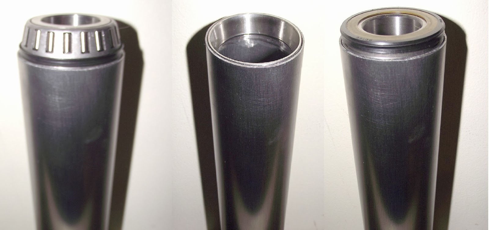

Headtube:
Size: 2" OD x 7"
Cost: $3
Bearings: 78' Suzuki SP 370 (could just as well be ANY motorcycle make or model though) - Tapered Roller
Fork Crown:
Type: 78' Suzuki SP 370 (could just as well be ANY motorcycle make or model though)
Cost: $9
Life's too short to be dinking around with bicycle bearings and wondering whether or not they will fit or even work.
Did the bearing race just plop inside the tube like it was custom made? H3ll no it didn't...... but it's in there now. dance1

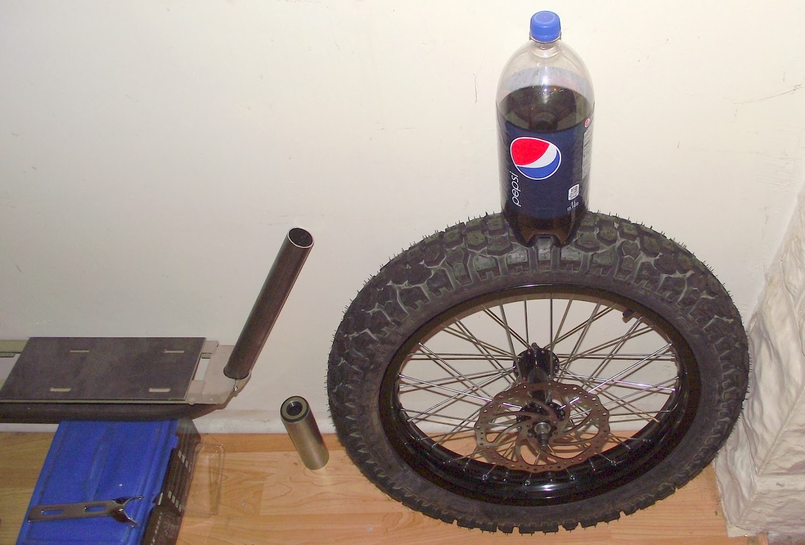

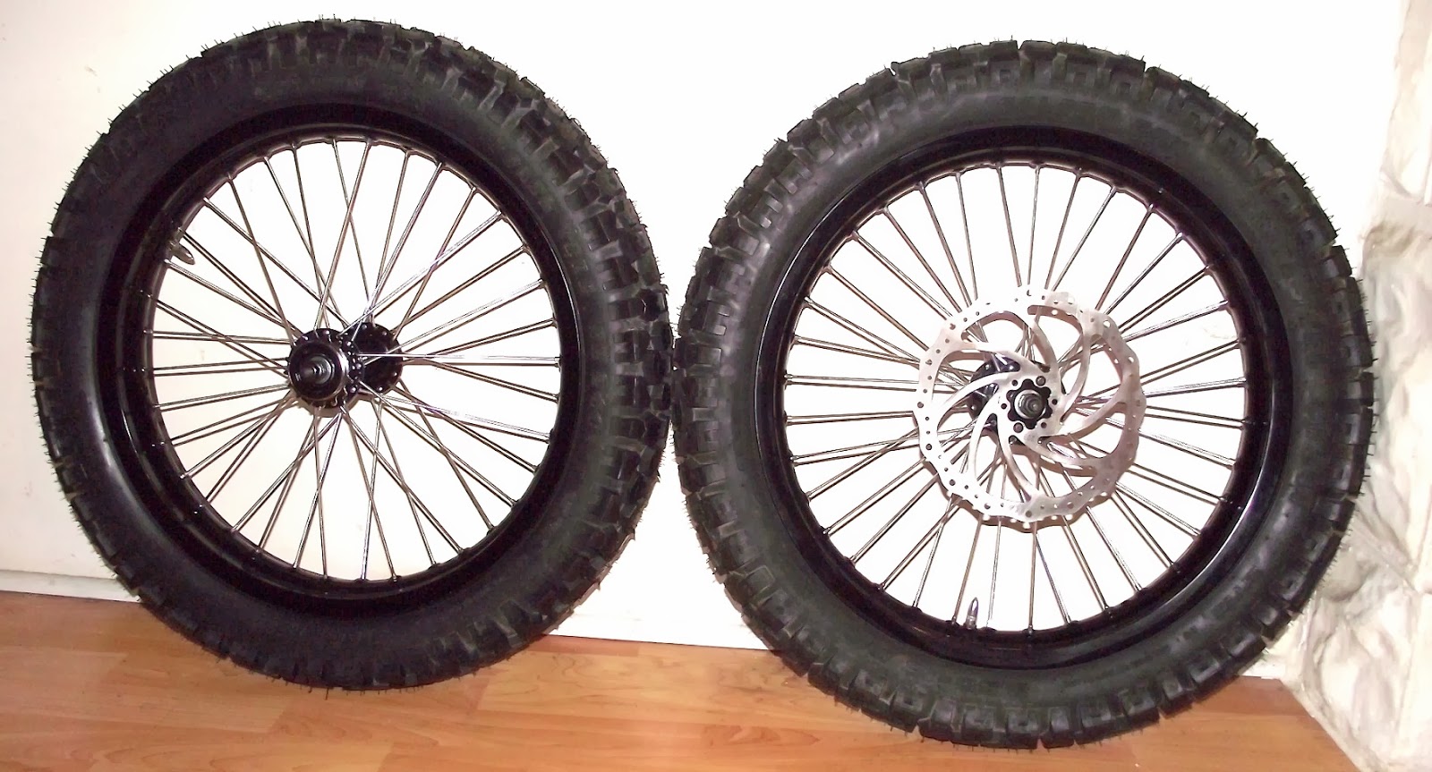

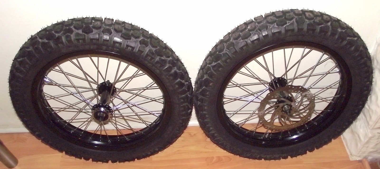

I don't know what to say about this front tire other than I think I lost about 5 lbs of sweat getting it mounted on the rim. What a PITA. Lacing and truing it was a walk in the park by comparison.
I'm too tired to type anything else after that all day affair.
miked826
Aug 6, 2011
1,748
7
Los Angeles
Tire looks good! Some of these are pretty rough lol. I have been at war beforelaff:-||
Goat I'm at war with the Streets of L.A. and I intend to win it for good this time! I'm not talking about cagers, I'm mean the actual streets themselves. They almost killed me on my last bike. Luckily I only got a bloody ankle and a badly bruised ego out of that skirmish. LMAO
Combined Load Bearing Capacity:
At max. 32 PSI - 988 lbs.
Combined Weight:
40 lbs.
Total Combined Cost (everything as shown):
$375
Speed Rating:
93 MPH
Tire Height:
25.5"
Time to complete the 2nd Wheel:
1/10 the time of the first wheel. WINNING!

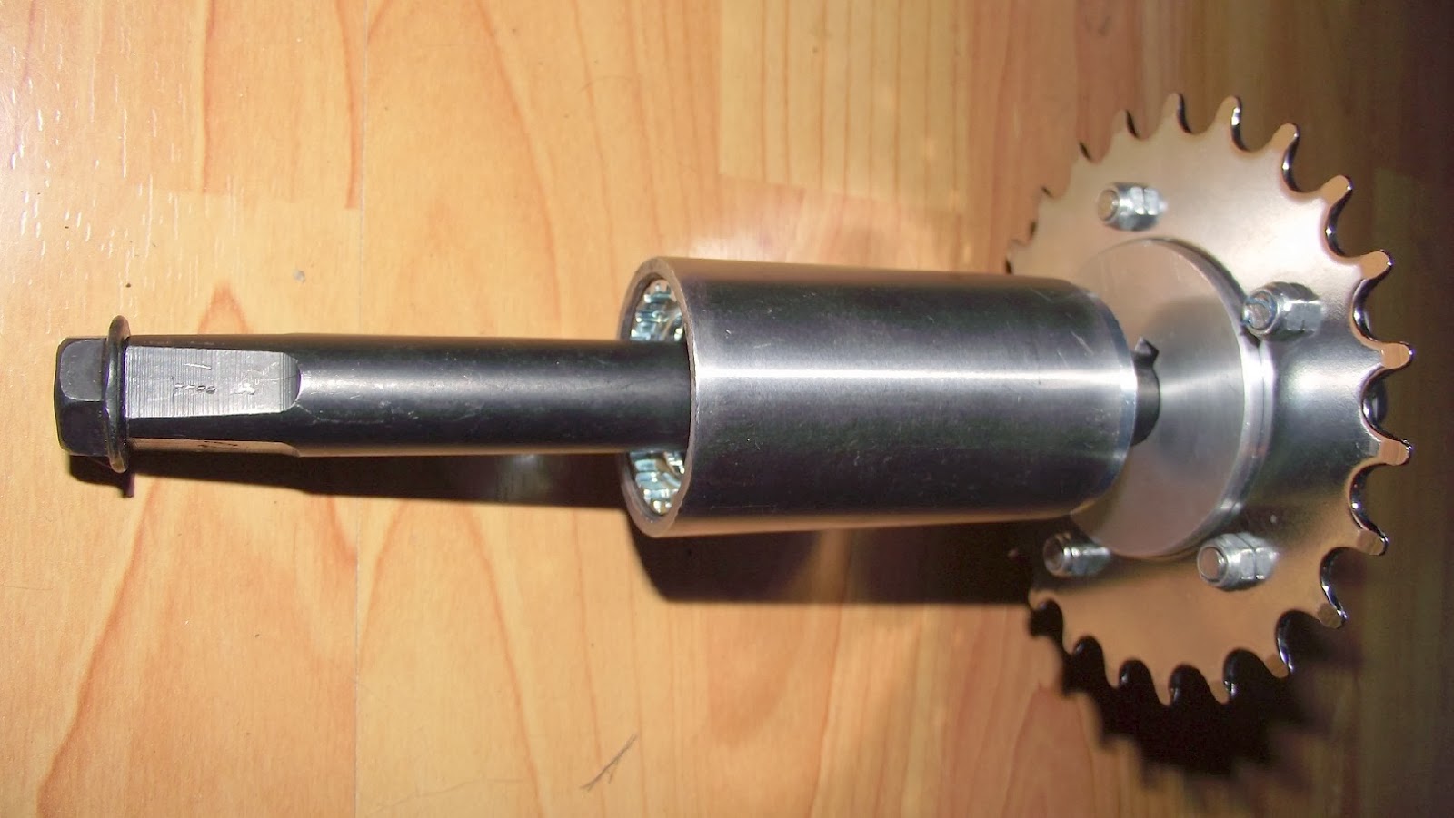

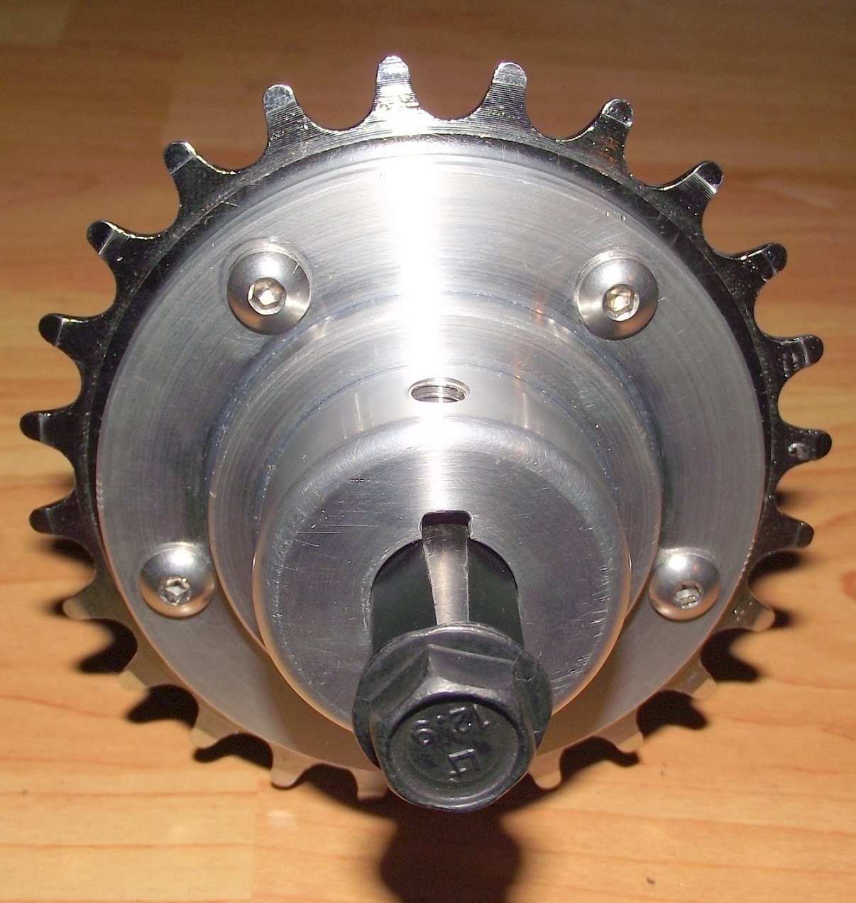

206mm Axle with a 24 Tooth Billet Chainring Bling to clear the tires girth on the pedal side of my motorcycle.
Yes officer, this is a motorcycle that you can pedal. Yes I realize the chainring is the size of a coke can officer. LMAO

practice makes perfect!!!
lookín good mike--
just curious --can a fancy tire shop hydraulic tire machine mount tires such as yours on such a rim????
miked826
Aug 6, 2011
1,748
7
Los Angeles
lookín good mike--
A car tire mounting machine would not work or a motorcycle tire mounting machine either for that matter. I'm rolling on bicycle hubs so a machine doesn't exist that I know of for bicycle hubs. There's a spindle that goes through the center of the hub for cars and motorcycles hubs, so neither machine would work.

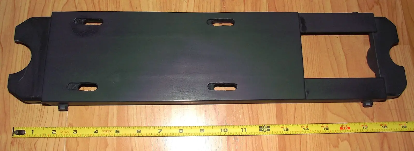

Mike.....what engine mount is that and is it self-fabricated? I'm asking because it looks like it has some length to it....
Mike
You are correct. It is lengthy. Got it off ebay. 12" x 5" x 1/8".
http://www.ebay.com/itm/Honda-Motor-Mount-Plate-Engine-Plate-Go-Kart-Racing-Briggs-Animal-Engine-Clone-/190770569312?pt=Race_Car_Parts&hash=item2c6acfe060&vxp=mtr
The other primary mount is a standard motorized bicycle 4 Stroke mount with the plate removed and replaced with 1/8" Angle Iron cut to 16" to allow any motor to be flat mounted. I don't need no stinkin' fancy billet mount clamps or crazy engine mounting angles. LOL

IT AM WHAT IT AM, AND ALL IT WILL EVER BE.
Stretched, drilled, welded, and painted. Flat mansion sized real estate for anything and everything.
