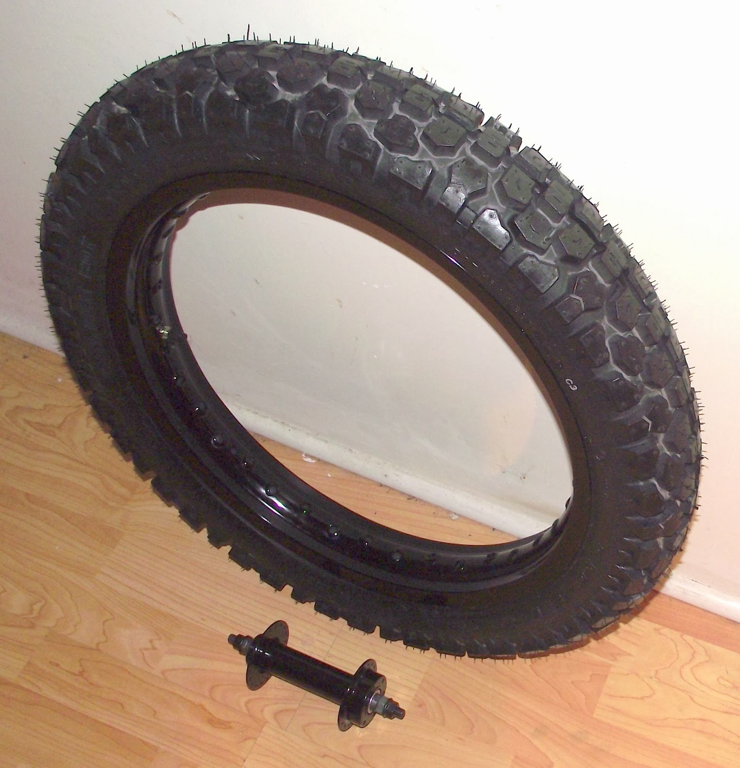

Tires and rims are here. I'm 195 lbs. and the tires sidewall is so stiff that I can sit on the tire, with no rim or tube, and it does not collapse with me on it.
Rim width lip to lip is 2.875"
Tire knob depth is .5"
Tire width across the knobs is 3.7"
Tire diameter is 25.6"
Tire cost is $44
Max load per tire @ 32 PSI is 494 lbs.
I now have some decent built-in shock absorption. I'll be Comfortably Numb.

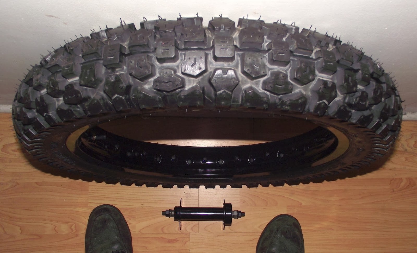

THE ULTIMATE DRIVING MACHINE.
Width across the knobs inflated: 4.125"
Height inflated: 25.5"
Weight guestimate: About 2.5x normal bicycle tire/wheel weight.
# of pedal gears: 1 freewheel
And no I don't have small feet. It just looks like that next to that tire. It's an optical illusion. LOL

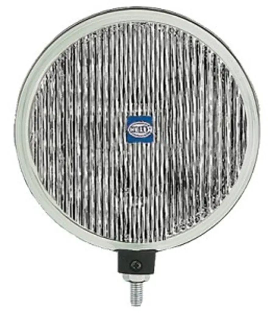

Tapered roller bearings for Suzuki SP370 forks: Check
Tubing bender / Wallet deflater: Check
Hella 500 headlight: Check

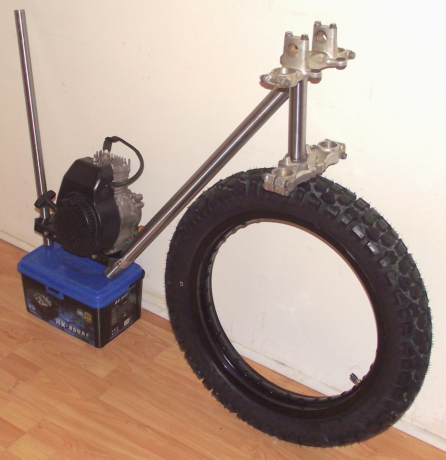

CLEARANCE ISSUES? WHAT CLEARANCE ISSUES DO YOU SPEAK OF? LOL
AND YES IT WILL HAVE WORKING PEDALS.
Seat and Down Tube not cut to their final length and Down Tube needs to be bent as well.

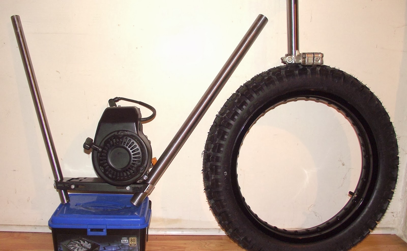

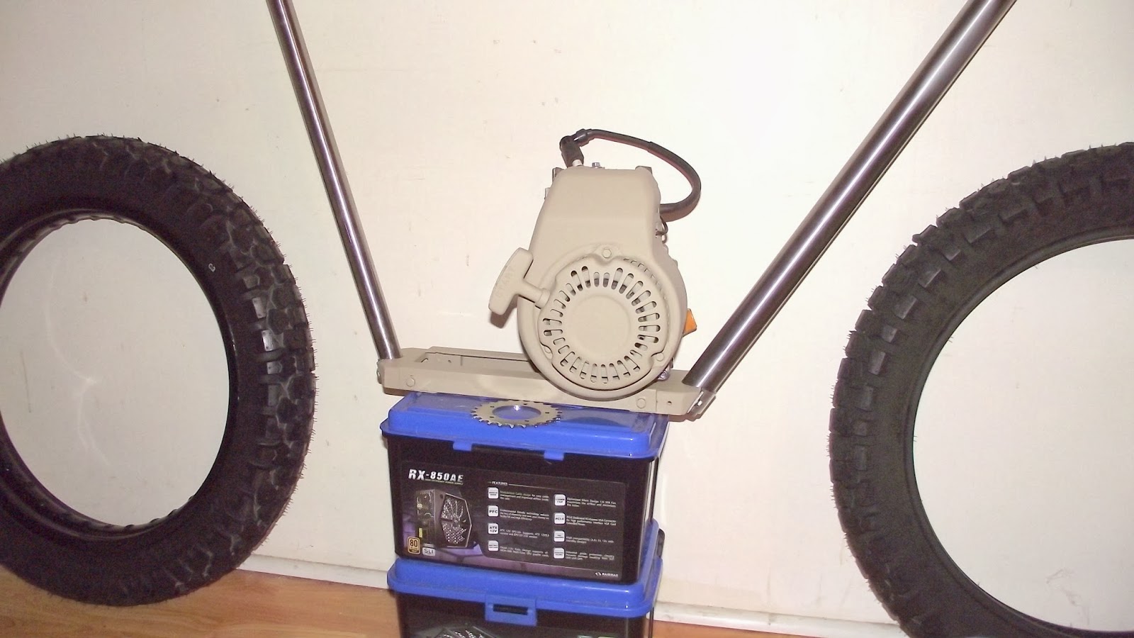

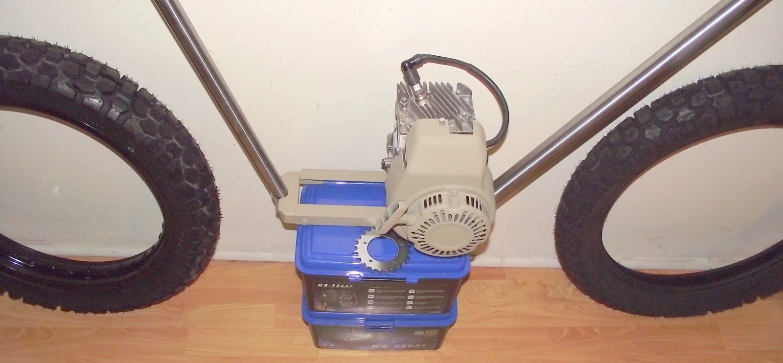

14" of horizontal real estate at the base of the mount. WINNING! LOL
Gonna slap a 12" x 5" mounting plate on top of that mount and weld it in place.
Desert Rat camo paint scheme.

I had to add another 4" in length to the mount so it wouldn't interfere with the bolt pattern of the 212 at the front the mount. So 18" gets me 15" of useable space at the base of the mount. That should do me.

I got's tubes lots of tubes. <1mm walled paper thin bicycle tubes and .065" DOM walled tubes. .120" walled DOM tubes are normally used on custom made motorcycle frames. .065" is unbelievably heavy at 1.5" diameter and is the thinnest my bender will bend without crushing it. So that's what I'm going with.
DONT BUY BICYCLE METAL TUBES. They are scary thin and look like a nightmare to weld.

With that bike I would use .085 to build it. With the motor and wheels you really want it to be stout with no frame flex. You may even consider .120. I have a really nice bender at work that you could use but it only does 1 in and 1.5 in. Let me know.... Jeff
miked826
Aug 6, 2011
1,748
7
Los Angeles
Looks like I'm gonna be a human crash test dummy again, cause I already got .065" everything but the tubes are all oversized. My bender only does 1 and 1.5" as well. I also got 1/4" plate for the dropouts.
Tubes are already bent with only notching/welding left to be done. The motor mount you see is NOT the only thing holding the seat tube to the down tube. The down tube continues running underneath the motor mount all the way to the chain stay tubes.
11 gauge spokes and nips are on the way.
The only thing that scares me is the welds holding up or at least giving me a little warning ahead of time if they do in fact fail. I don't need a lot of warning. Any warning at all will do. I won't have far to fall. LOL
