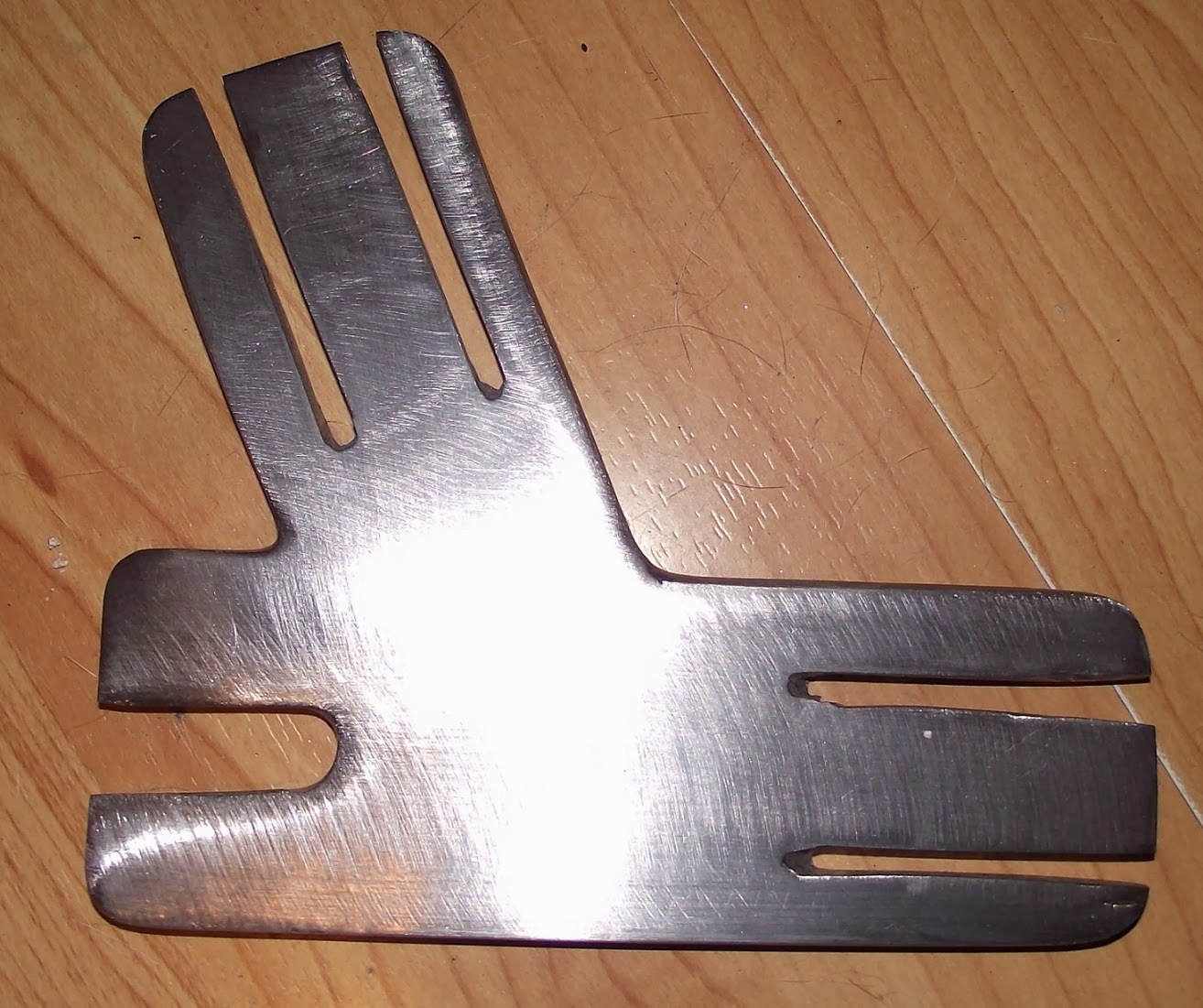

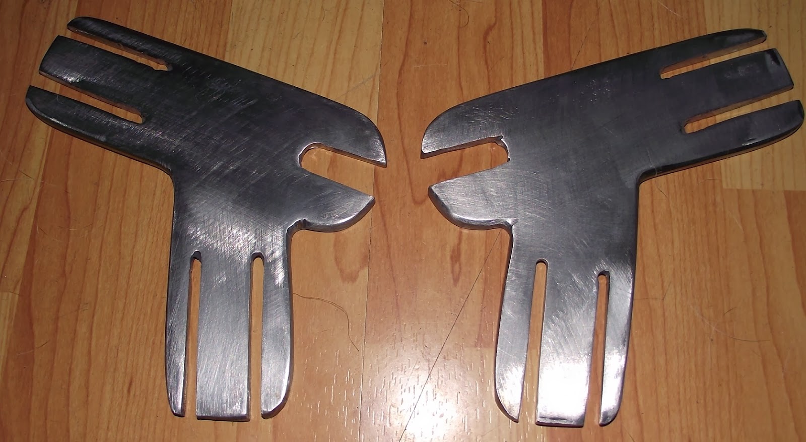

What's that you say? You say you never seen an obtuse dropout before? I can't say that I have either. Until now. Sure hope it works. Cutting 1/4" plate with a $20 HF grinder is TEDIOUS!

Oh the HORROR of welding 1/4" plate to 1/16" tubing. THE HORROR! Too many amps for 1/4" plate penetration and you risk vaporizing the tubing. Too little amps and you risk no penetration to the plate. I'm not even putting a pic up til I clean up this disaster. laff
If you are talking about the stays to the dropouts, just braze 'em. You have plenty of surface area and it will be mondo strong w/o any worry of melting the steel.
practice practice practice
also--- direction of pistol towards the heavier gauge material might also be helpful--
as well as your pistol movement faster on the lighter gauge /or pause on the heavier
practice practice practice ---- i know you will get it

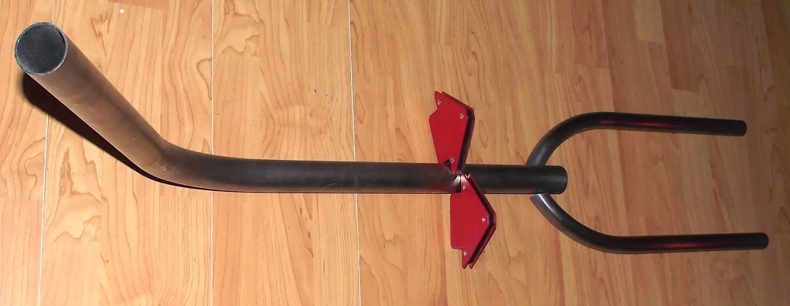

Too late now. Left and right chain-stay and seat-stay are now aligned and welded to their respective dropouts . Tomorrow they will join the down tube in holy welded matrimony. :)
How hard is it to build a jig-less bike frame? It's hard. No doubt about it......but not impossibly hard.

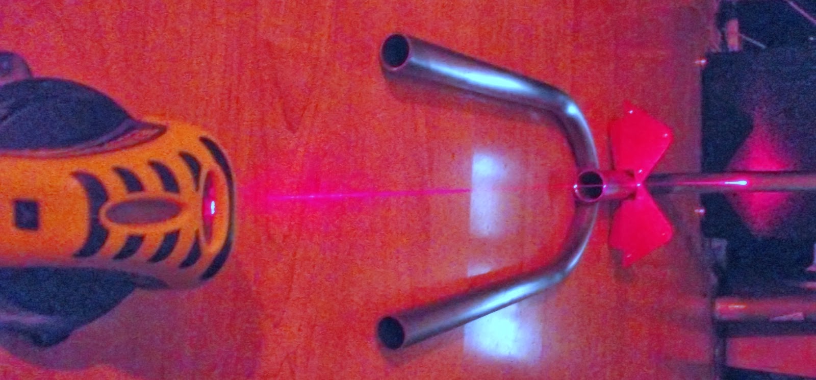

I'm using a laser for alignment......the straightest line known to man. Still ain't easy though. LOL

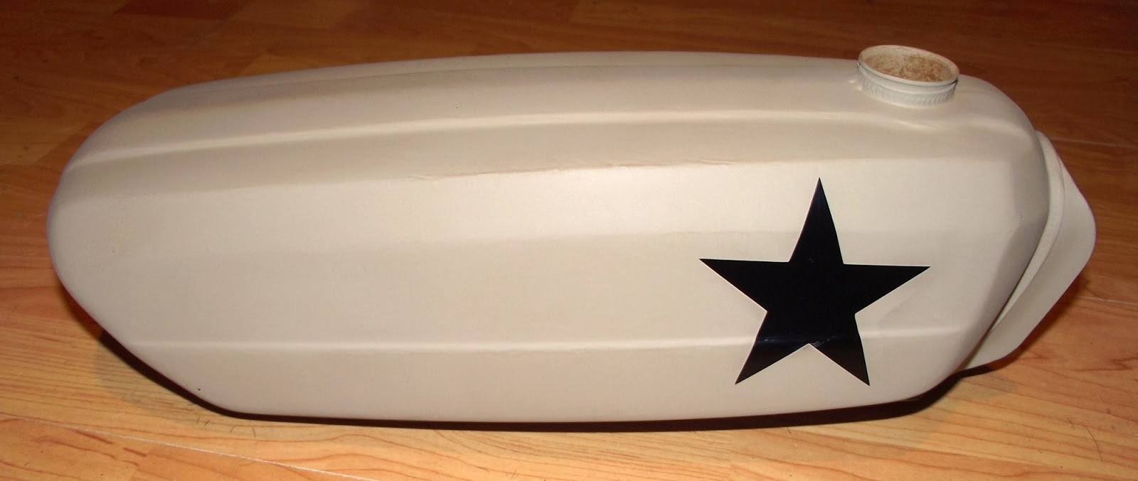

The only redeeming part of a moped? Its fuel tank. Looks vaguely familiar for some reason. usflg
