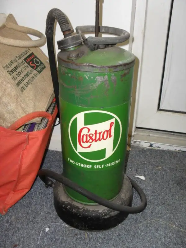

Every Villiers power motorcycle I owned and there were a lot of them needed a coil. The previous owners couldn't figure out how I got it running when they couldn't. The bikes had a cup attached to the underside of the gas cap. This was to measure the oil for a gallon of gas if I remember correctly and the smart owner mixed it in a separate can to make sure the ratio was right.
Pumping an exact gallon gas and adding the oil into the tank and sloshing the gas back and forth by rocking the bike side to side was an art that every owner learned sooner or latter if they traveled very far from home.

The oil is, Aero Shell 65, SAE Grade 30 Straight Mineral Oil.
A case of 12 quarts is $88.22 or $7.84 a quart.
Sky Geek has it.
This is what we paid I think plus the shipping now that I see it. Dave recommended it because this is what the fellas racing vintage 2 stroke outboards use.
The mixing ratio was 25-1.
