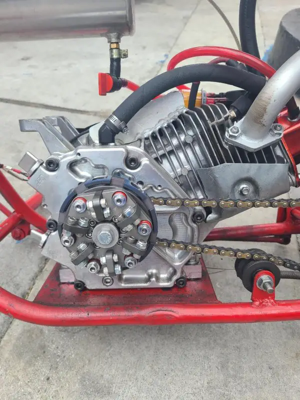

My engine has a vent hose from the top of the case to the valve cover because when I had the case sleeved for the 3" piston, the factory vent inside the engine was filled.
For the 70cc Predator, you can simply run a vent hose from the valve cover to a small 'vented' oil catch can...
In your picture you have the catch can vented to the intake air filter which will work fine.
Here's that pic of my case vent hose... Mine also serves the purpose of extra oiling the rocker arms.

I'm just curious if this actually relieves crankcase pressure? If that pressure isn't relieved, oil will wind around the crankshaft, it will foam faster, and it resists the downstrokes of the piston, sapping power, throttle response, and of course, fuel efficiency.

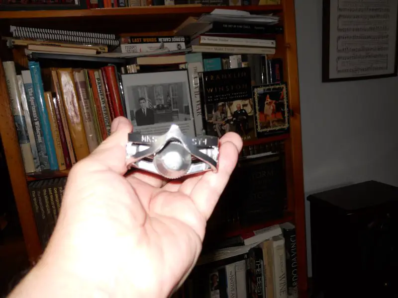

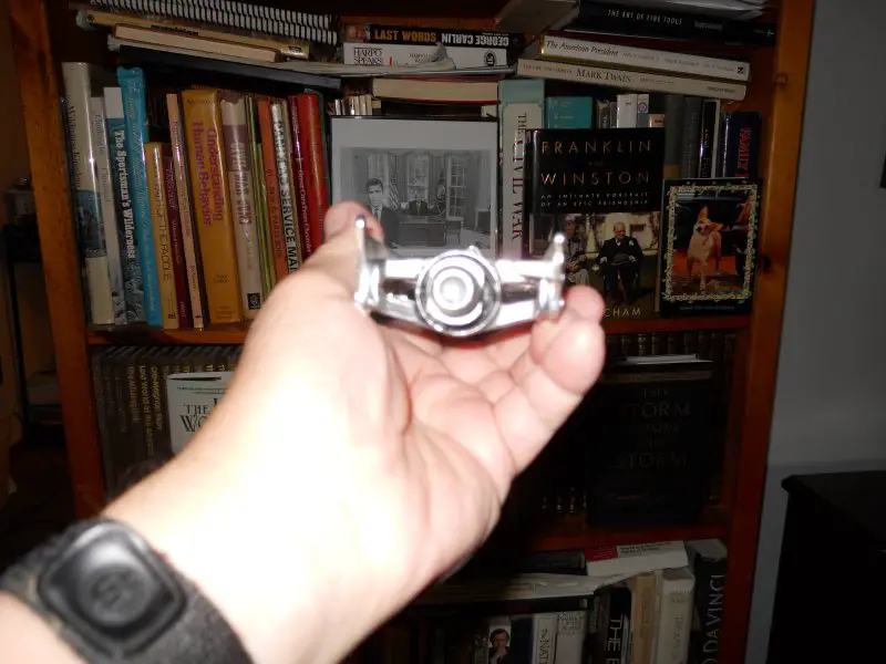

So after all that. back in the shop with a Bernzomatic. Dumkoff me had loctite'd the pedals I wanted to remove. Had to.
Those pedals removed were Campagnolo clones for toe clips and never stood right side up.
Replacements are BMX rat traps with symmetrical foot thread. The clones well serve on my 1972 Schwinn Paramount.

Campagnolo clone pedals, note the asymmetry.
I even counter weighted them to self right. That was a wasted day.
Had there not been beer to keep me cheerful. I didn't get a manicure so don't look.

The new modified BMX pedals are installed without Loctite.
