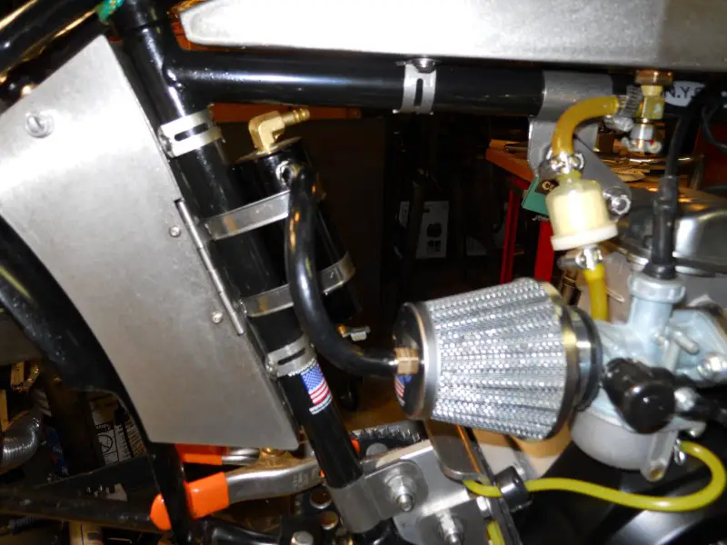

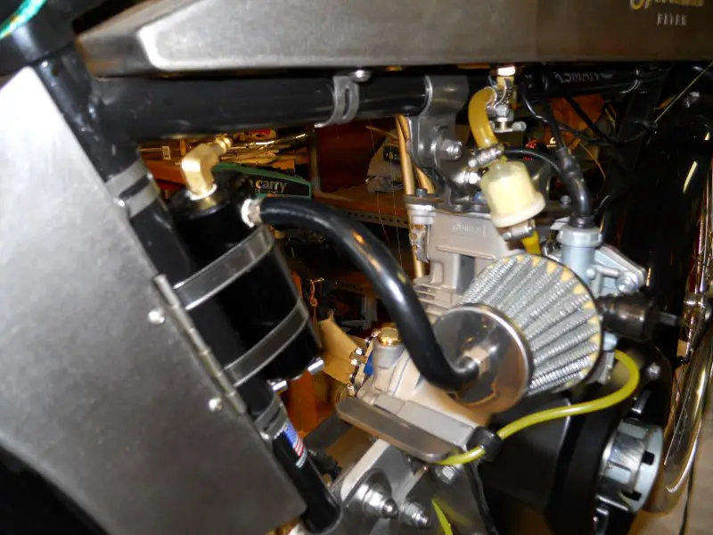

Rainy day, perfect time to plumb the catch can vent to the high flow air cleaner. First operation drill the sheet metal endcap of the air cleaner with a letter Y drill. First I had to modify a lathe arbor to fit the clamping section of the air filter.
Done and drilled. The 3/16 barb 1/8NPT male goes in. To hold it place I needed what would be a 1/8NPT nut.
Never seen one. Plan B, could have used a 1/8NPT coupling but I wanted wrench to draw the assembly together.
1/8 NPT hex end cap drilled thru and pipe tapped a bit deeper threaded together with hydraulic grade pipe dope.
Installed a 3/16 hose barb fitting, replacing the atmospheric catch can vent. Clipped hose to fit. Clamps tomorrow.
Edit. Before remounting the air filter I cut to fit 3/4" thick green filter foam, right where the carb mouth enters the filter.
If I don't like it I will pull it.
