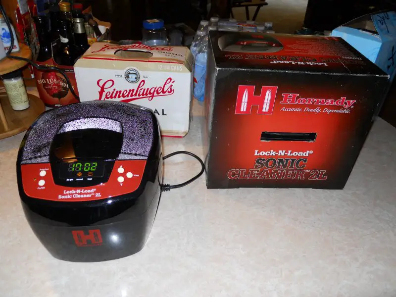

Almost built the hub today. Nagging second thoughts. Think I am going to pull out the Hornaday sonic cleaner and give all the hub internals a soap water buzz, with clear water rinse. Figuratively a white glove assembly. My flavor of OCD.

It is amazing what you get done with a ultra sonic cleaner. Soaking for a week almost in paint thinner, and then flushing with lacquer thinner. You would thing the grunge is gone. Apparently not. Dawn soap water solution in the Hornaday ultra sonic cleaner. Hour later the water has a hue, brownish. drained, rinsed, and toweled. Brake parts loaded into a 200F oven.
In for an hour. Now I am ready to rebuild.

I have had that ultra sonic cleaner for years. Son gave me a gift card from Cabela's during Barak Obama's Presidency.
First choice was .22cal ammo. Hoarders kept that option unattainable. That logic still escapes me.
I also reload. I have a rotary drum polisher. There is always residual grit that is hard to remove, and primer pockets are a especially hard to clean without removing metal. Having carte blanc, the ultra sonic cleaner beckoned me.
Cleaning jewelry will now be more efficient. If I had false teeth......
