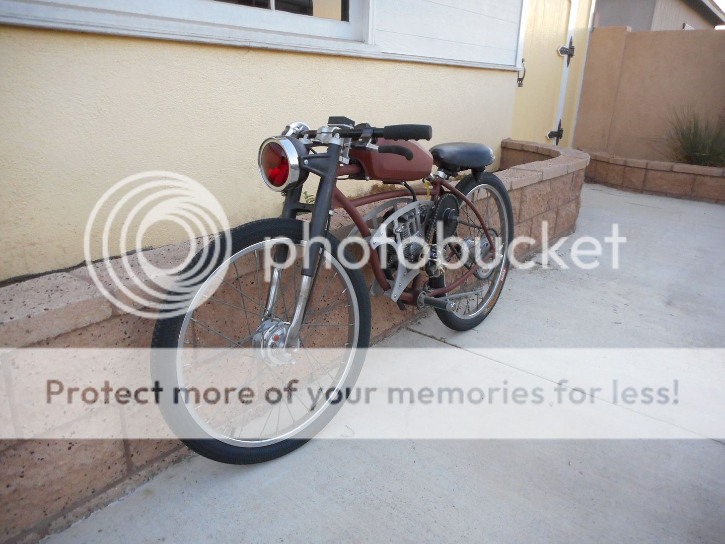

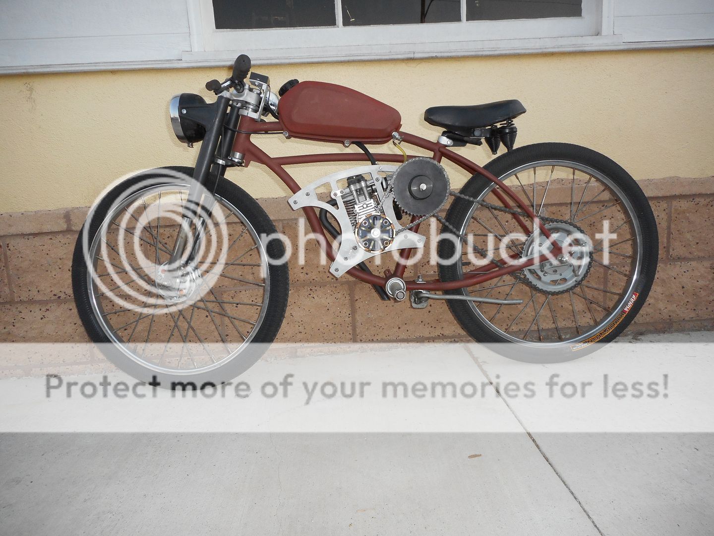

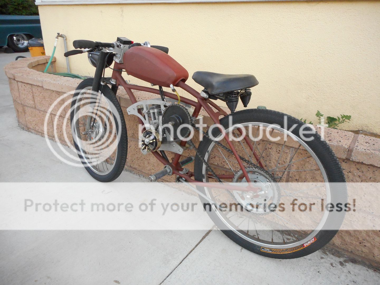

I finally got back on this project. Installed a larger carb from a chain saw and she really came alive. Pulls hard and winds out fine. Now I can change to the 36 spoke wheels I've been preparing. Still need to put pedal cranks on it and some protective guards and be ready to ride it to Donut Derelicts. If it holds up to the 13 mile round trip, I'll strip it down for paint.

Thanks scotto, it turns out it will never be a race bike. The motor affords no internal mods with the headless design and plastic cam. The bigger carb makes it pull about like a stock 5hp Briggs. Also the go kart clutch engages very violently until I lighten or make some new weights. It's made to launch a much heavier vehicle. Like a car with a high stall torque converter. May need more flywheel weight. I'll get it ironed out soon.

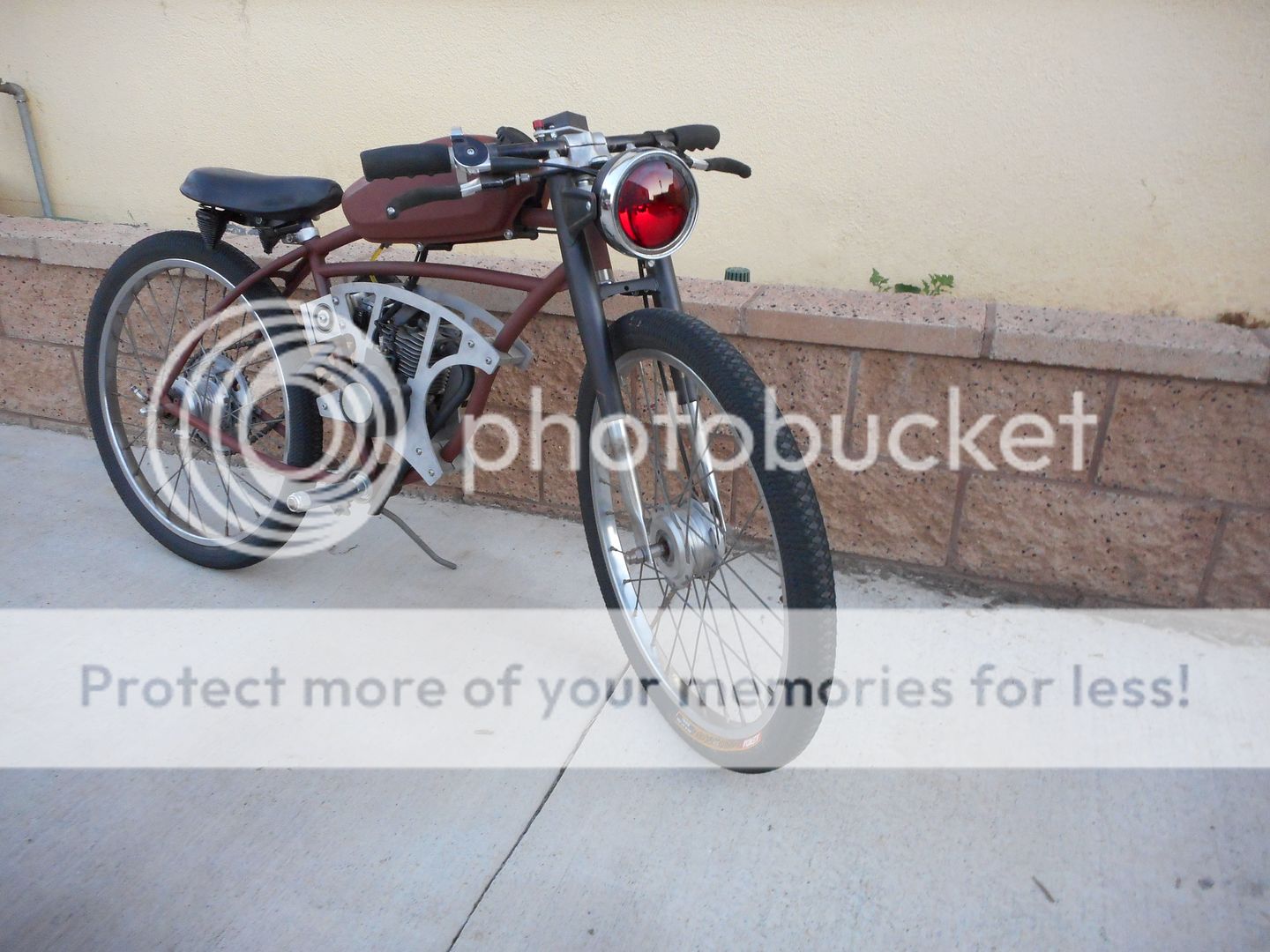

sb, I keep finding throw away lamps at work because everything is going LED. May be a blue one somewhere but I think red is the most risky I'll go. Thanks for all your encouragement and support these past years. It keeps me interested in finishing some of these projects with new ideas and designs.

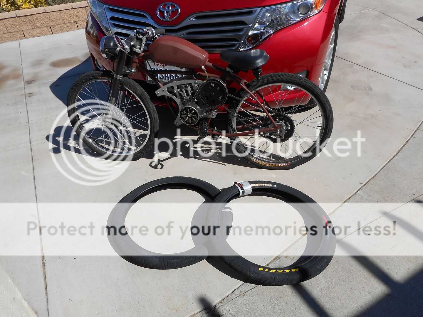

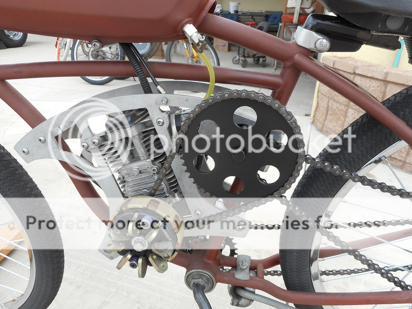

Installed the stronger wheels today. That larger front brake is awesome. I drilled some lightening holes in the primary jack shaft sprocket and mounted the carb more securely. Still have to bend the pedal cranks to clear the clutch and pull starter, make a guard for the primary, beef up the axle adjusters, find some fork rubbers, shorten the jack shaft, make a front brake cable slip clamp, figure out the clutch, etc. etc.

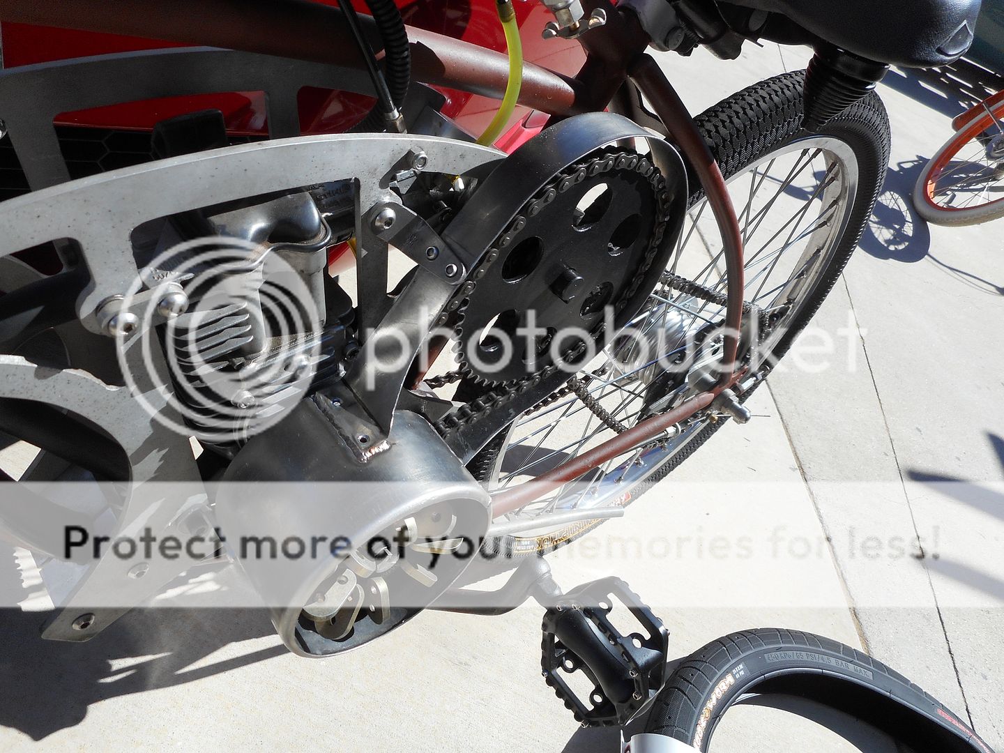

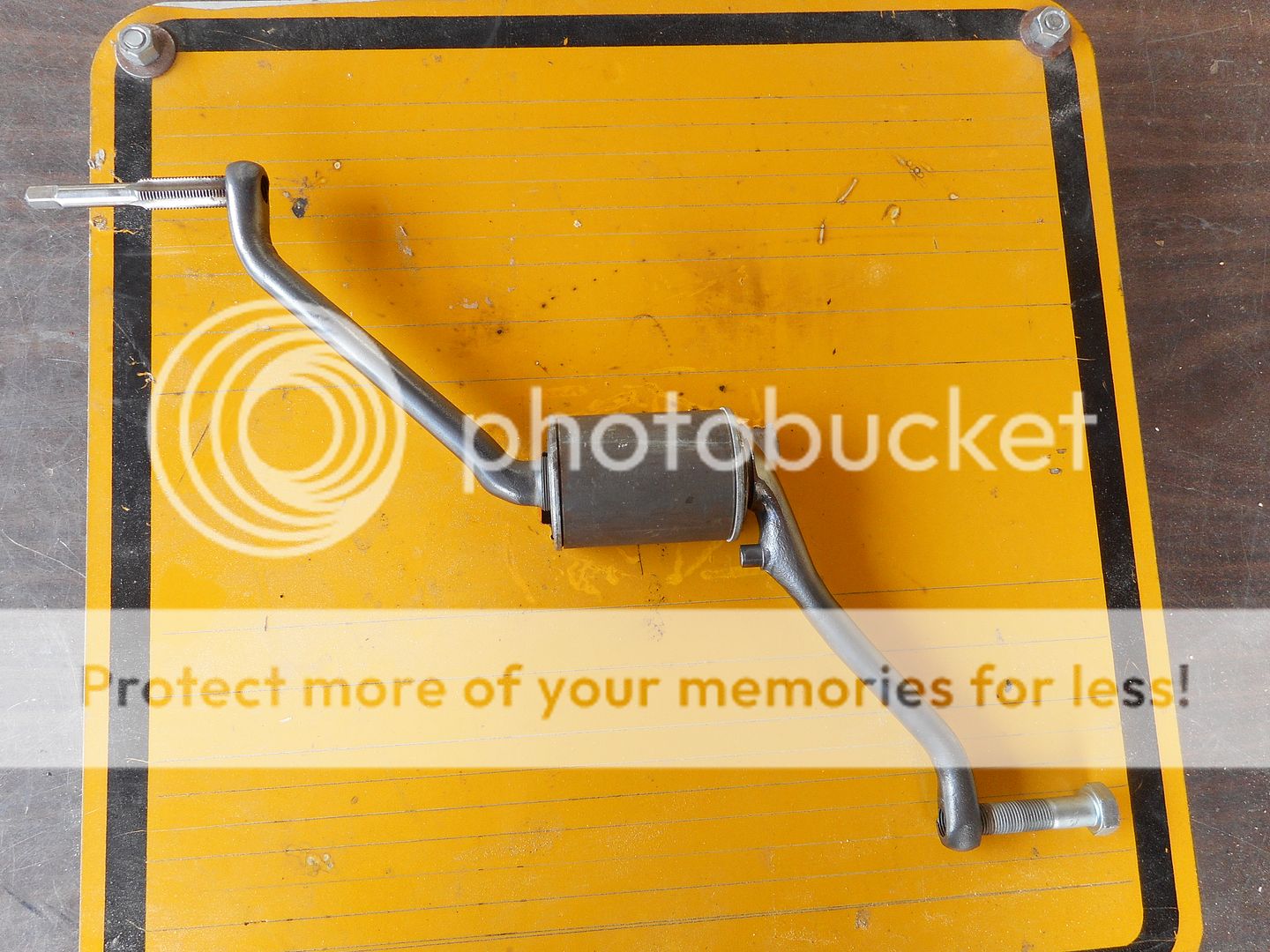

I got my acetylene filled today and finished bending my pedal cranks. Used my home made guide to make sure they're straight.
They came out real nice and felt great. Installed some cool narrow pedals.

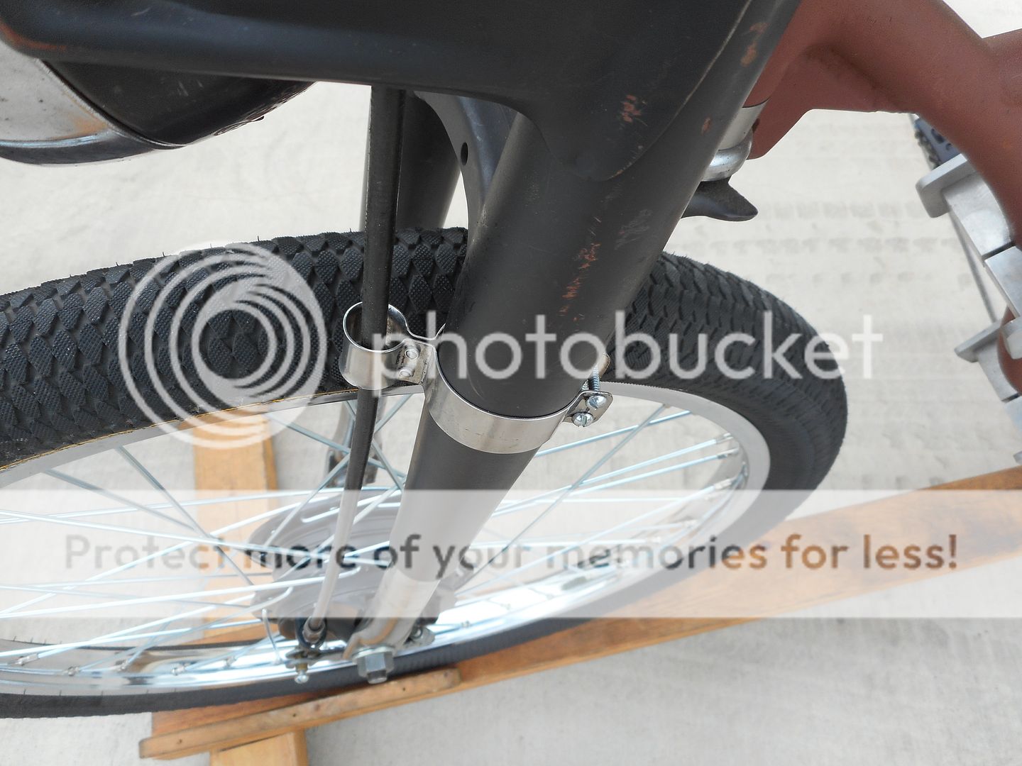

I made a little slipper guide for the front brake cable.

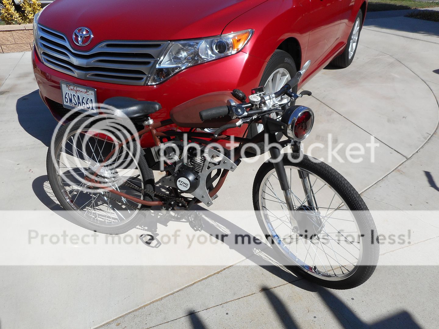

Then turned each clutch spring screw in two full turns and test road it. No more clutch chatter. It took off smooth and ran well. Falls off at around 8200 rpms or so. If it's still a little lean, maybe it needs some altitude to run best. Like Grange or similar elevation. Looks like I'm ready for Donut Derelicts anyway. Oops, I still need a rear brake cable and a primary guard. Always something to do.

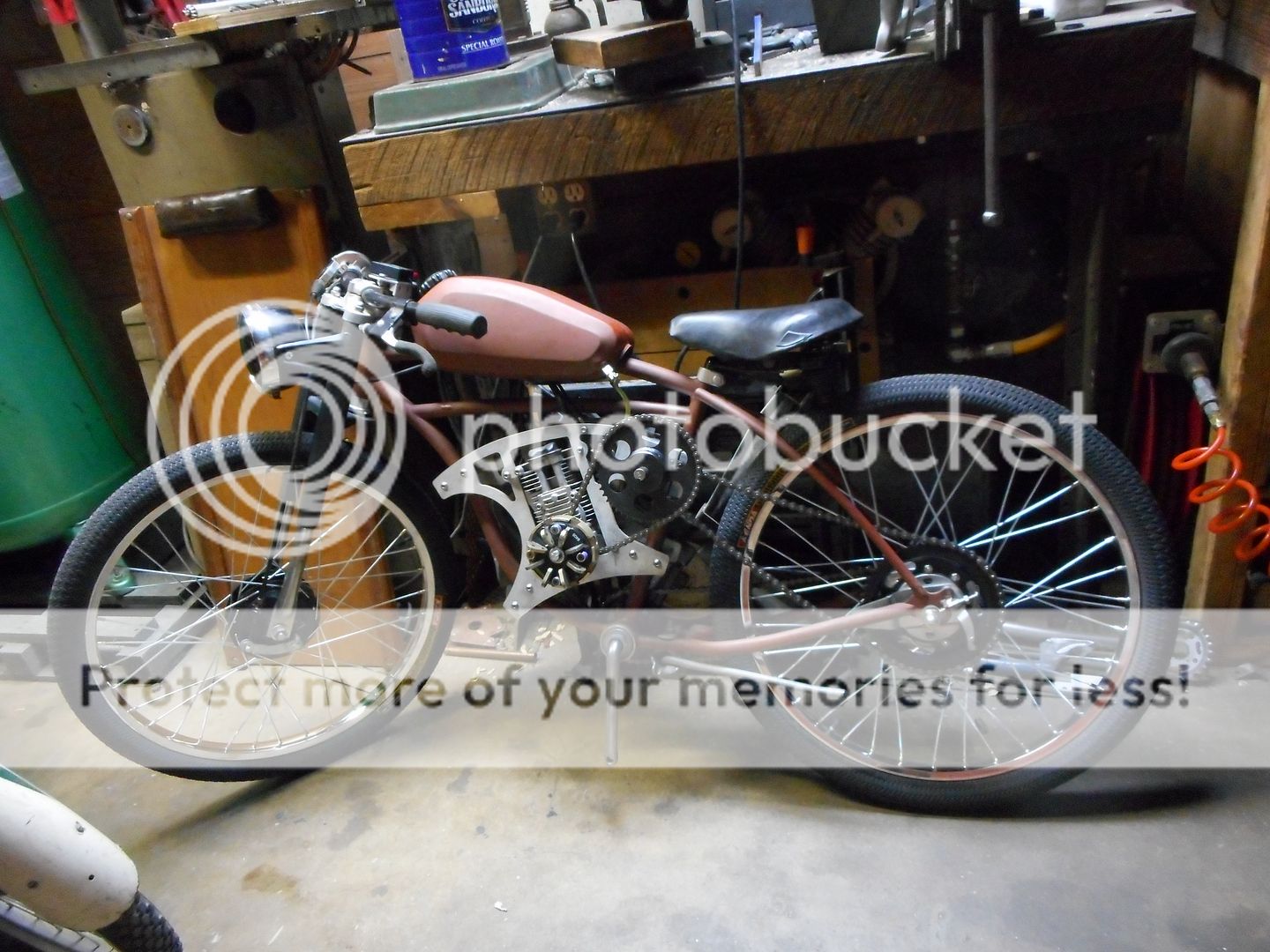

Still trying to get ready for the race. I made a guard for the primary drive and got some Hookworms. Still need to put the number plate on and check Wyatt out riding it. If I don't like his lap times, I may try it myself.
Nice work on the clutch guard... really cool looking and fits in with the rest of the bike nicely...
What kind of power does that engine make? Just out of curiosity...
Thanks Dave. The engine was originally rated at 3hp in a BR500 backpack blower at around 5400 rpms, where the BR600 with a different carb and module got 4hp and more rpms. By taking off the impeller, restrictive muffler and air filter, it gets over 8000 rpms and probably another hp. I had to install a carb that was about 1 1/2 times larger than stock to keep it from starving at high revs. The unique feature of this little motor is the dry sump. It uses mixed fuel like a 2 stroke but it's a push rod overhead valve 4 stroke. I've only got about 25 miles or so on the bike, so the real test will be the race at Grange this weekend. If Wyatt doesn't wreck it on the track, I'm going to tear it down and paint it up real nice. Might even check with Norm on an in frame tank he suggested. My machinist buddy, Dan, is making me a larger, heavier flywheel for the clutch side to make it more rideable on the street. I may put a brake band around the flywheel for a rear brake. It depends on how much room I have. In any case, as you know, these projects are rarely totally finished.
