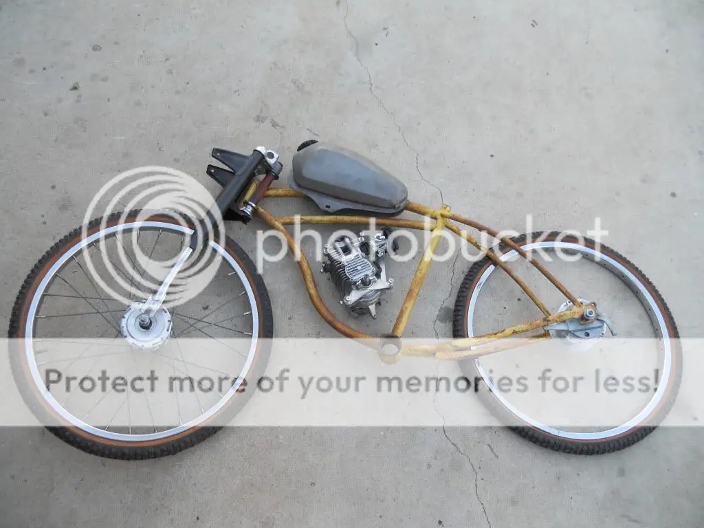

    Here's some of the stuff I may use for a race bike I'm building. Nothing special. Old cruiser frame and my usual moped parts along with a weed wacker type motor. Haven't totally thought it out yet but it will look similar to my other racer I ran at Willow Springs only the next size down. Trying to break into a smaller class. After seeing scotto racing all day in multiple classes, I should be able to do a couple.

    That's the first thought that came to mind until I got looking at it. The rear fender loop just behind the seat has been somehow ripped out and the tubes leading to the rear dropouts were all bent up. Also being a 24'' helped me decide it would be a good strong choice for my build. I had a 24'' mountain bike frame I was going to use, but it had totally no character. The main reason for going 24'' is because I have these really nice moped drum brake hubs that are 28 spoke. I found some fairly heavy rims and enough of the right size spokes to lace up one wheel. My machinist buddy is shortening the rest of the spokes needed to do the other wheel. They're 1/8'' with large nipples. I plan to clamp the motor in without welding on the frame, so it could be restored to original. It won't be tricked out like some of your bikes, just basic and simple. Thanks for the input. Always welcome.

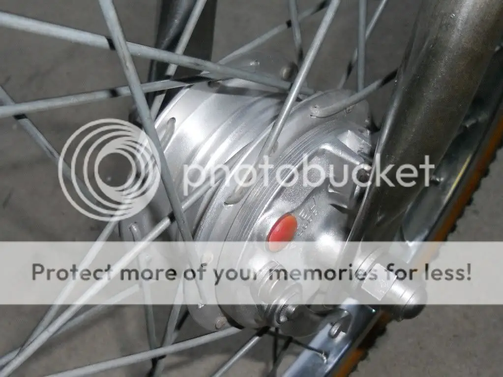

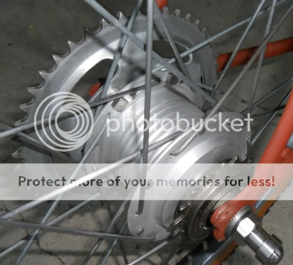

    I got it up on wheels today, thanks to my machinist buddy, Dan. He cut and threaded the spokes I needed for the rear.
    [​IMG]

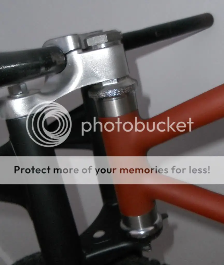

    He also made head tube extensions so the longer neck forkes will fit. Then he made me special nuts for the rear axle so I can put it on my stand to tune it before riding.

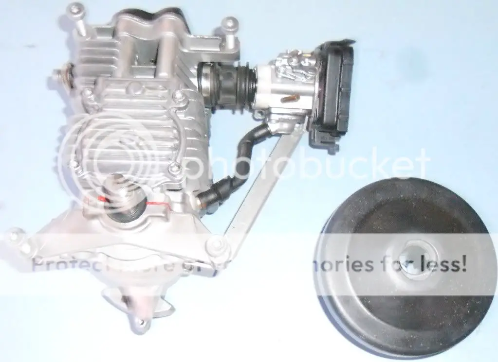

    Got my Comet 20 driver in today. It's almost as big as my motor.

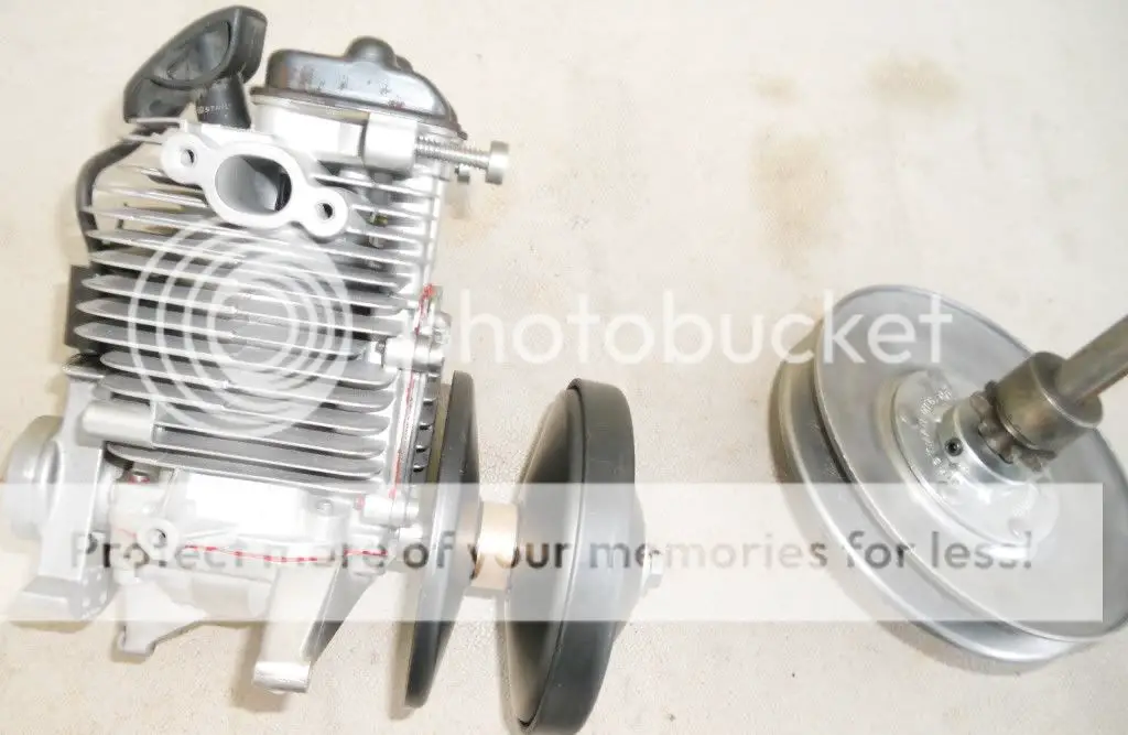

    Today I fitted my Comet to motor adapter to my crankshaft.
    [​IMG]
    It fit perfect.

    Installed the rear sprocket onto the rear brake hub.

    Then I found some stainless acorn nuts for the fork tops.
