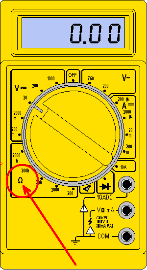

    It's measured in ohms, I suggest you read the instructions that should of been supplied with the meter.

    No instructions, A friend let me use it. But he didn't know how to use it.

    What is the symbol for ohms?
    The symbol for ohms is the Greek capital letter omega. Omega is the last letter in the Greek alphabet and resembles the letter O with the bottom of it opened up and turned outwards. Ron's thread below is what you are looking for.
    http://motorbicycling.com/showthread.php?t=35090
