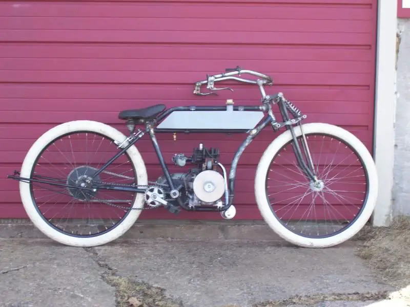

1913 BSA copy

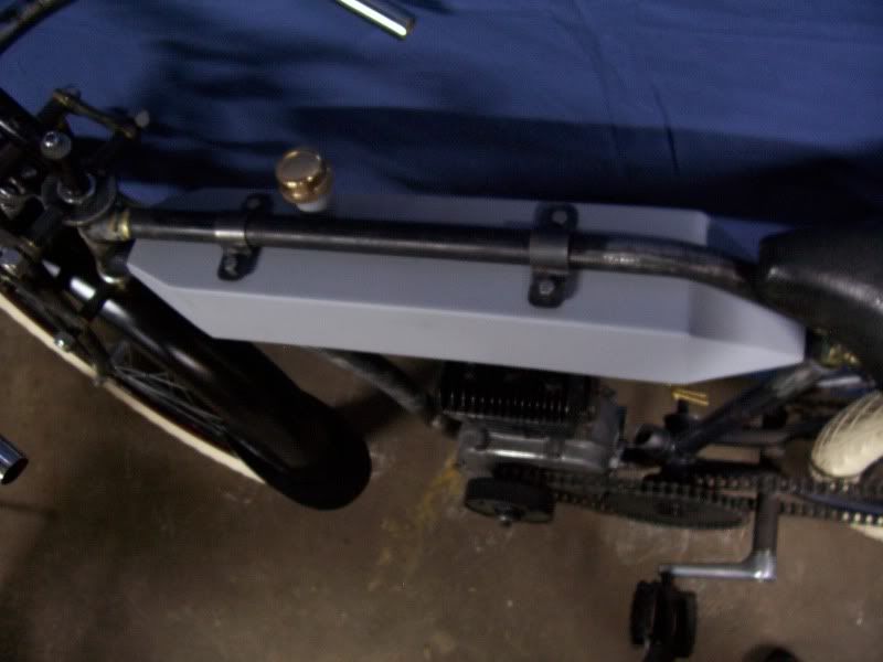

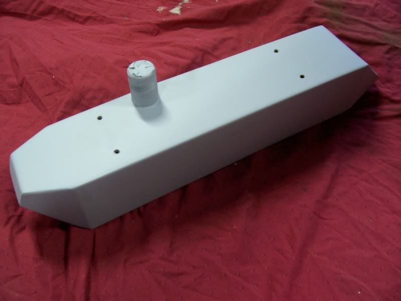

Ok, here's a few shots of the gas tank, all ready for paint. It's pretty sturdy..16ga steel. The mounting studs were machined out of mild steel, tapped to accept 1/4 x 20 scerws and brazed in place as was the petcock fitting. The cap is simply a re-worked brass pipe cap and the fill spout is half of a steel nipple. Used a Schrader valve in the petcock hole to pressurize the tank with air and checked for bubbles with soapy water...this process went on and on for over two and a half hours until there were no more bubbles visible, then I put a Kreem liner in it that I had left over from a job on a motorcycle fuel tank. After that, a little fill and primer to smooth things out. I think the next step will be to fabricate a cover for the primary sprocket and clutch. BTW, thanks for all the positive feedback...keeps me interested :)

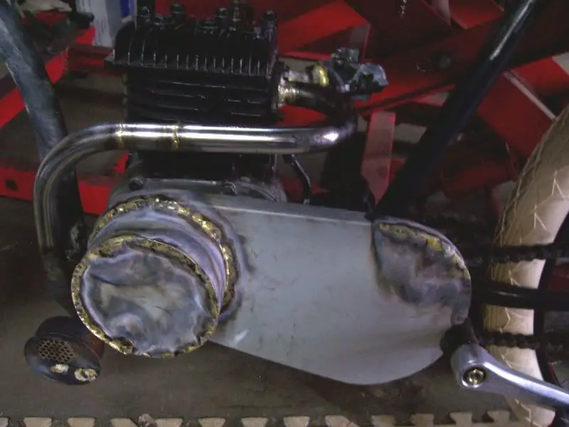

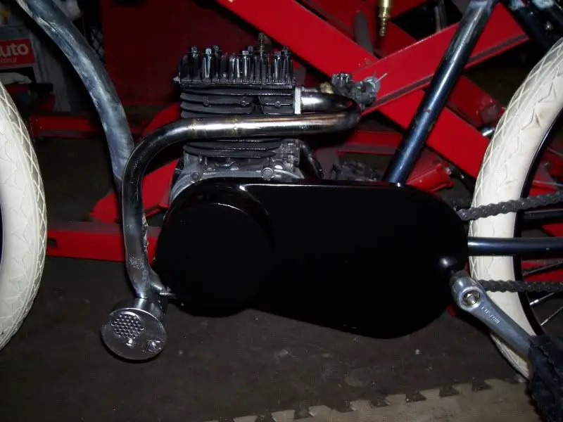

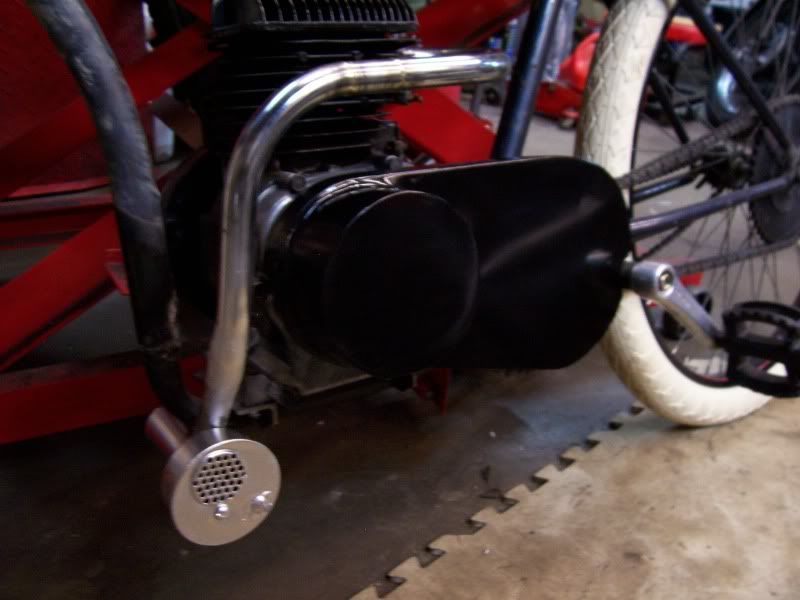

A little more progress...some before and after shots of the primary reduction cover made out of 20ga steel. Also fabricated an exhaust and intake manifold out of an old set of 10 speed handlebars and some spare odds and ends. The carburetor I'm going to use is also a scrap bin find...an old Tillotson off of heaven-knows-what. It cleaned up really well, although it's missing the choke, but that should be easy enough to make.
That is a beautiful bike. I wish I had that kind of fabrication skill. Why did you make the exhaust like that as opposed to a long pipe?

1. I made the exhaust like that instead of a nice swooping long pipe, because I was trying to make up something that sorta-kinda resembled the original 1913 pipe and muffler, not as pleasing to the eye, but a little closer to the look I was after (I guess).

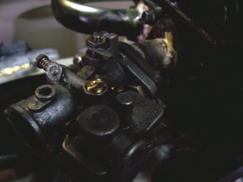

PS: Would anybody have any idea what this carburetor may have been off of?
Looks like possibly a Tillotson. There should be stamped ID on a machined boss of the float bowl to the right of the intake air horn. Something like ML3A, MT50B or so. If the venturi size is around 7/8", It could be off of a Whizzer or Cushman. The numbers you get off of it may provide the info. There's a few websites devoted to carbs. In any case most that size have interchangeable choke assemblies. I may even have an extra.
Oh yeah, it's a Tillotson for sure, in fact Tillotson is the only thing I can make out on it (easily), but thanks to your help I was able to find the remains of a number on the float bowl...turns out it's a MT25A...probably off an old 50's era garden tractor with a Continental engine. Now I have some idea of what it may have been off of. I think it ought to work...we'll have to wait and see.
