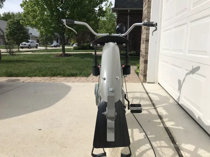

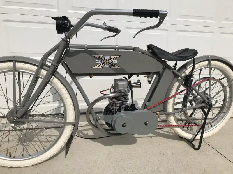

1912 Excelsior Tribute
Clean vintage, understated elegance. Well done! More fine tune details for my own builds is an ongoing process that I really enjoy.
Rick C.
A real beauty Moto, I am liking Taylar bikes. The tool box helps ensure a long wheelbase a real plus to my way of thinking. Fender struts are super strong.
Did some hard looking at your tires. Interesting tread pattern. Looked at Coker, didn't see them.
Thanks for the photos.
