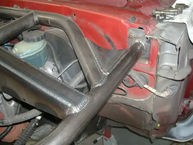

this welding is MIG not tig/heliarc the guy that done it is called ZTfab can be found on
http://weldingweb.com/showthread.php?t=30845
the black Bike is a 1996 Diamondback outlook tig welded steel frame
the other.. aluminum frame Next -Avalon
Can't judge a book by its cover when the guy holding the Miggun really knows what he is doing
A great weld is a great weld no matter the method used and a poor weld is just one that needed to be ground out and redone.

Maybe you should go back and read my post. I said, "the photos the OP provided".
What does that have to do with the one you put up? The bicycle frame shown in the OP's (Original Poster's) pictures were the ones I was referring to.
As far as the "the guy holding the mig gun" I'll venture to say that since I started welding, back in the late 60s, I have enough experience to perform as well as critique a weld. Be it steel or aluminum.
