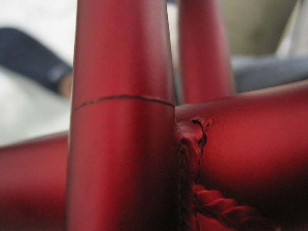

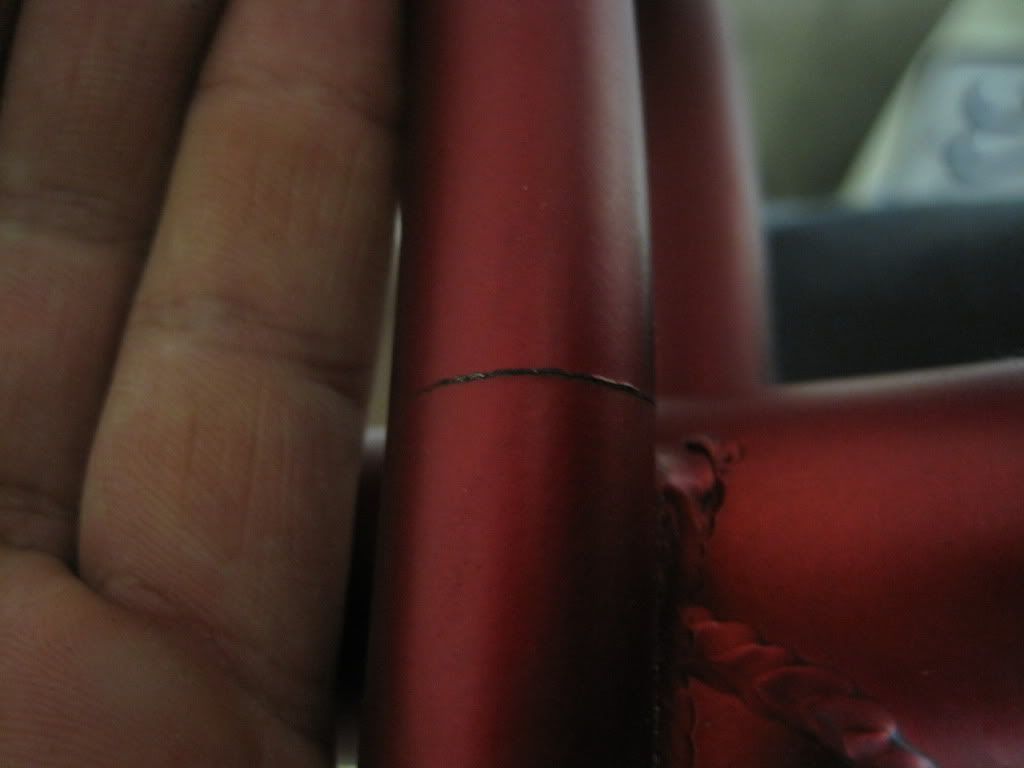

    I believe this is a crack but i want your opinions... how do i go about getting this repaired? Is the bike still rideable?

    That be a couple of cracks! :(
    Just out of curiosity... what kind of frame is it?

    I don't think I'd even bother trying to repair that massive failure.....but hey, it's not mine to worry about. That's some bad crack(s) right there. Good luck.
    It's def not ridable in that condition, that's asking to get hurt!

    Looks more like a highly brittle steel frame......sorry to see this.

    It's not the first time that Firmstrong frames have cracked.
    Firmstrong and Micargi are junk.
    Not worth repairing unless you can do the welding yourself.
    Did it have a motor on the frame? How about a little history?

    just my way of thinking but this frame is scrap metal
    it would be unsafe to ride it the only way to fix is take all the still good parts off and put them on another frame

    Thanks John........I was just trying to let him down easy......scrap metal at best.
    Sad but true, not worth fixing honestly :(

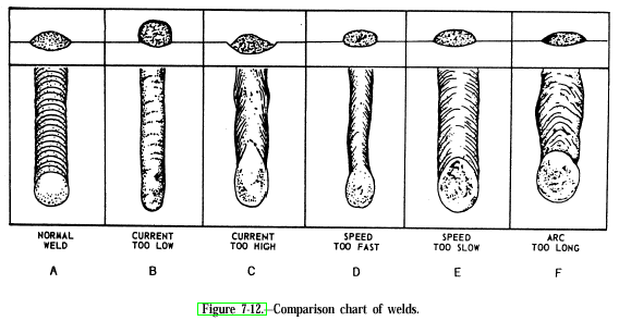

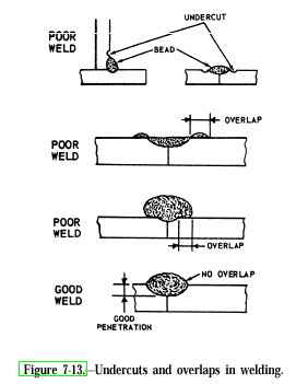

    When recommending for or against any of the inexpensive bicycles it's misleading to state all of "X brand is just fine and do not break" or even "aluminum is bad/steel good" as it's unfortunately far more complex than just brand name, price or even material as the quality control is highly variable.
    Even higher cost bikes suffer some variance in weld quality, the difference being someone most likely inspected them before letting them out of the factory - with the cheap bikes, you'll have to do this yourself.
    Judging from this;
    [​IMG]
    I think the pics are turned 90°? ...but, I'd hafta say it looks like the welds were not only hurried (wide lap spacing) but also varying in types of problems. While the seatpost to top tube weld held - it's obv too fast w/too low a current, whereas the weld that failed (stay to seatpost) was too slow/current too high & thus undercut - which leaves a space/void where there's less material & that's where it most likely initially cracked, the clean break in the stay probably came after as a result of the added stress loads.
    It's easy enough to inspect welds if you know what you're looking for - remember they're far more important than brand favoritism, material bias or shopping by price tag alone as they tell you clearly how well that particular frame was built;

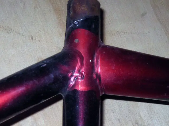

    [​IMG] [​IMG]
    Common low quality welding, steel & a 'NEXT' brand mountain bike;

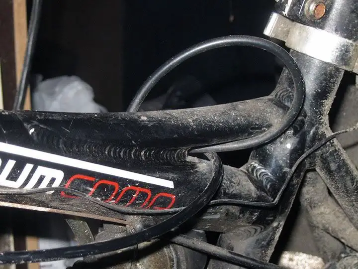

    [​IMG]
    Beautiful welds, aluminum & a 'Schwinn' brand mountain bike;
