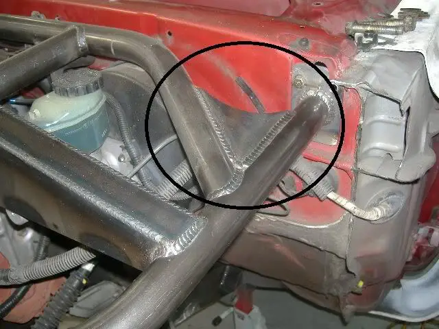

    I was posting about repairing a car or truck frame . The bike frame is a whole other thing . The welds a under cut very bad . The frame was just slapped together as fast as possible . You might get it repaired by rewelding it but I would reinforce it with some gussets just to make sure . These thing are not designed for a motor . Dan
  16. Mr. Minecraft
    Mr. Minecraft Visionary
    Joined:
    Jan 13, 2012
    Messages:
    349
    Likes Received:
    If you are talking about these then yes, we are having one welded on either side
    [​IMG]
  17. Saddletramp1200
    Saddletramp1200 Custom MB Buiilder
    Joined:
    May 7, 2008
    Messages:
    1,420
    Likes Received:
    That is an E.R. visit you can avoid! For the $$$ I like Schwinn. My Point Beach, OCC Stingrays, & Del Mar Models have held up well. Don't ride that frame. (c)
