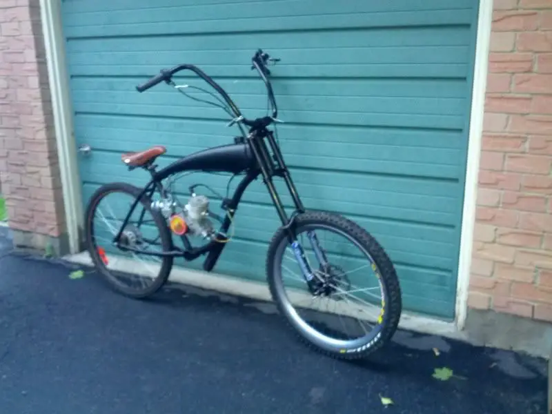

Check it out just completed my 1st Grubee GT2-A frame build and have already ordered another frame the same too start on a "old school" cruiser version with a springer front end , ape bars , etc. I had a nice old school bike motorized and sold it lasty week and am missing it so gotta replace the void ... but hey .. isn't that why we do this ? for the build ?? I know I get as much enjoyment from the building as I do from the ride !! (well almost ...)
Thanks for looking and let me know what you think.
