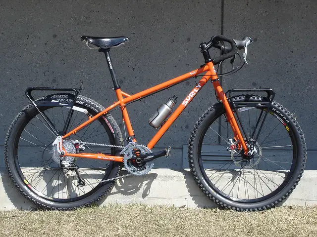

I found a forum for guys that do long-distance touring on bicycles--crossing China or Africa with all their gear on-board. A lot of them use a steel bike called the Surly Troll.
I'm going to use their front fork and luggage rack and whatever brakes/wheels/tires those guys use. I want to load this bike down with baskets, gear it for a top speed of about 20, and use it for my grocery runs. I figure aping whatever those guys have found works is probably the best way to go.
Good to know about the clamps. I might end up fabbing my own engine plate and getting some clamps from you for it if the angles don't work out right on this A frame.

Look into the surly crosscheck or long haul trucker bikes. Steel, some come with discs and they have room for an engine
