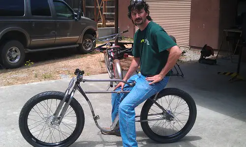

I have been getting a few emails from people asking why I have been so quiet lately. Well, I have been quietly working away on a super duty Sportsman 200 with some major upgrades. I will eventually start a build thread, but here are a couple quick shots till then. Frame is built from 1" .120" wall DOM on the front triangle and 3/4" .120 wall DOM on the rear triangle with 1/4 plate dropouts. Lugged and brazed like the good old days. I have increased my 200 model wheelbase by a couple inches for high speed stability and will be running H speed rated Pirelli 80/90-21 motorcycle tires on custom drilled motorcycle rims. Here it is sitting on the ground for the first time.
Bonneville Flyer by Sportsman Flyer, on Flickr

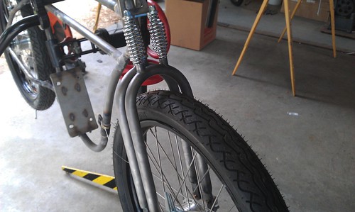

Front forks are also fully hand built, and use 1" .120" wall DOM tube with 1/4" laser cut dropouts and 3/8" plate swing arms with bronze bushings. Needed some serious width to run the motorcycle rubber so these are 5" wide. I built them to be similar in design to other forks I have run, as they work well and I am familiar with setting them up. Engine will be a mean and nasty GX200 with every upgrade imaginable. Goal is 22hp and over 70 mph. That's all for now.........
